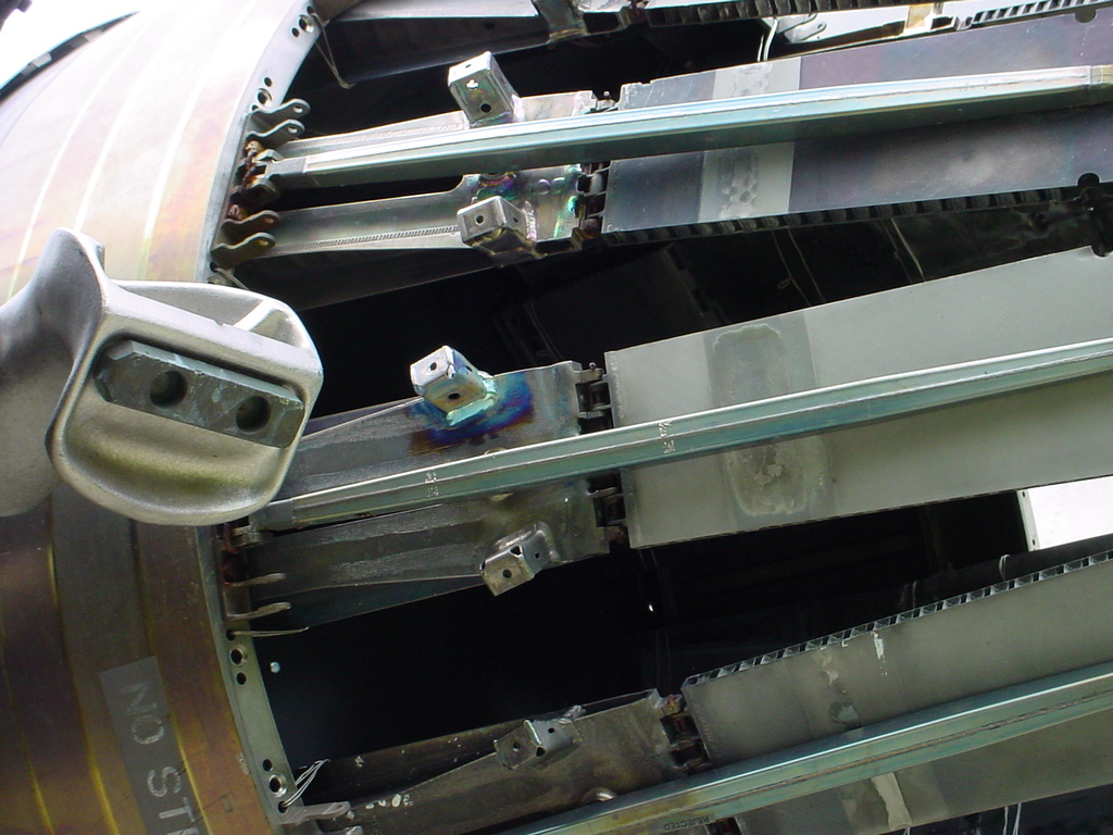

Best advice I can give is to search the net for photos of the engine you are doing and then try to match the photos. They are all different yet in many ways similar.
Heat does some strange things to the engine colors. Here is a photo I took last year of the right side exhaust on an F-15A . Note how the heat generated has given the parts all kinds of different colors.
You would be right in leaving the engine a bit grimmy. Depending on the engine there is always a bit of oil combined with carbon and general grime. Jet engines really dont like the oil to be overserviced, and most will blow oil everywhere when they are. Especially some Pratt -Whitney engines (PW120 on the ATR-42/72 ESPECIALLY) which leak oil like a sieve.
