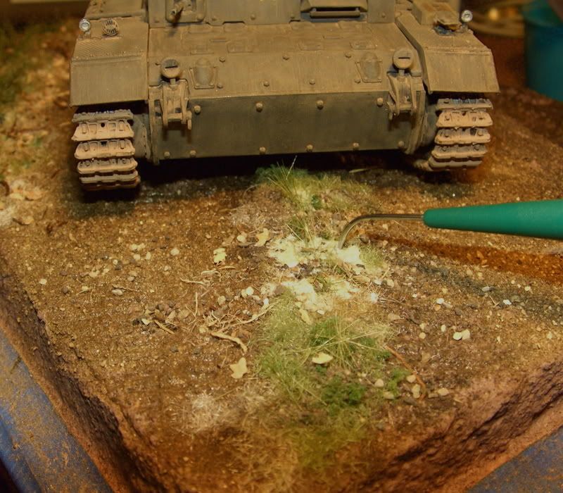

For areas other than a golf gourse, I plant a tweezer’s worth of grass into wet (w/ glue) real dirt and sand then, using a dental pick, I shape the grass; when dry, I airbrush scenic glue across the lot. When that’s dry, I airbrush shades of green, then lightly drybrush shades of yellow:
Again, this won’t look like a well-groomed golf course.
