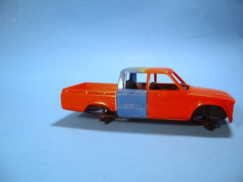

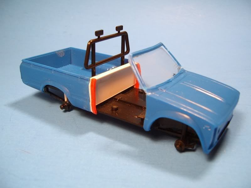

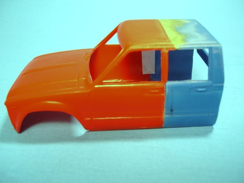

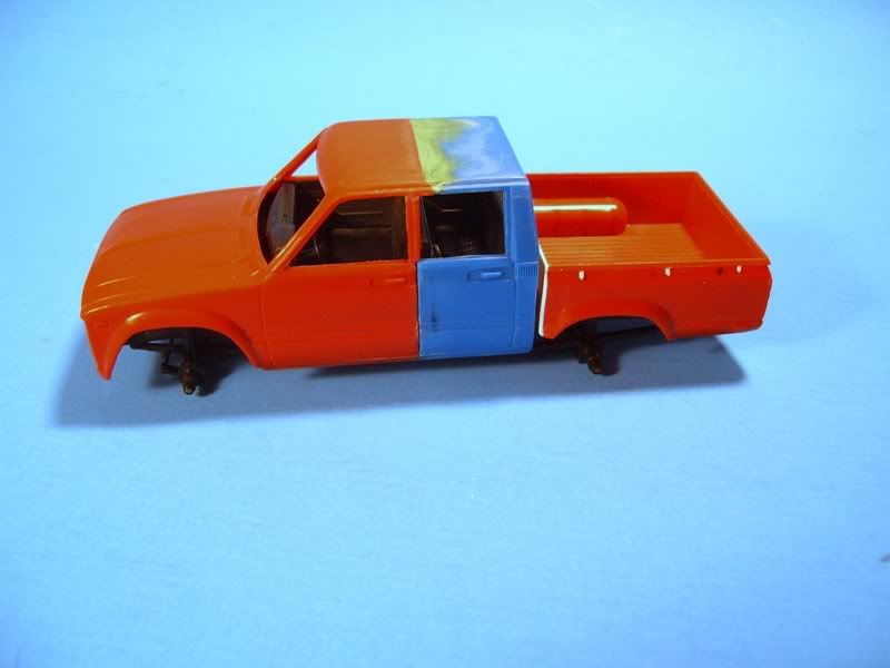

I cut one kit (blue) apart at the windshield and along the front of the doors. The second kit (red) I cut along the rear of the doors and the back of the roof line. I then cut the blue doors to the size I wanted and mated the two sections to form the crew cab. The roof needed quite a bit of putty to get them to mate smoothly.

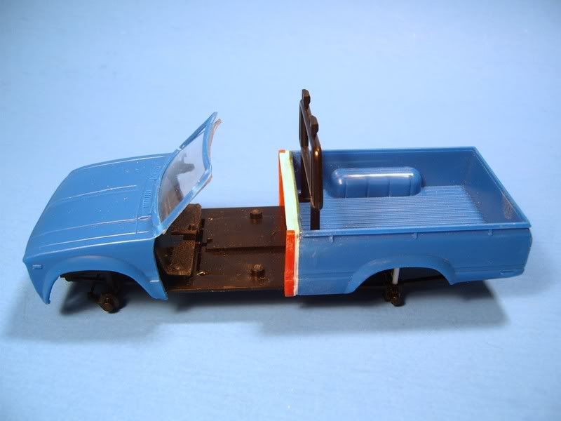

Next was on to the bed. The HiLux has a shorter bed then a standard truck. I studied pictures of it and determined that the cut is slightly in front of the fuel filler cap on the right side. I proceeded to close the front portion of the bed off and made the front wall out of sheet styrene. I also repositioned the tie-down loops on both sides.

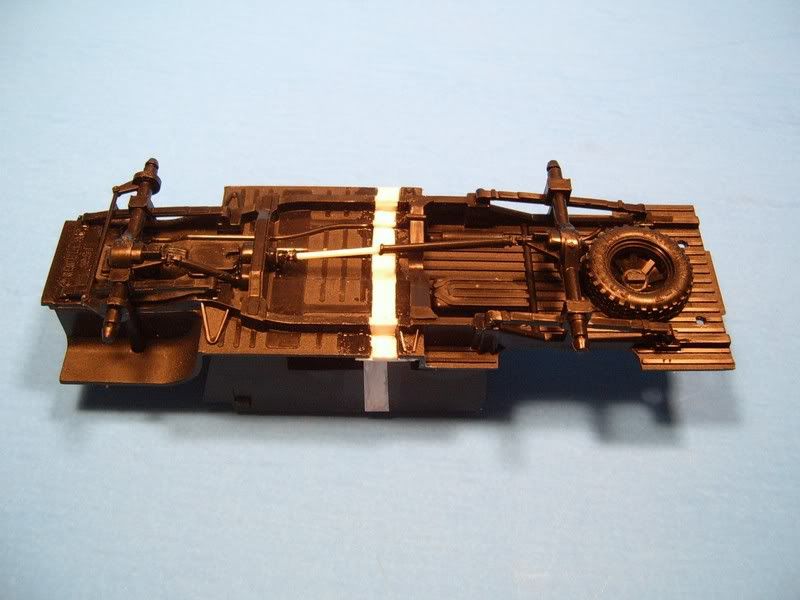

Next was lengthening the frame by 5mm for the longer wheelbase of the crew cab. I cut it just forward of the main cross support in the center. I rebuilt the floor and frame members using sheet styrene and rod for the exhaust pipe. I also had to lengthen the rear drive shaft to fit as well.

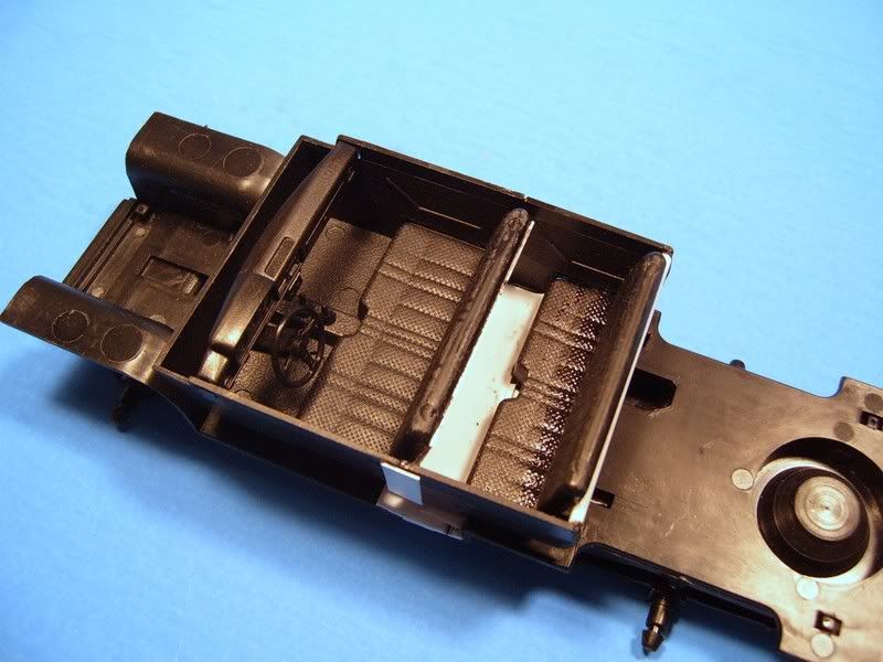

For the interior, I used the forward tub from one truck and the seat and side walls from the other to make the rear area. These were mated together and sheet styrene added to form the rear floor. I will further detail the interior as I continue with it.
This is the final result so far. I think it looks pretty good. The price was right as well. I still haven’t decided on the wheels and tires for it. The kit ones look pretty good. I also have an old set of Land Rover wheels/tires I may use on it.

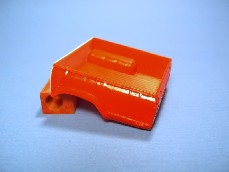

And the left over parts from the donor truck…
They are pieced back together and will be used for a Somali Technical with the front doors and roof removed. I will need to rebuild the interior on it as well, but that is another project
