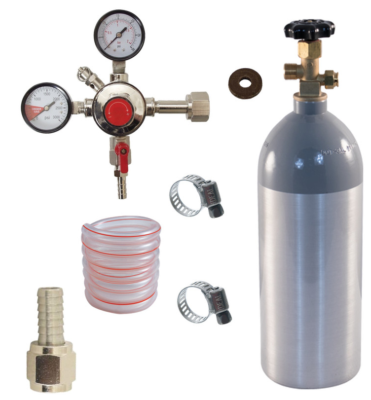

I’ve seen others make this comment before, and I’ll make it again: Once you’ve gone to a CO2 setup you’ll never go back to compressors. CO2 = No noise, no possibility of moisture, nothing to break. It just takes getting a tank and a regulator, like what is shown in this snapshot.

Agree with @RobH, but besides the initial costs, another factor to consider:
CO2 tanks must undergo hydrostatic testing every five years to ensure safety and compliance with DOT regulations.
The cost of CO2 tank testing typically includes:
  • Hydrotesting : Generally costs around $30 to $70 depending on the location and tank size.
  • Recertification : Costs range from $20 to $160 depending on the tank size and testing facility.
  • Exchange Program : For tanks that have been tested within the last 4.5 years, the exchange fee is about $42.25 .
It’s advisable to check local providers for specific pricing and services offered.
@veedubb67 Yes, that is the DOT regulation. And this will come into play whenever your tank runs out and you want to get it filled or exchanged.
Here is my personal experience: When I bought my CO2 setup I really wasn’t sure how big a tank to get or how long it would take to use up. I do airbrushing sessions at least every other week. So being the overkill kind of guy I am, I purchased a standard 125 cu ft welding cylinder (about 4ft high and 10" in diameter… like the kind you would see in any garage welding rig). It was like a $100 difference in price to the smaller cylinders. That was 15 YEARS ago! My tank has never run out, and at this point I’m starting to wonder if I’ll have to give up modelling due to old age before it ever does :face_with_crossed_out_eyes:

I’ll second the CO2 suggestion. I’ve been using CO2 for over 30 years and it’s awesome - with my tiny 10lb tank :stuck_out_tongue_winking_eye: If you do a tank exchange you can avoid and pressure testing costs. Since moving to AZ I found a welding shop that will refill my tank for $10. Been here 3 years and refilled once. Silent and dry - nothing better!
Keavdog, what was your initial outlay for the bottle, regulator, hose, etc.?
Asking for a friend…
I think I spent around $100.00 for the tank and regulator but that was a long time ago. Probably twice that now - but check local welding shops. Might find an old not so pretty tank for a deal. I put on a quick disconnect so I can swap out airbrushes. Hoses are the standard hoses that come with the airbrush
Seriously? 15 years of semi regular use. Not one tank refil? Thats crazy. Now I will look into it. Theres a supplies store and refill center less than 2 miles from my house… I dont really have an issue with noise, so when or if my current compressor goes kaputz.. this could be a good option.

After burning out a couple hobby compressors and getting tired of the noise from the 20 gallon compressor in the garage I swtched to a 10lb CO2 tank 25 years ago. Originally with my own tank and I went through hydrostatic testing it and getting it refilled. I still have it as my backup, but haven’t refilled it in at least 10 years.
Eventually I switched to the tank exchange system the gas dealer a mile from my house uses instead of driving over an hour for a refill. $35 to swap my empty tank for a full one about once a year. Technically I’m renting the tank and there was a setup fee/deposit to get started (don’t remember how much). A CO2 regulator suitable for airbrushing runs about $50 on Amazon.
