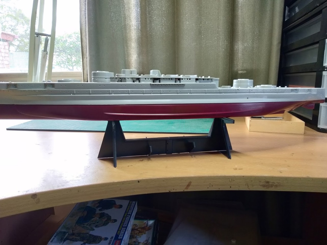

I’ve dry fitted the hull together , the red antifouling doesn’t look too bad . but I think I will still paint it .

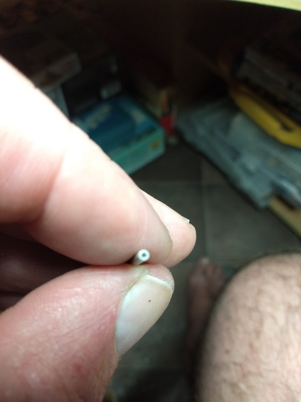

drilled out the barrels with a .7mm bit , the holes actually look bigger in real life .

Steve, you really do want to paint the bottom.
