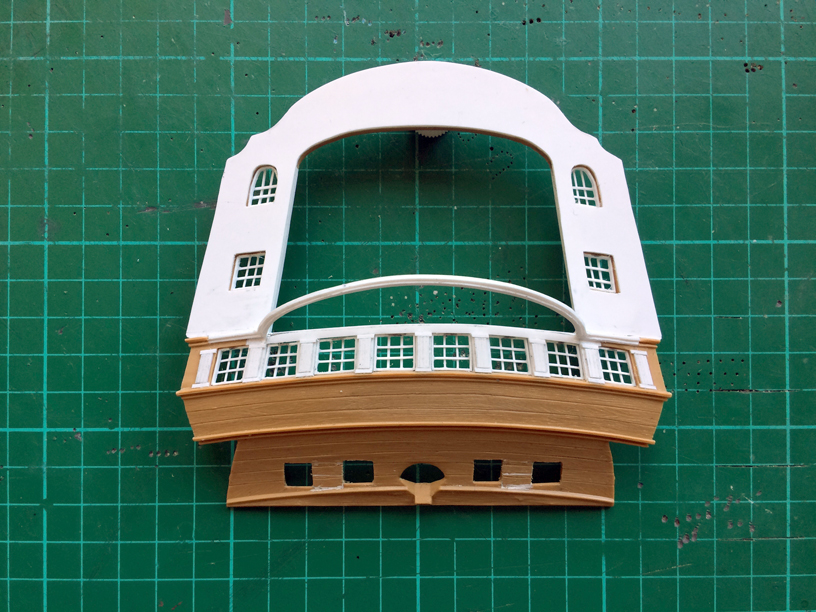

Update: I’ve created and installed the windows for the stern, added the pilasters in between the wardroom windows (although you can’t see the detail in the pic) and cut the initial holes for the four stern chasers. It took me three attempts to get the glazing bars right as I wasn’t satisfied with thickness of the bars. I researched several methods for making windows including painting on the glass, 3D printing and buying etched parts, but I wanted to make them myself. In the end I managed to cut 0.25mm strips off the edge of some 0.5mm styrene which as you can imagine coiled up. I was able to straighten out the sections I needed and attached them to the frames. I’ve lowered the outside stern chaser ports a couple of mm lower than the inner ports, as the curve of the stern made the straight line look a bit odd. I’m quite happy with how it’s going so far. All looking a bit grubby at the moment though. Onto the carvings next I think…

Looking great!
very nice work flint ,

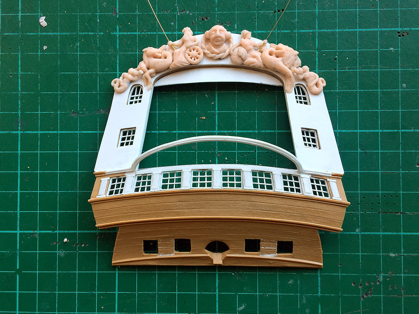

I’ve started work on the tafferel carvings this week. I only get about 1-2 hours a day to do this, so it’ll be a long process. More refinement to do on these, or even remake them if they don’t fit properly. Much filing, cutting and biting to do! I’ve just placed these on with Bluetac at the moment, but need to make the coves first to see what room I have to play with and see how I can layer-up the carvings. Also, His Majesty King George the third needs a proper wreath!
Like the fetching pink Fimo? It’s all I had…

That looks great Flint!. That will be the ultimate crowning moment when they are completed.

look’s brilliant flint , you and michael [cnsod], not only great modeler’s , but can carve too , time for me to quit I think [:D]

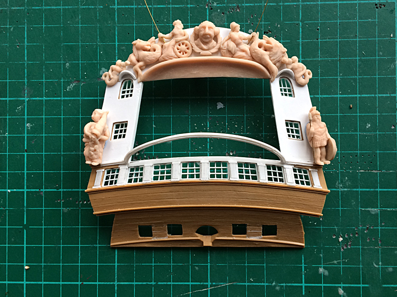

Minor(ish) update.
I’ve been crazy busy the last couple of weeks, so haven’t had much time for modelling, but this is what I have managed to do.
I’ve made and installed the two coves above the outer windows made with styrene and temporarily placed the central cove made from Fimo. The central cove was quite a challenge to get right as it is made up of several complex curves. I wanted to make it perfectly balanced as I knew this would show up if I didn’t get it right and it would bother me forever. I had apprx 7 attempts at trying to make positive/negative molds out of styrene, tin foil, wood, etc. But in the end I had to just make a wedge that would fit in the stern cutout and then go about carving the inner curves using a spherical sanding bit in my Dremel. This method was the last thing I wanted to do, but actually, it turned out just fine…phew! Also, I’ve made the quarterpeice carvings of the voluptuos Abundance and the God of War himself, Mars. Both are just stuck on with BlueTac at the moment, but both will have recesses cut into their backs, so that they fit around the outer edge of the stern when the time comes. Also, His Majesty King George III now has his wreath.
Sorry the pic is a bit over-exposed.

Absolutely superb work Flint. This is so cool that you, Steve5 and MichaelD are all working on the same time frame of the Victory. All of them are awe inspiring.
