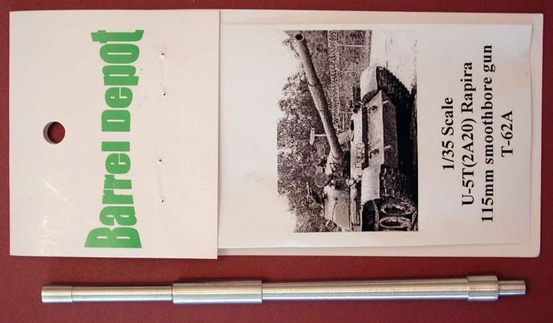

I’ve received a Tamiya T-62 for detailing it an correcting some inaccuracies (like the turret)… And a Barrel Depot 2A20 barrel was also given to me. Well look at this picture:
As you can see, the turned aluminium barrel is just the same lenght as the plastic one WITHOUT the muzzle, moulded as an apart piece, and with a diameter slightly more than the barrel’s diameter… So I’m suposed to use the plastic muzzle, right?.. Well, now kook at this picture:
This is the “same” cannon: same brand, same code, but as you can see, the muzzle is part of the cannon, So here is the question: What happened to the cannon that was given to me?.. Is the aluminium muzzle a piece apart and it got lost?.. Is my cannon a total failure?.. What I’m suposed to do now?.. Maybe I must use the plastic muzzle, as I’ve mentioned before… Thanks a lot in advance. Best regards.

It was an earlier version where you had to use the plastic part. Newer versions have it milled in. They upgrade their barrels every so often.
If you are unhappy with that barrel and want an alternative, look for the Modelpoint T-62 barrel. Everything is molded in one piece of aluminum and it looks great on a finished model. BTW, which version of the T-62 are you building?
