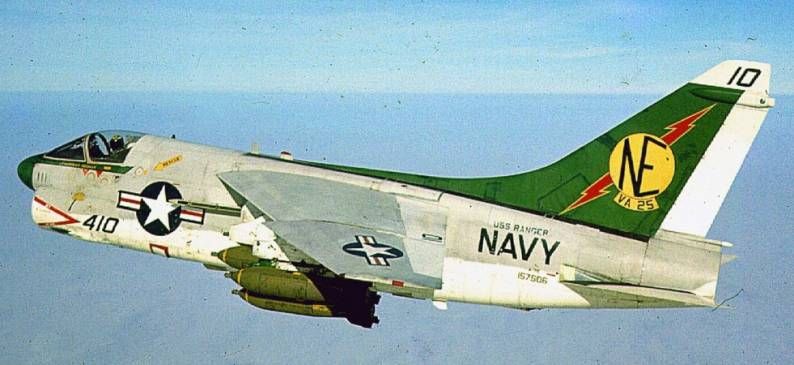

That type of CBU are Vietnam era ordnance.
I have yet to come across a photo of an A-10 ever carrying them. For CBUs, A-10s usually carry later models such as the Rockeye or other types. The ECM pod is an ALQ-131 type.
Nice pic and info. I need to build an A-7 at some point so maybe they’ll get used for that!
