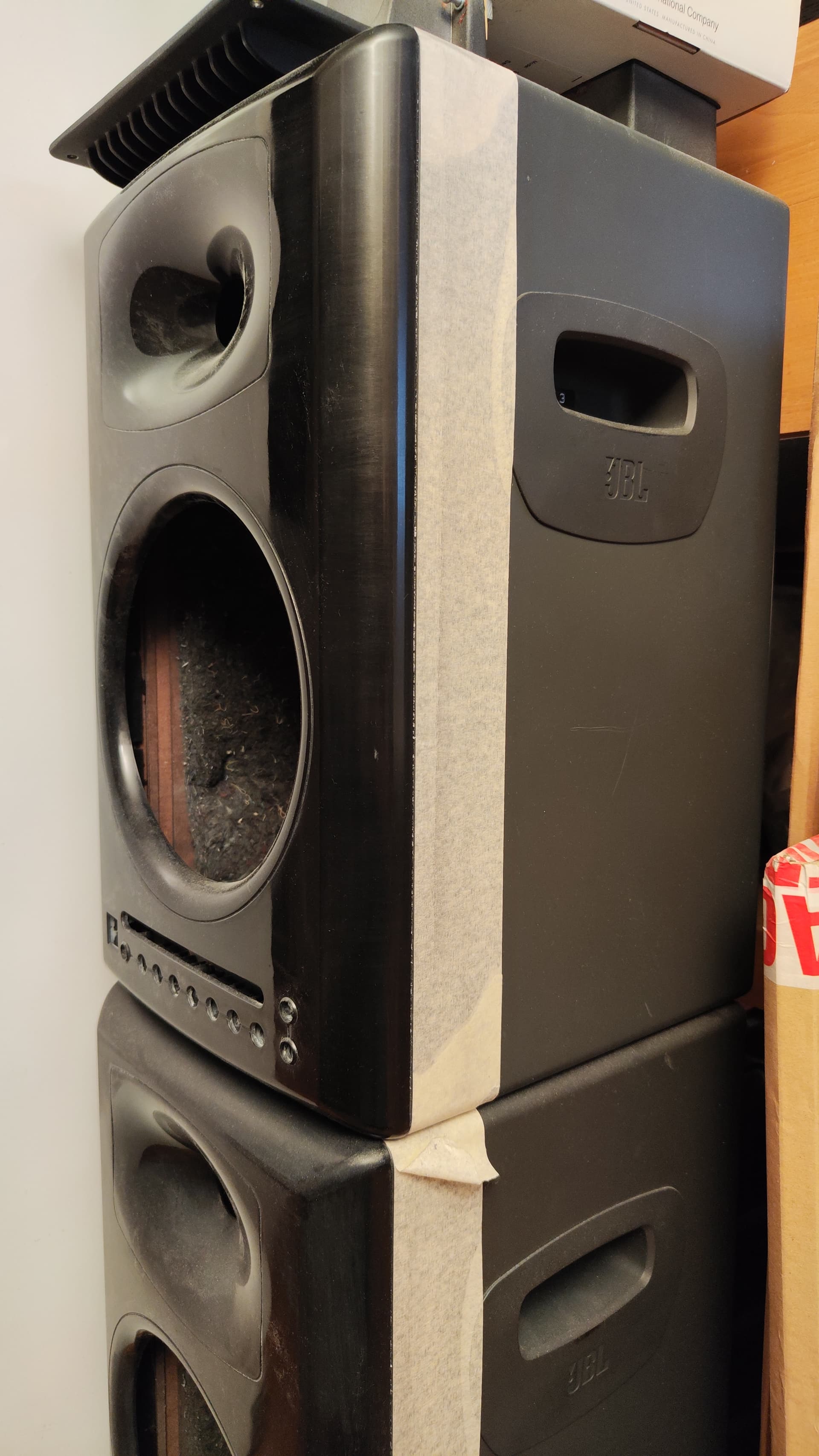

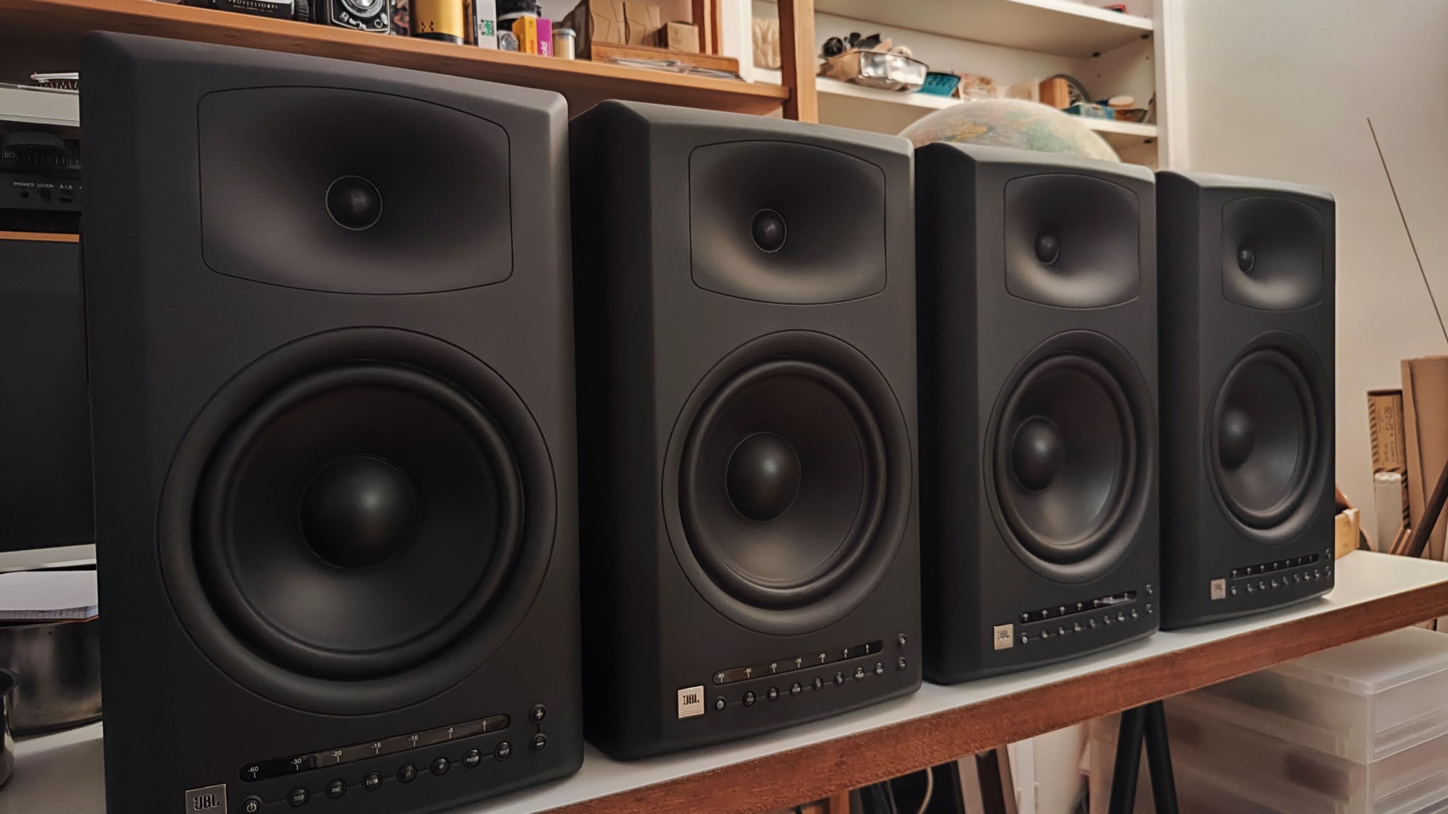

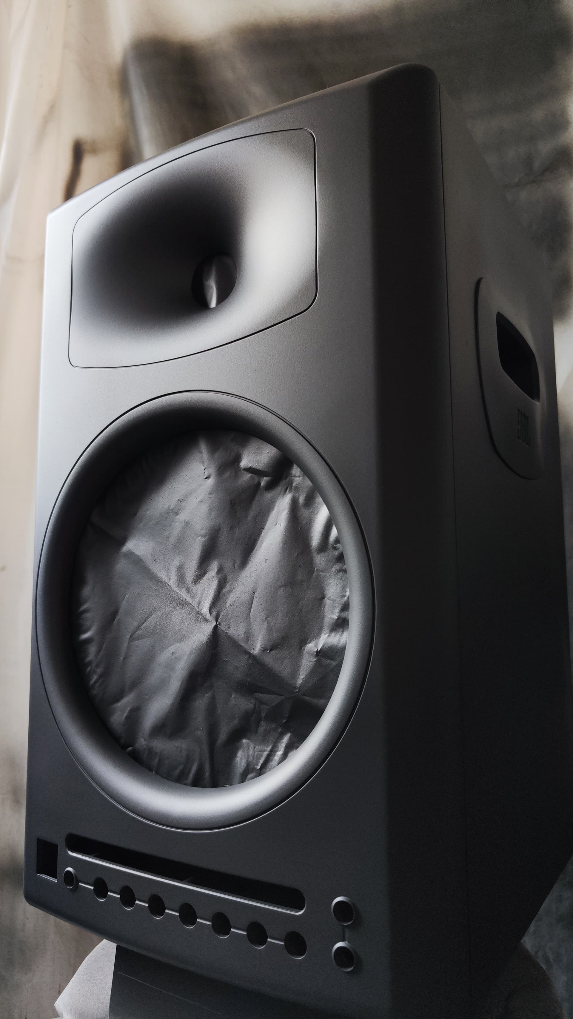

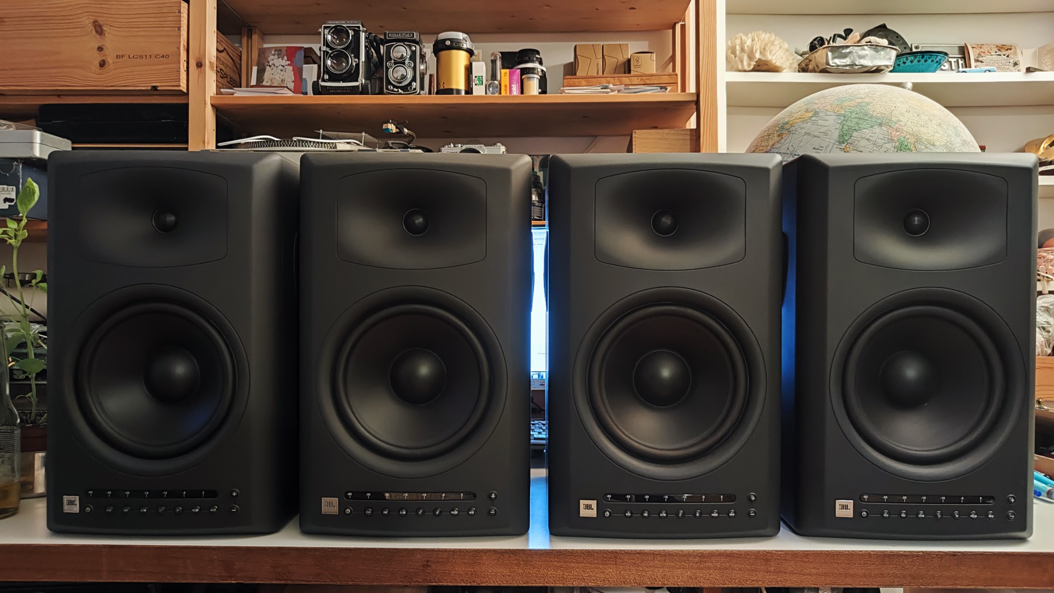

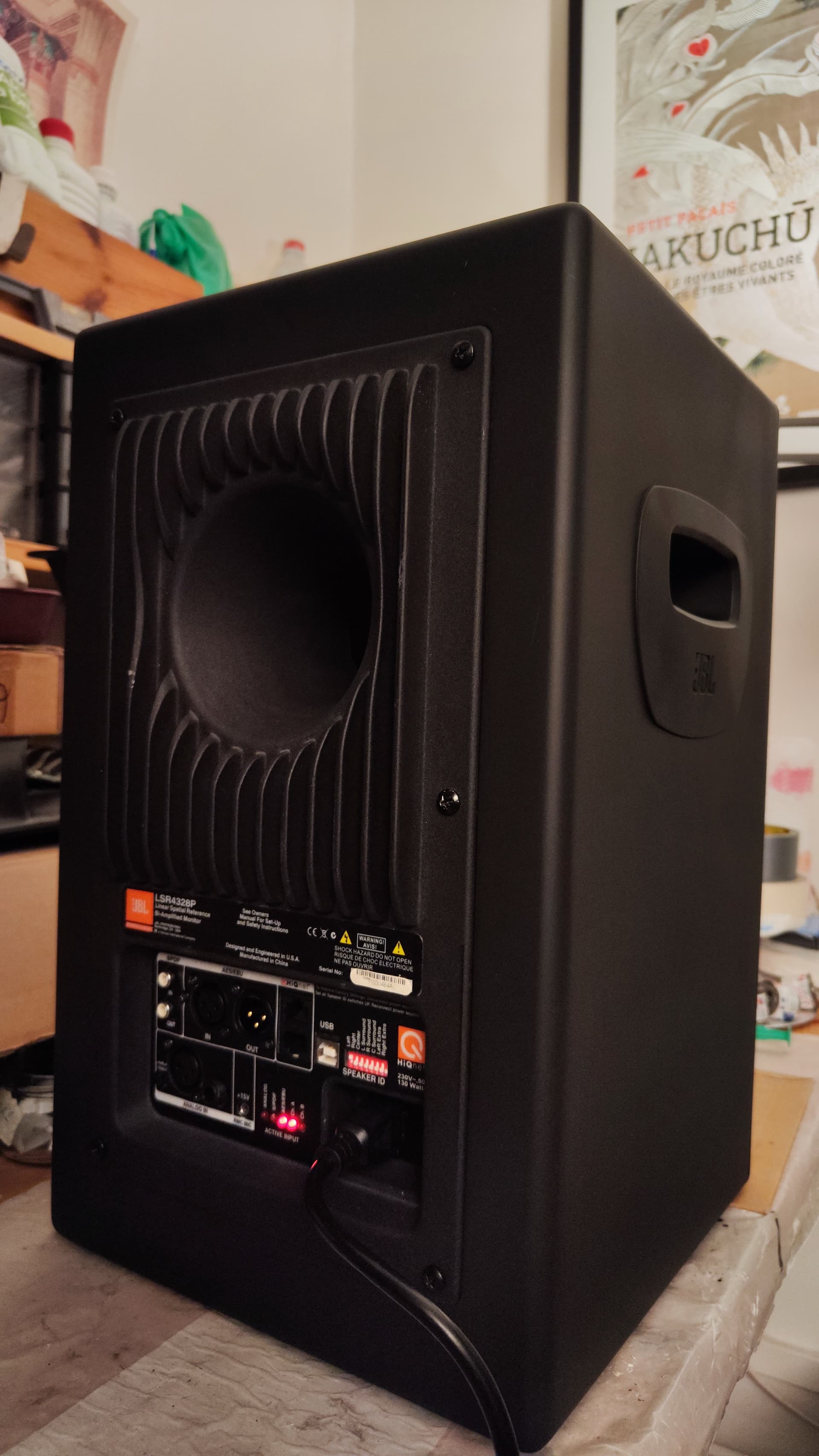

Hello everyone, and merry christmas !

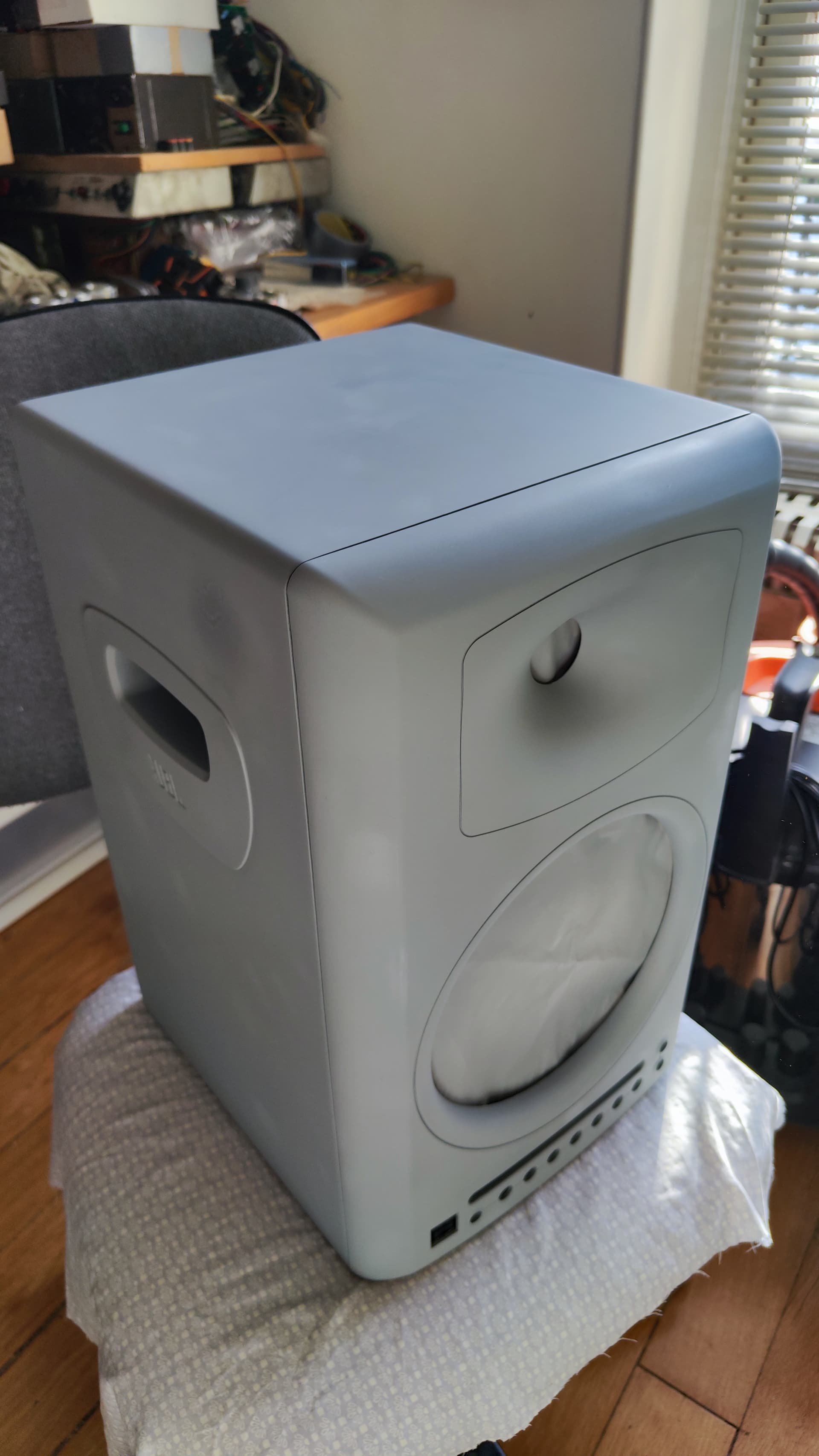

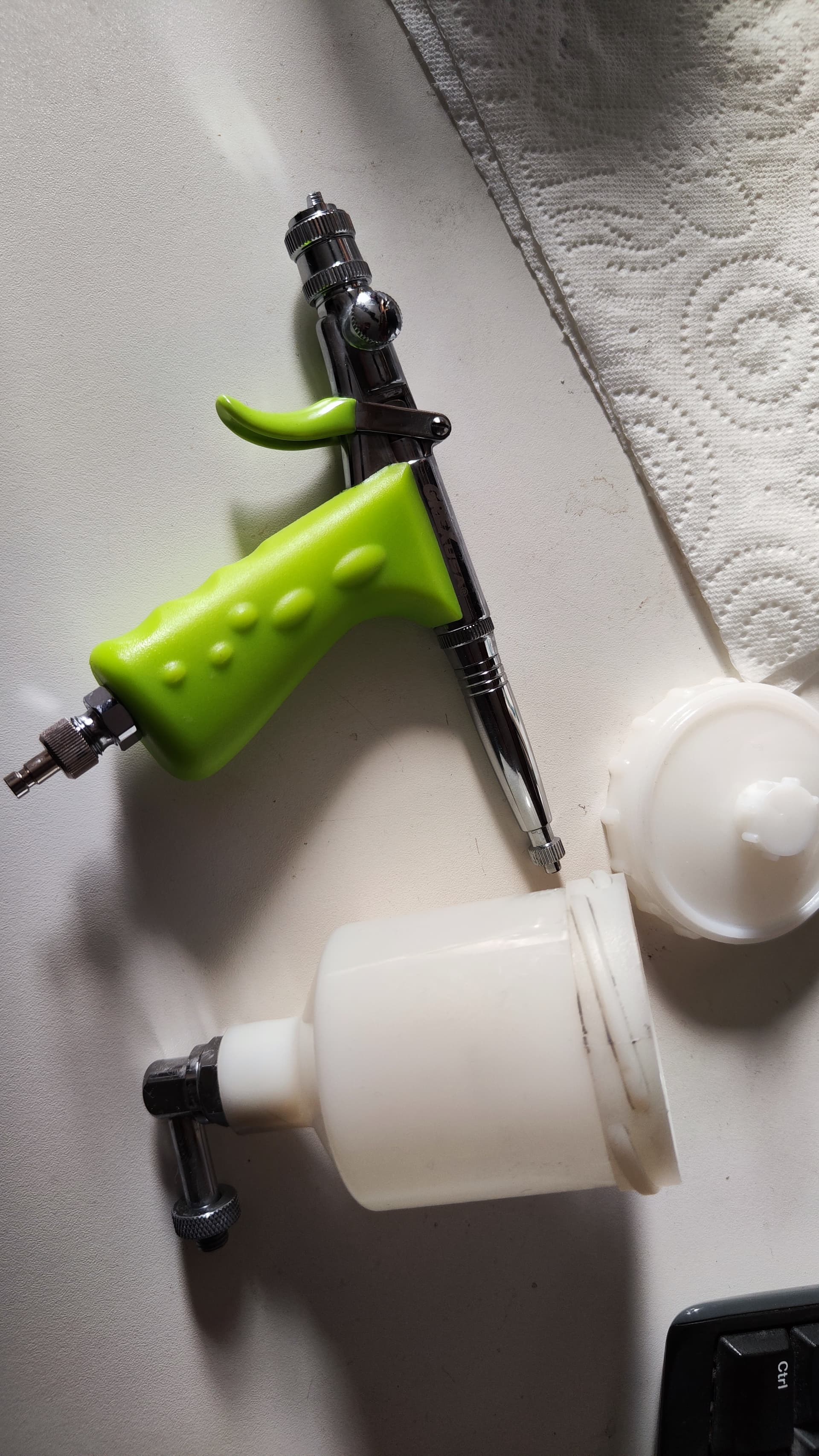

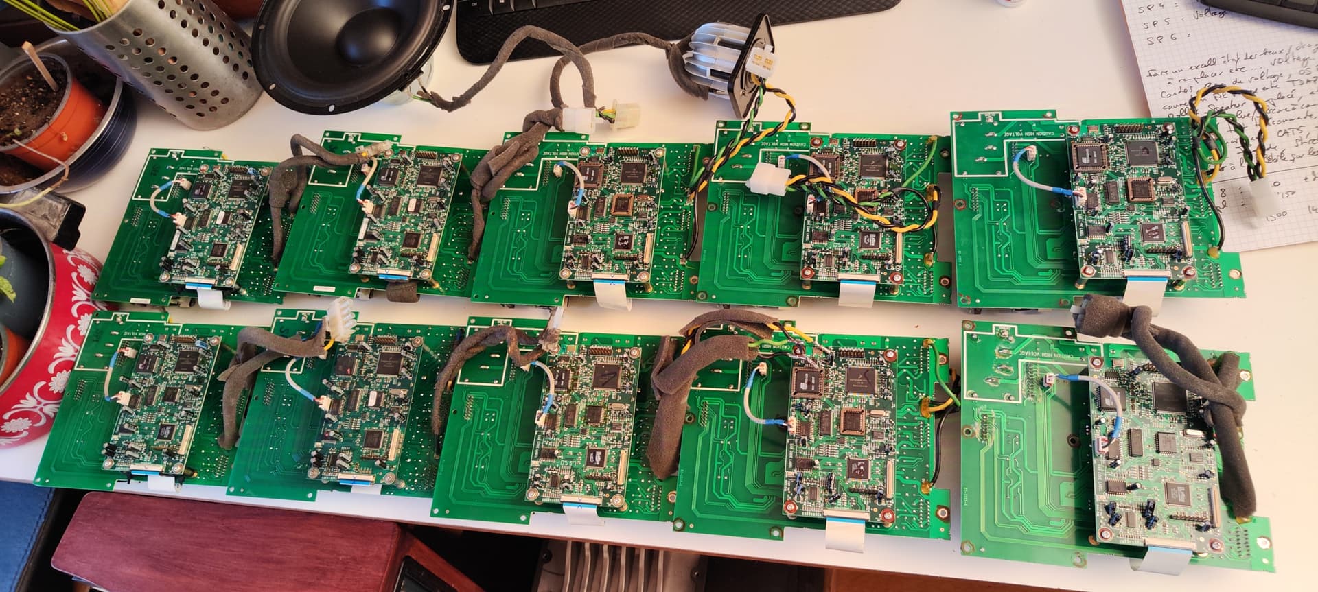

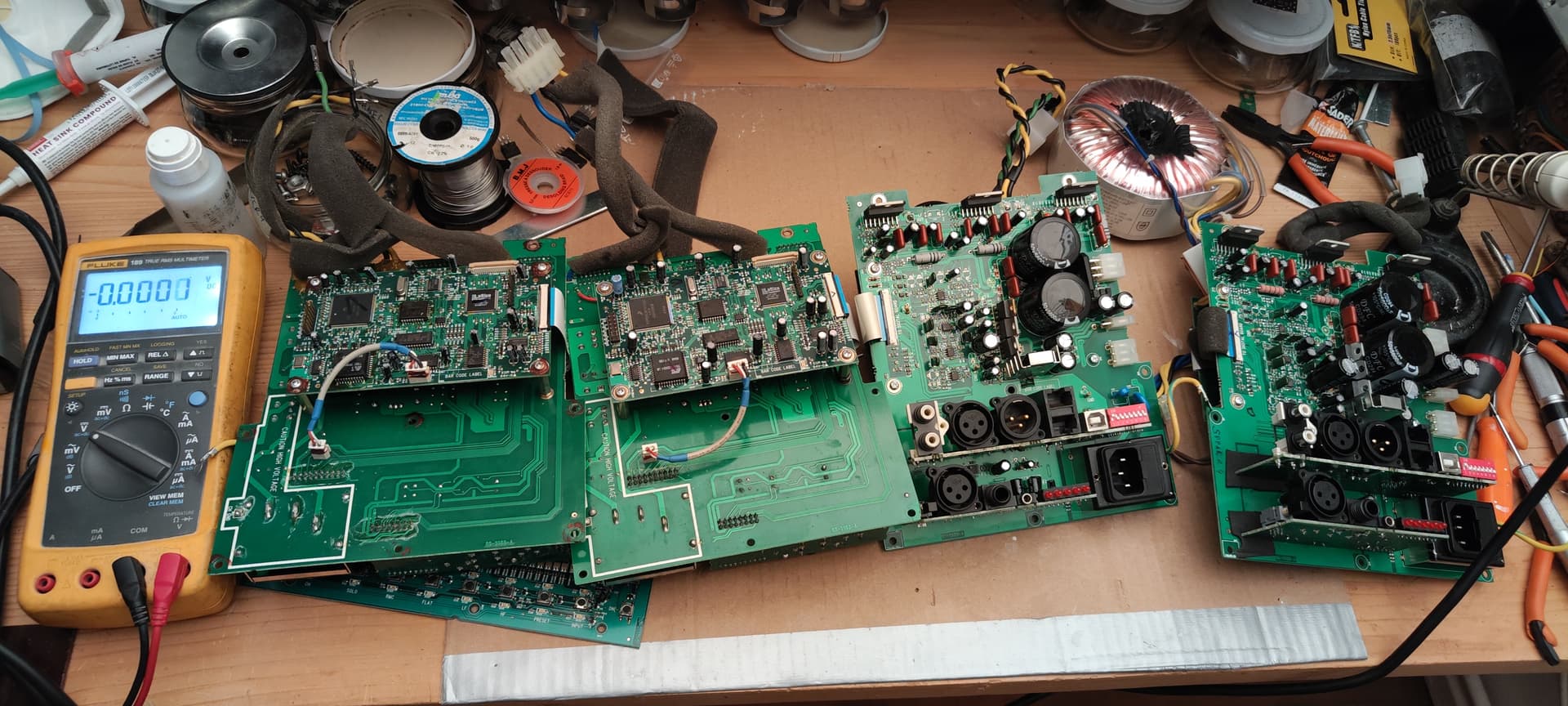

Thanks again for your help. I finished a couple weeks ago the work i did on these studio monitors that i found in the street, it was a hard work … One year on it … Electronically, cosmetically … Lot of research … And it was the first time i used an airbrush.
In the end, i used revell 9 80% and humbrol black 20 % enamel paint. No varnish on the paint.

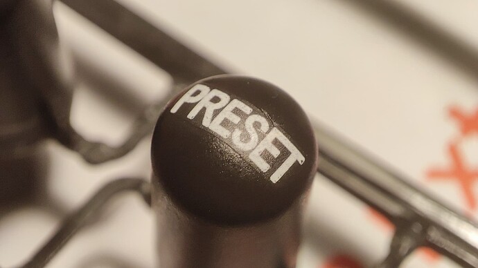

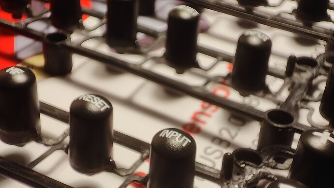

for the buttons, i used the same paint, then gloss enamel varnish, then decals, then matt enamel varnish.
i used a paint filter to paint the cabs, i think it was helpful. i had to sand a bit some rough surfaces sometimes and repaint it.
this is exactly the result that i wanted :slight_smile:
now, i feel more confident to paint some models.

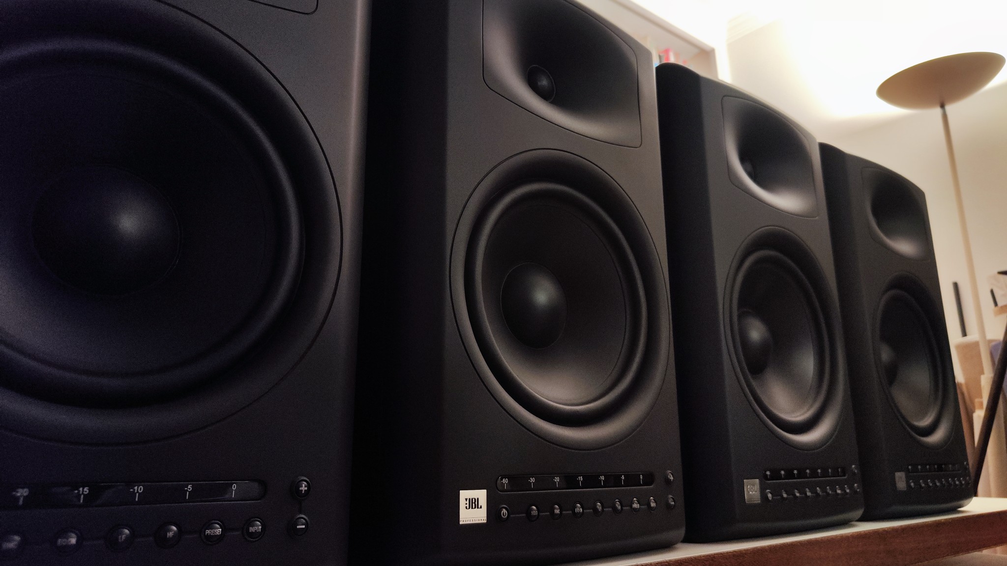

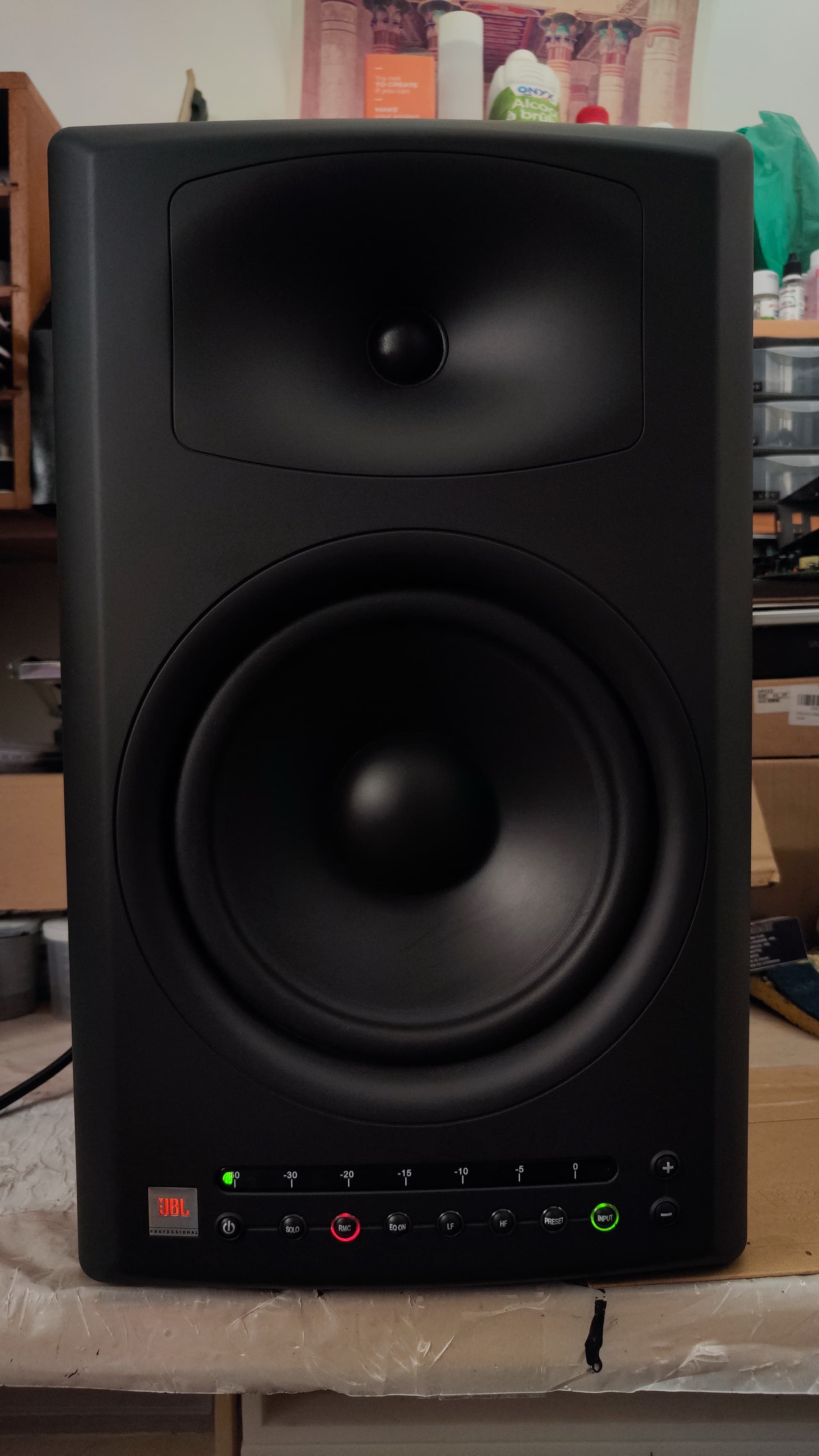

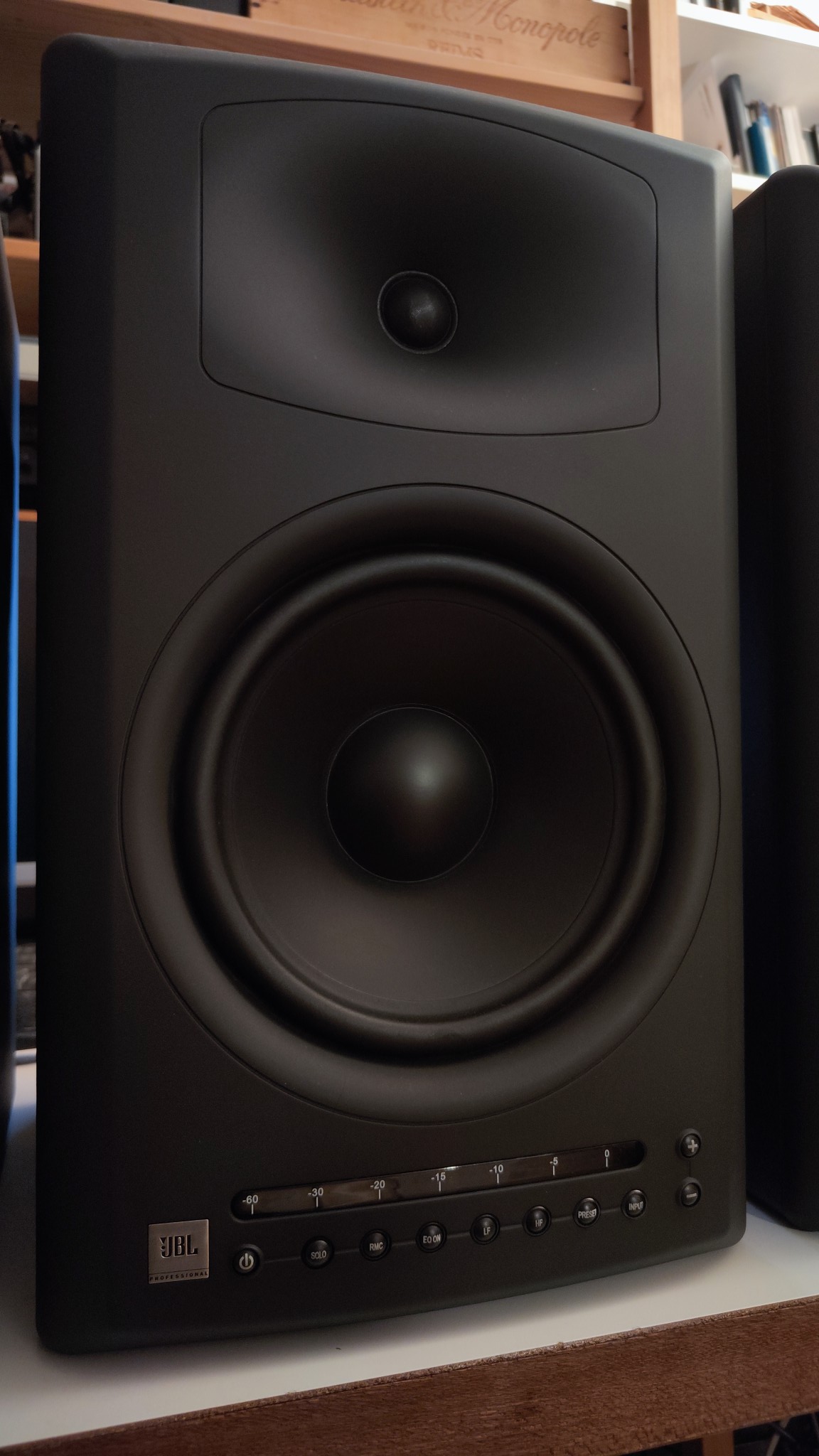

Here, some more
others
And the result :slight_smile:
What a unique project to undertake. A considerable amount of work and a variety of different skills to achieve what you have. Looking at the finished products I would be very surprised to learn that they were not brand new, fresh out of the box. Well done.
Thank you very much !! :slight_smile:
Brand new, they were not as sexy i think :wink: as i prefer this darker color …
