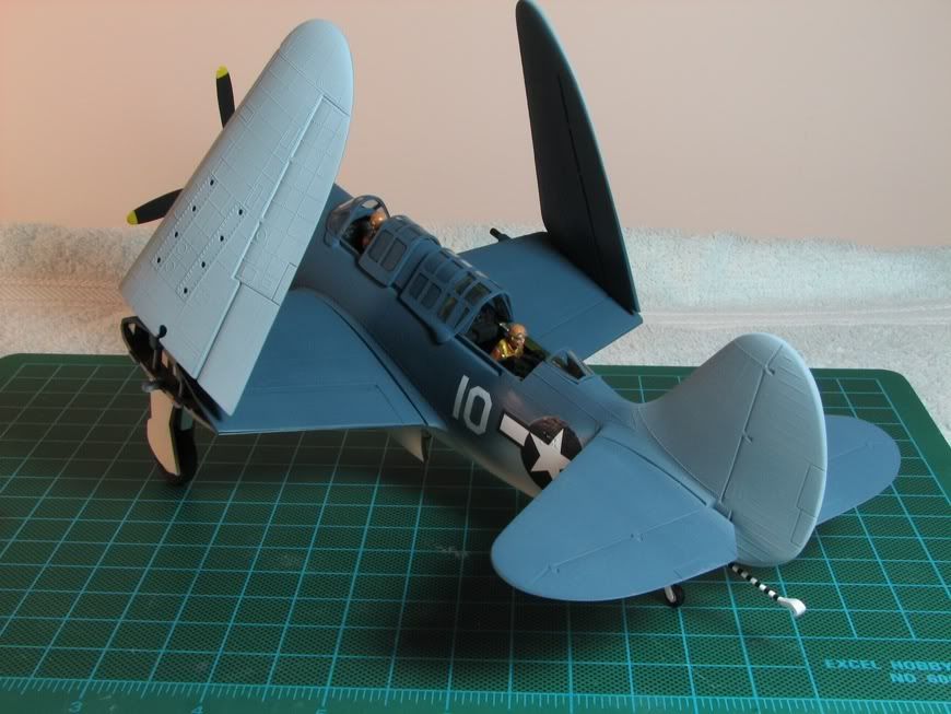

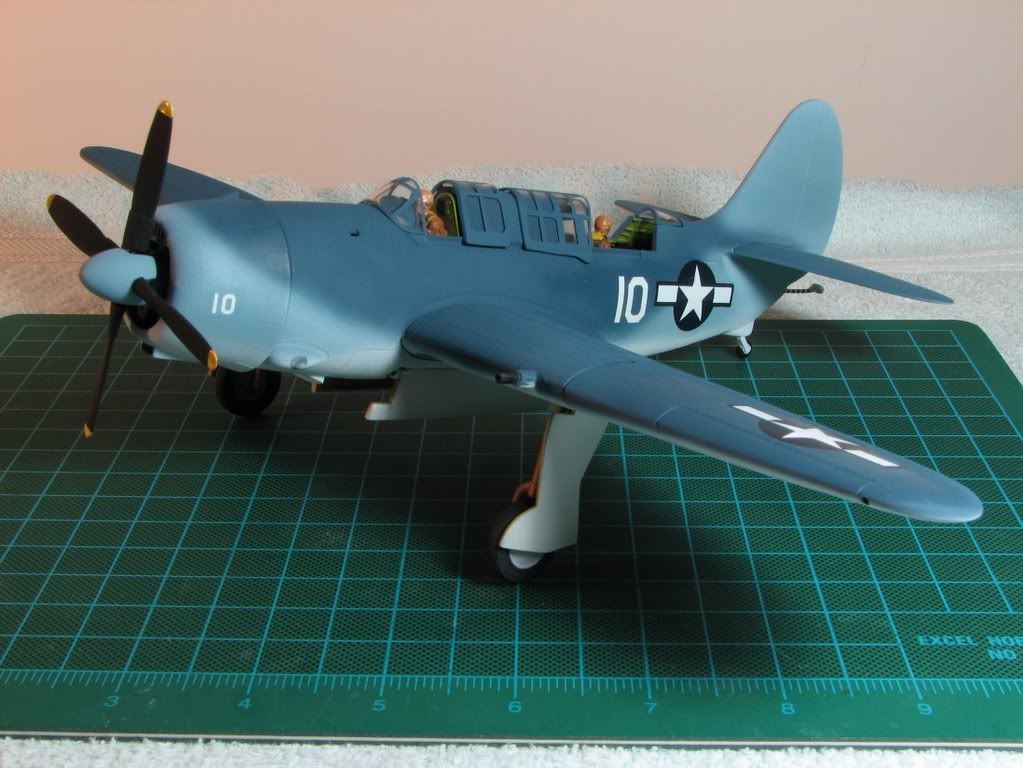

Andy, I built this old Helldiver (kit 0069) a few years ago. I really never finished it as far as weathering. It is kinda crude but such as it is, I have attached pictures for encouragement. This is the kit with the embrodered arm patch inside. Greg
Wow, great work, Marc and Greg. If I can get mine looking half as good, I’ll be over the moon. I’m not sure what kit I’ve got but the retractable undercarriage and dropping bomb don’t sound like my version but I think wing folding is possible. I’ll have to dig it out of the stash and have a good look, methinks.
