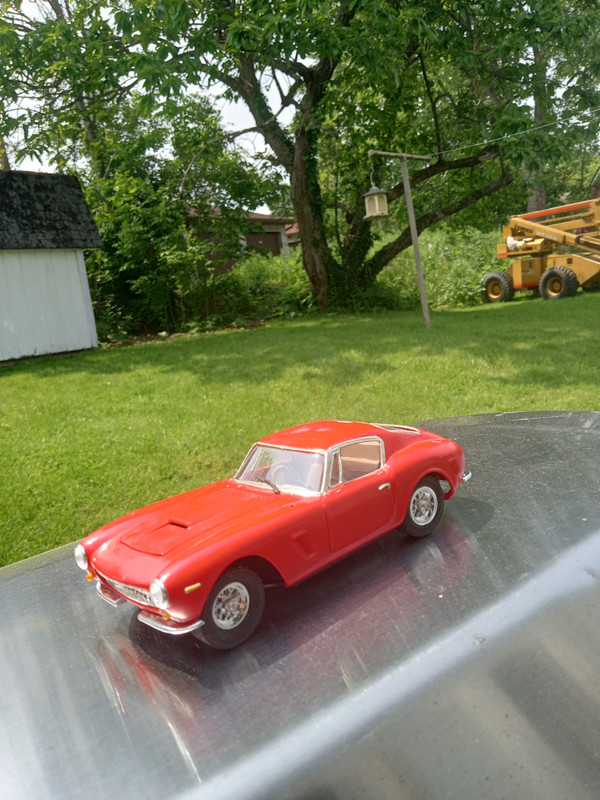

Looking good ; I used Italian red on my Ferrari 250 Short Wheelbase Berlinetta Really nice paint!
