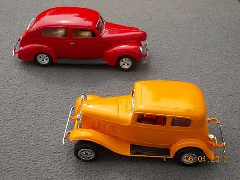

I studied commercial as well as classical art and have some experience with a brush so even though this is my first attempt at model building I decided I would like to use a brush. I went on the web to see if other modelers did hand brushing on cars and came across the following:
Statment by the builder.
*I used medium and large soft-bristled synthetic-bristled brushes that I bought from Hobby lobby. The Red '40 sedan is one coat of Testors #1103 square bottle Red, out of a well-mixed brand-new bottle. The kit plastic was light tan. It is unprimed but washed with rubbing alcohol. I applied two coats of Future with the same type brush that I painted the car. The Tangerine '32 Vicky was molded in Silver plastic. I applied two light coats of Plastikote Sandable White Primer. I used a brand-new square-bottle of Testors Gloss Tangerine/Mandarin Brilliant that I bought at a Michael’s store. I applied one coat of Tangerine with the same two brushes I used on the '40 sedan. When the paint cured, I applied two coats of Future by brush.*I don’t own an airbrush. I didn’t sand and/or polish anything. I have been brush-painting airplanes and military vehicles for over 50 years.
This gave me great inspiration.

Thinning the paint is part of the success story. I use thinner of some sort in acrylics and odorless mineral spirits in enamels cut about 30-40%… Either can produce strokeless results. The shine in the two Fords shown can undoubtedly be attributed to the magically self leveling Future. It wouldn’t matter a whole lot if the color coat was acrylic, lacquer or enamel with Future on top of it… And that’s great if clear coat finish is the look you want, which for myself is most often not the case. It works for semi custom cars of older vintage and for modern cars. But in car models my aim is more period stock classics and antique which were not clear coated.
My brushes I prefer right now have Taklon bristles. But while I brush paint many things, I no longer brush car bodies, perhaps not for 50 years now. I recall my biggest enemy was losing a bristle from the brush in the finish lol. So buy decent brushes.
