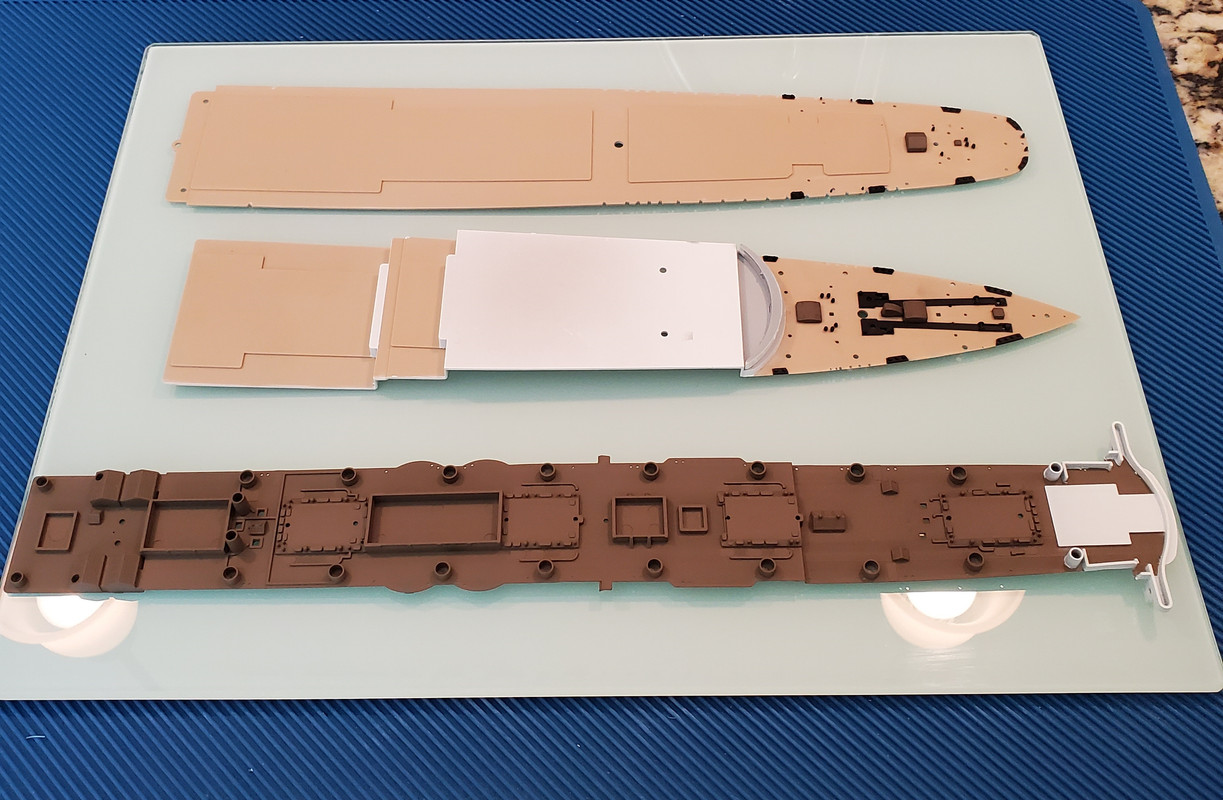

I’m waiting a couple of weeks to see if the wood decks come through. Without having them there’s not much I can do. Just a little painting and mounting the model to the stand.
Since I know I stink at painting with a brush I am masking and spraying every door on this ship. I am about half of the way there. It’s quite tedious masking these tiny doors! Even if I were good at it I do prefer the way sprayed paint looks over brushed. For the windows I ordered a bunch of 1/350 Titanic window PE sets and am going to use what is closest to the shape of the windows on the Lusitania. I know it won’t be accurate but I think it will definitely look neater than my painting them. Since I am waiting to see if the wood decks are produced I have the time to do all this masking.

Thanks Silly_me. Yes it’s a hard to find kit but they do pop up on ebay now and then. There is actually one on there now from The UK. It’s a pretty nice kit so far. The parts are a lot cleaner than my last model. I have the wood decks on hold since there is a rumor that Scaledecks may come out with a precut kit in the near future. I’ll do what I can until and if that becomes available, if not I’ll continue with cutting my own.
Thanks Bill. I actually bought a color laser printer to make decals with. I have a file for Lusitania windows and I printed it up…came out pretty good. I think I am going to use photo etch windows from the Titanic kit for the Lusitania windows though, but having the ability to make decals is kind of cool. I’m sure I will use it in the future.
I bought the same model printer Micromark sells with their decal kit so I figure at least if they are using it for decals it should work well. I printed the first few on clear decal paper from Amazon but since have bought some of Micromarks decal paper. My thinking is if I buy what Micromark has proven to work I should get decent results.

Yup 1943Mike, that’s what I’m waiting on. I am trying to do other things until the decks come out. I cut some of my own but it’s tedious work and will never look as good as laser cut decks from Scaledecks. I can’t wait to get them.
The only thing I am debating about is whether to cut them around as opposed to leaving the decks under walls on the lower decks. I checked the dryfit of the side slot where the decks would fit and it’s really tight. I ran into the same issue on my Titanic. Even though the wood decks are thin it’s like a tolerance stacking issue as you add decks. The top decks won’t be an issue but the decks on the bottom I may have to sit plastic on plastic to avoid fitment trouble as I add decks.
