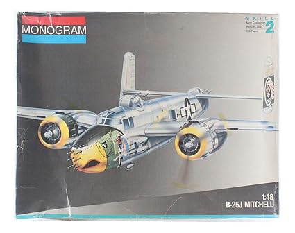

Thanks guys. Who makes a resin gun nose convErsion for the Revell Be 25J
I want to say that Cutting Edge did, but it is OOP. Monogram did a hard gun nose J kit also.
and of course there is their field conversion glass nose kit as well

I think Accurate Miniatures did that one, the G. Monogram did the 75mm w/ 4 x .50s, a H as their original B-25 kit in 1/48. I can’t recall when it was last re issued.

In 1/48, between Accurate and Monogram/Revell, all of the major production versions and field conversions have been covered for the B-25. B, C/D (and strafers), G, H, and J. The trick is finding which kit(s) you want for the Mitchell. Not a bad situation for us modelers.
