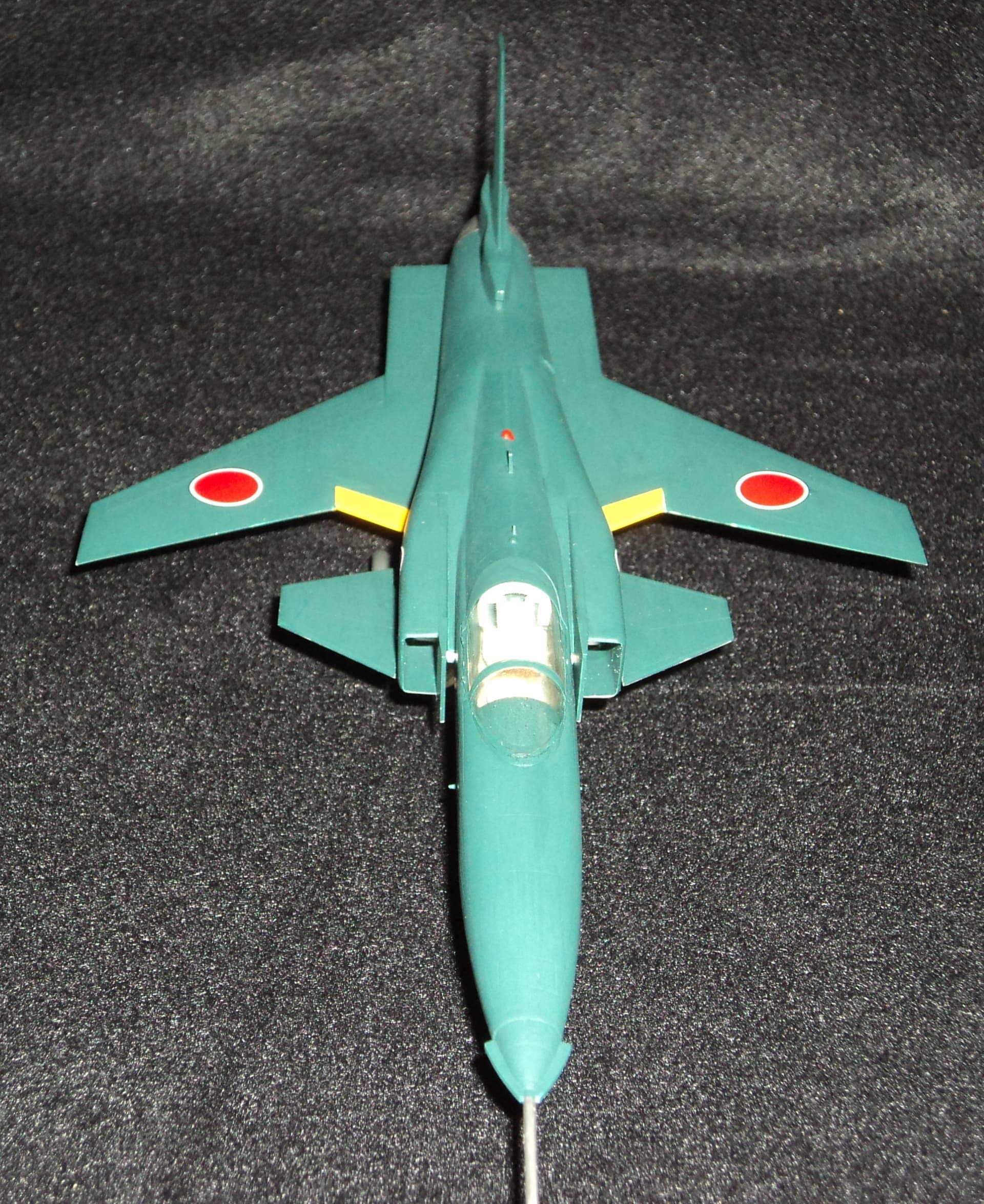

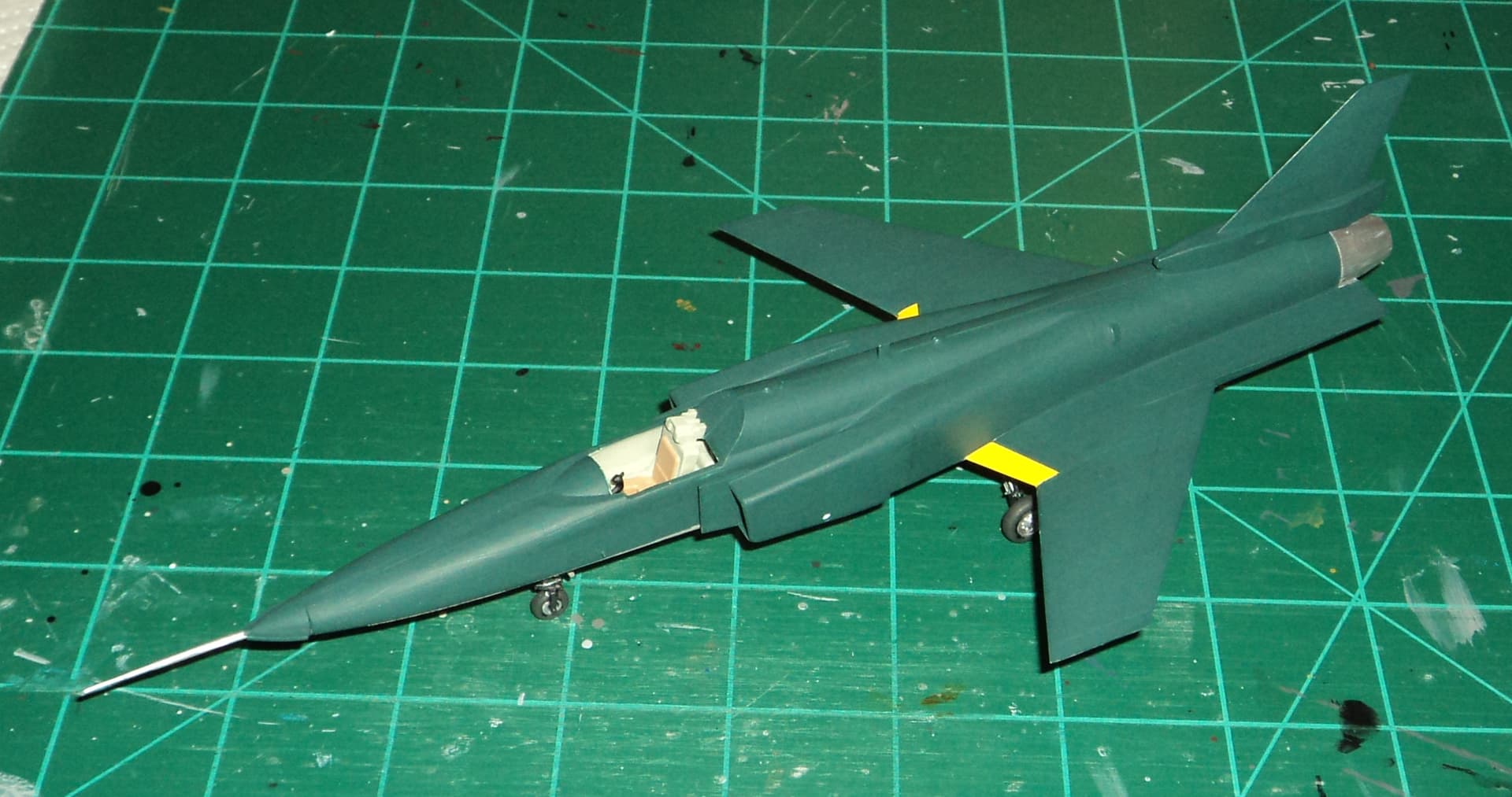

Hope to finish this model this weekend, but we’ll see.
Still have to finish the canopy, decals, landing gear doors, canards.

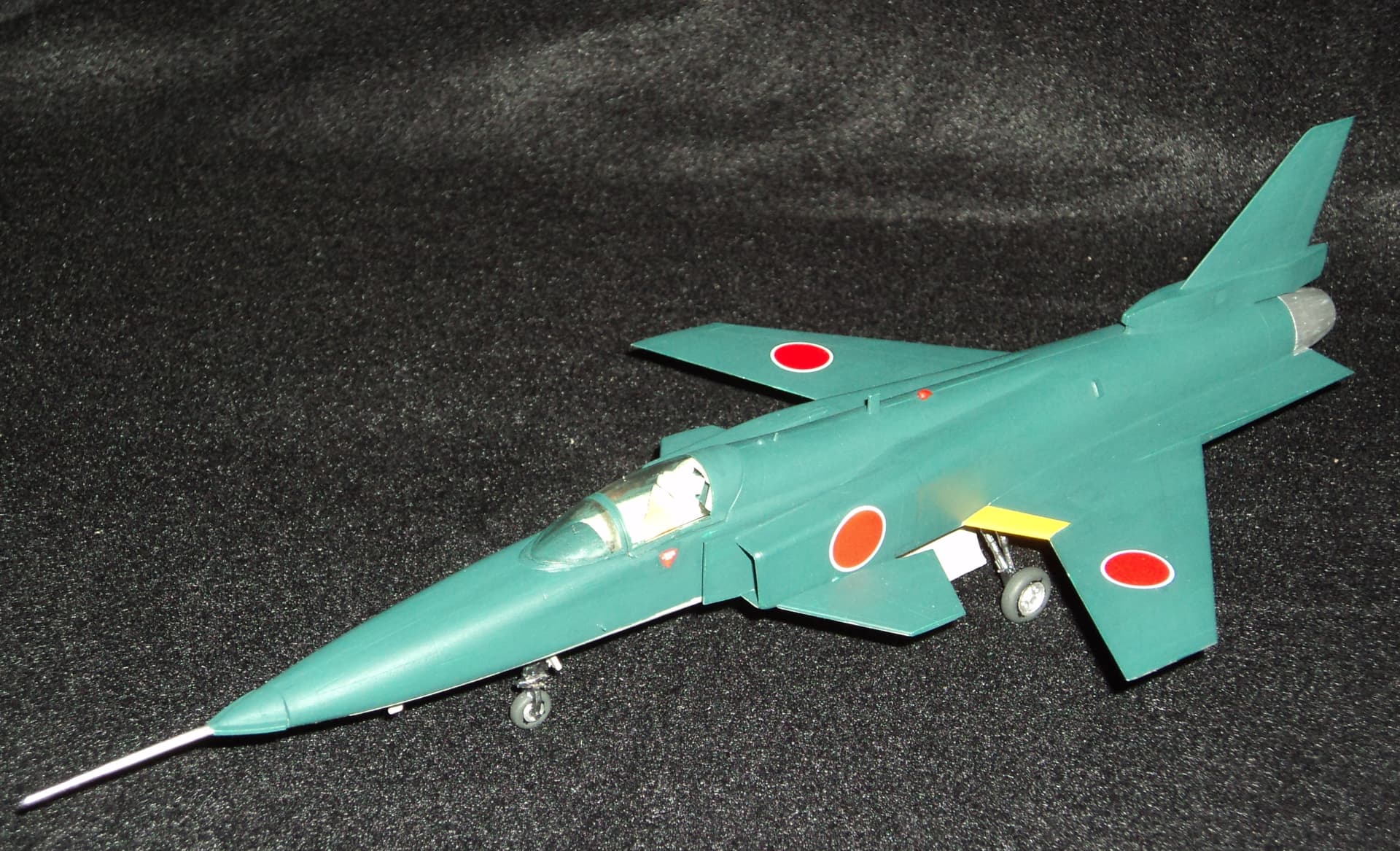

So why did I chose an X-29 in retro WW2 Shinden colors?
An idea came about in if the J7W Shinden had a modern aircraft equivalent, what would it be? The only thing I could think of was using a second X-29 kit I had at home. The Shinden never had forward swept wings. But both the Shinden and the X-29 are experimental prototype aircraft and they have canards on them. In short, I’m building and painting this model out of plain curiosity.

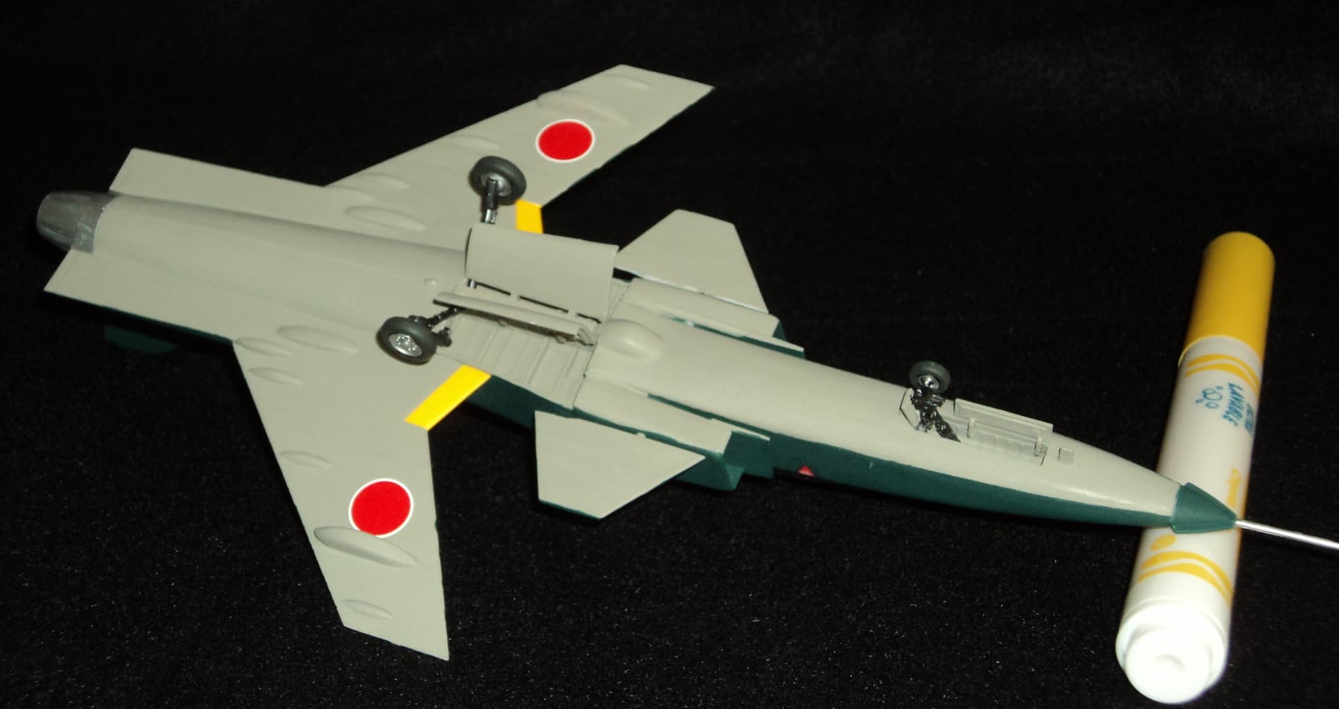

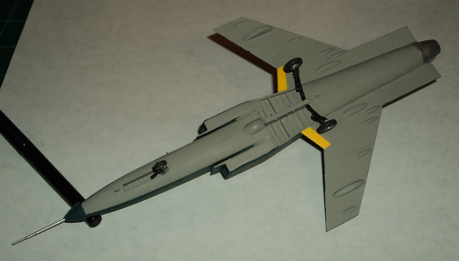

Due to black and white WW2 photos, or “colorized” black and white WW2 photos, as well as differing painting instructions from various Shinden model kits, it was hard to figure out what colors the J7W Shinden had and how I should paint the X-29. Finally, I just said screw it and went with the following: Vallejo #’s 71.310 IJN Deep Dark Green, 71.312 IJN Medium Grey, 71.321 IJA Light Grey Green (cockpit interior), and 71.073 Metallic Black for the landing gear. Some modelers who built Shinden model kits painted the wheel wells an Aotake metallic blue type color. I decided not to do this for the X-29 as I felt this would not look good on the model.

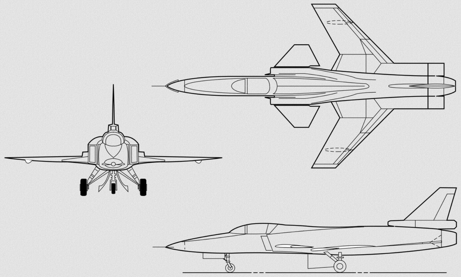

Comparison drawings of X-29 (Top) and J7W Shinden (Bottom).

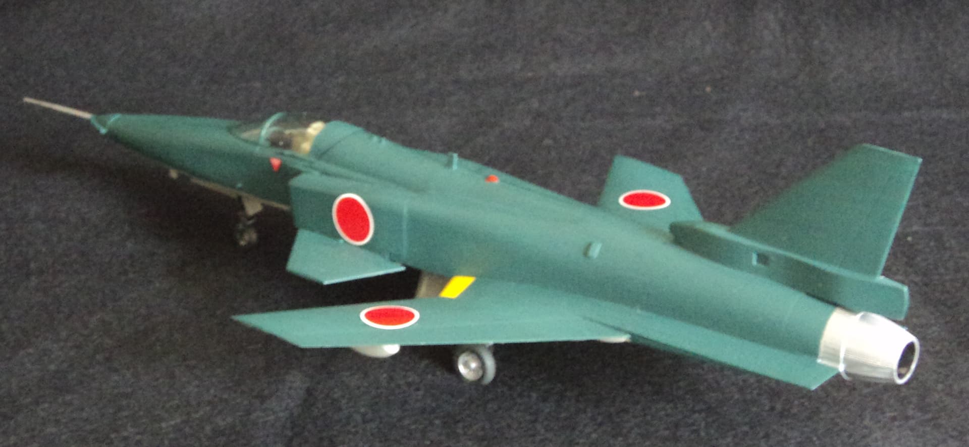

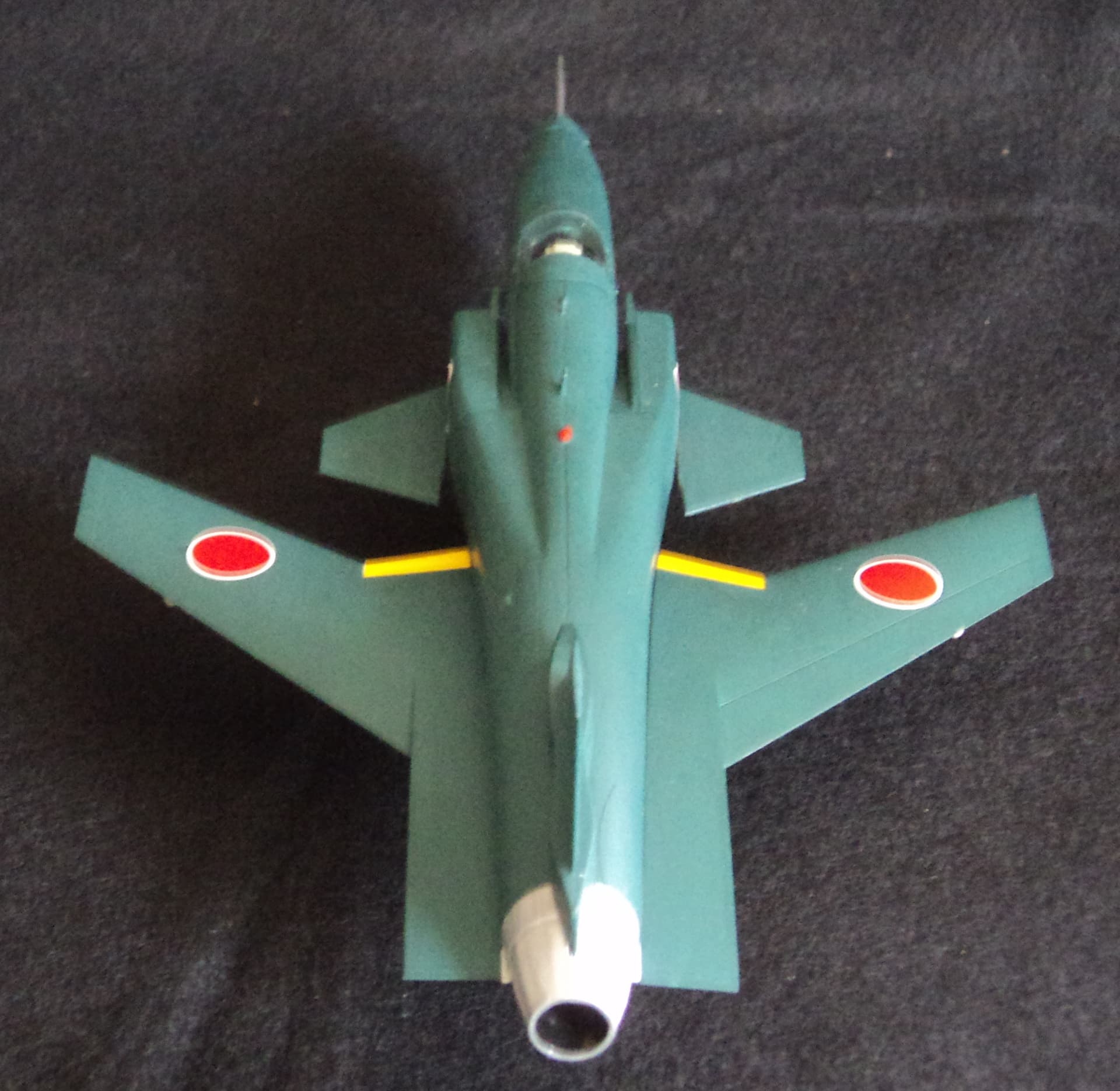

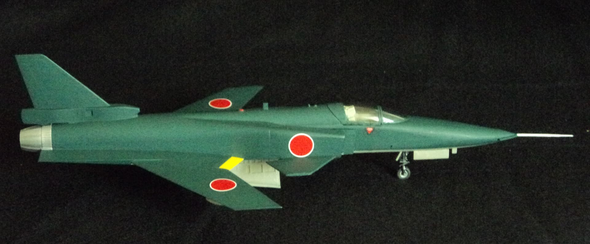

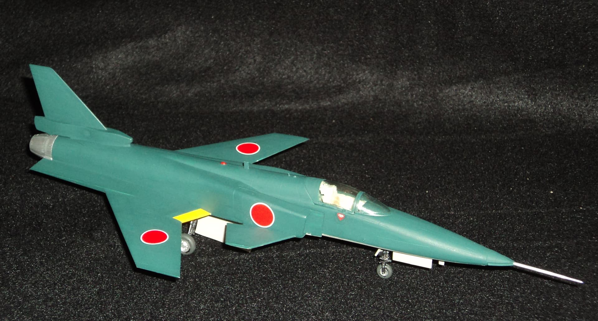

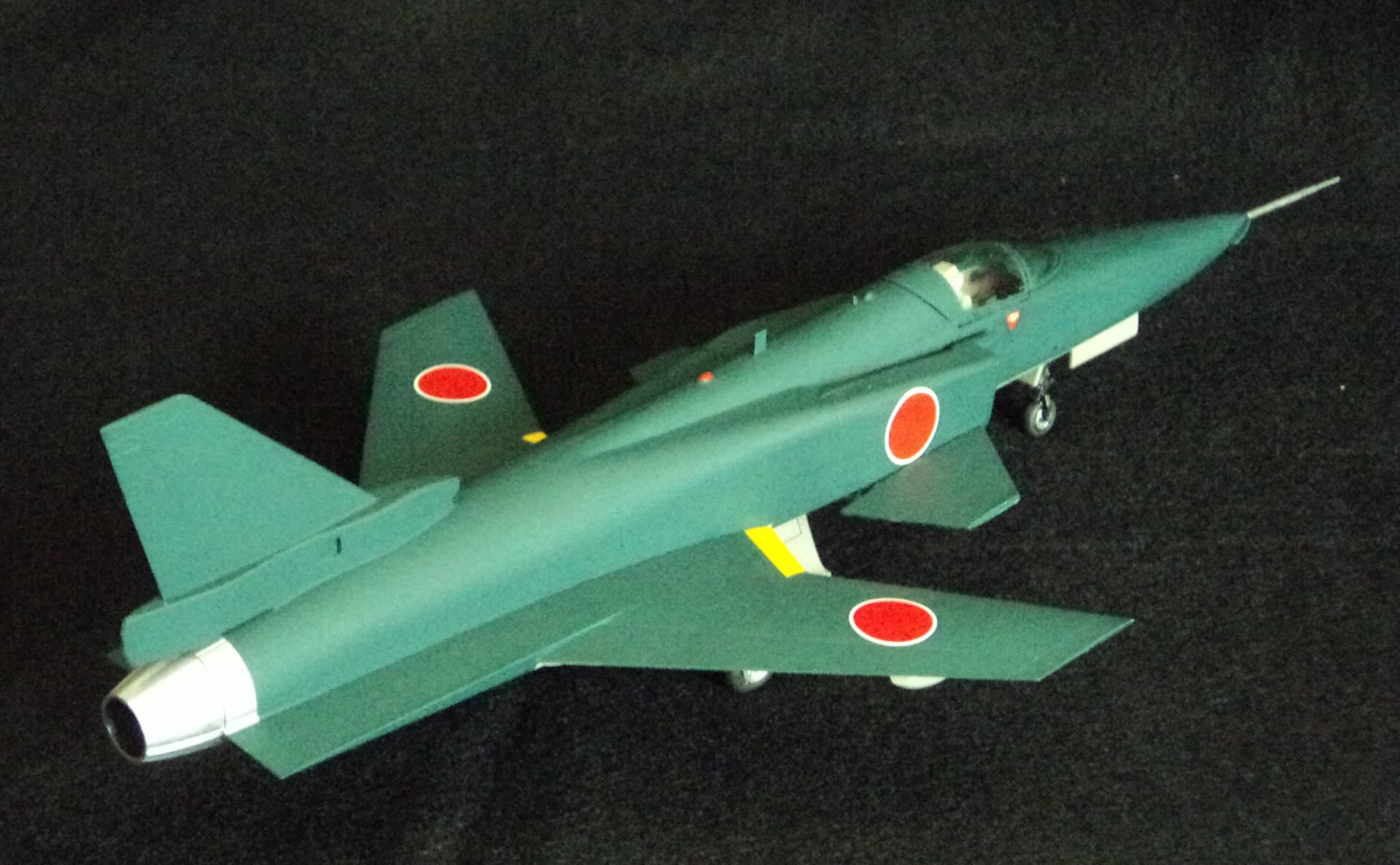

Well, it’s done. Excuse the crappiness of the pics as I have a crappy camera and even crappier photography skills.
This whole model was done just out of curiosity and fun. Nothing more. If there’s any mistakes, I’ll try to correct them later. This model is not meant to be contest worthy.
@WhatIfRebel Your X-29 looks great. The colors look right for a Shinden.
Thanks. Appreciate it.
If the green in some of the pics looks a bit bright, it’s probably due to camera flash or other lighting sources.

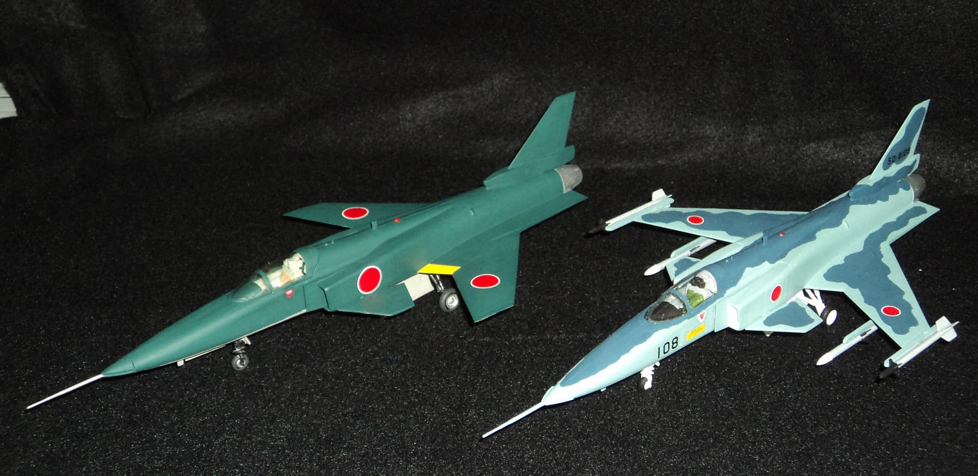

Here’s a few extra pics of my X-29 “Shinden II” next to an earlier two-tone blue Japanese X-29 I did long ago.
I think I’m having too much fun with these X-29 kits. The Hasegawa kit is a small and relatively easy kit to put together with not many parts. Almost wish I had a few more of these kits as there’s a few other concepts I’d like to build.
