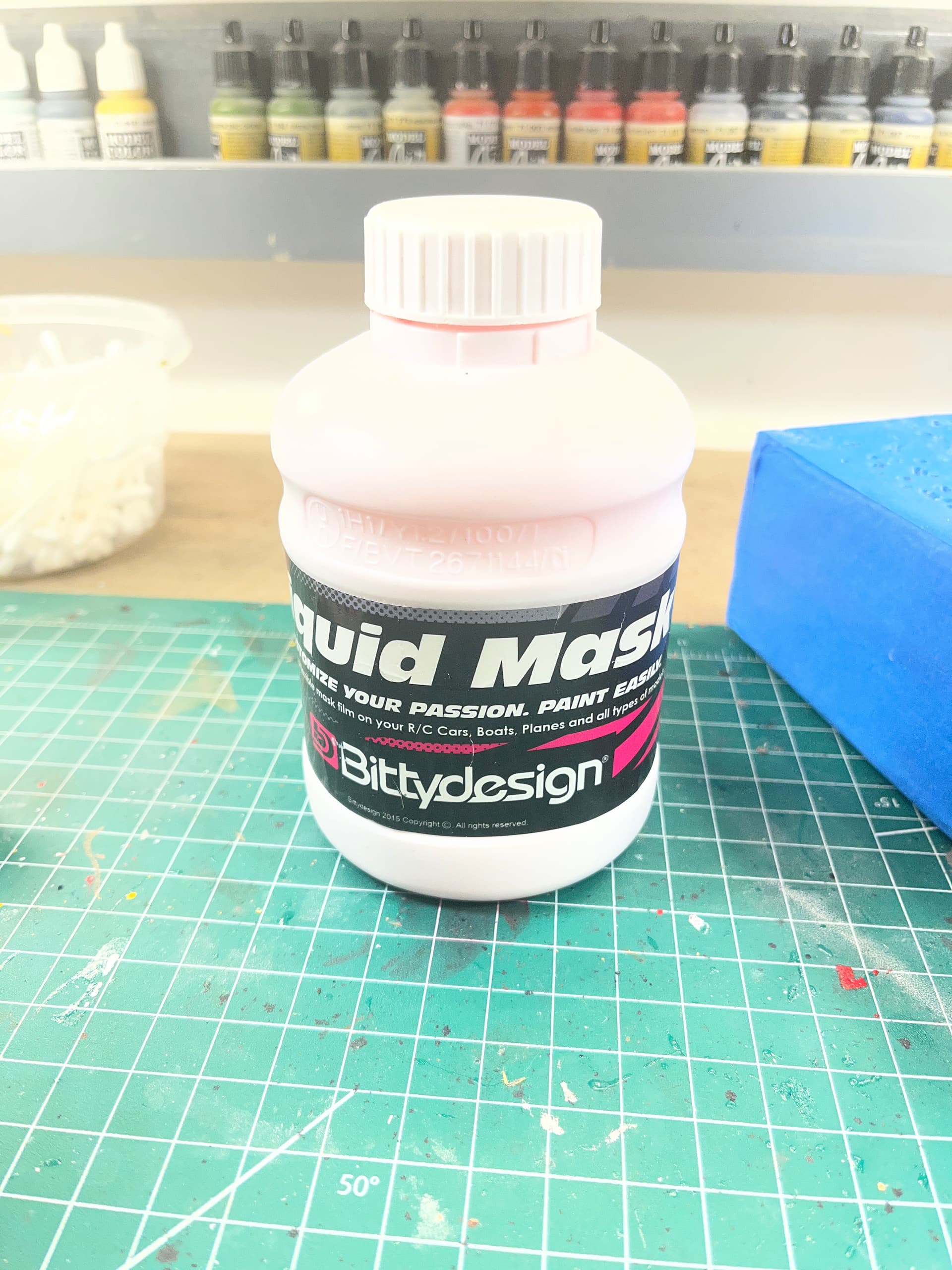

I mostly use tape to mask my canopies . If I have the chance, I will use liquid mask. Somewhat easier to remove.

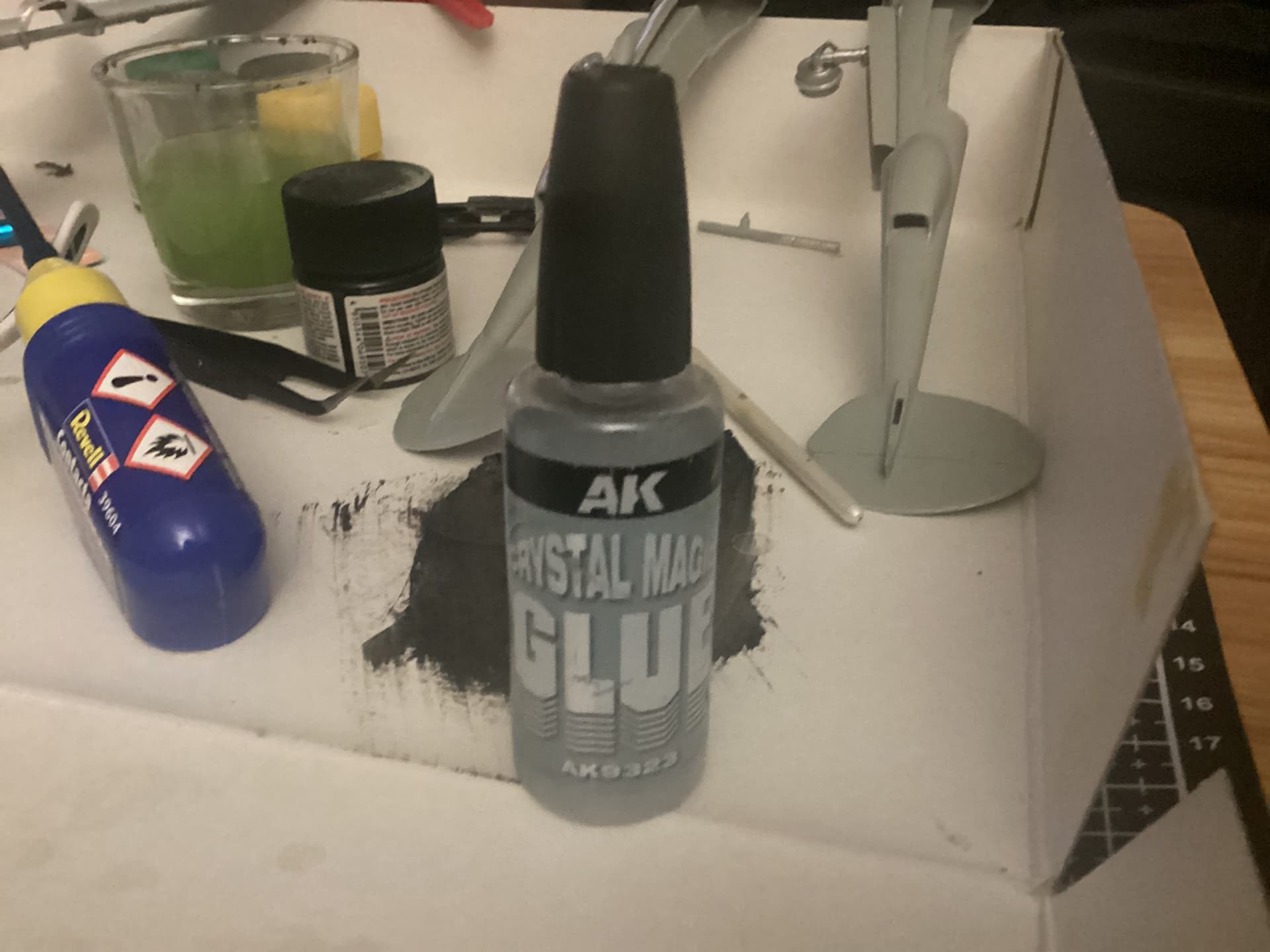

I had the same problem for years until I found this glue,it is the best for clear plastic windows and canopies AK crystal magic glue
