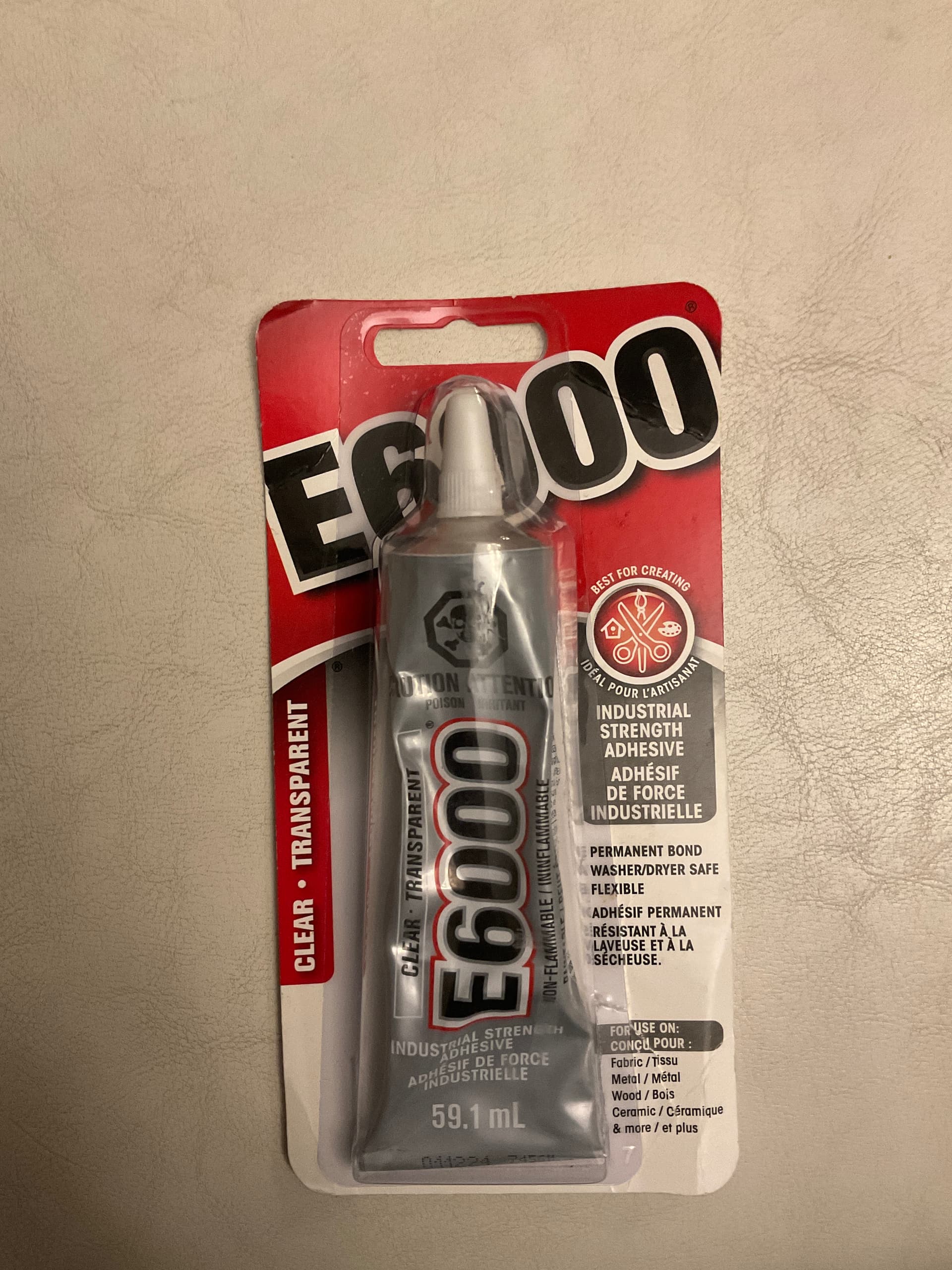

Another alternative is this stuff
I have yet to find something that this couldn’t stick together. Kids broken glasses, broken ceramics, broken dishes, model parts made of vinyl, metal, plastic, resin, styrene, 3D print….. You name it, I’ve probably tried it.
It bonds really well, although you may need to apply a bit of pressure to the join line. It has a bit of flexibility, but not noticeable in thin applications. This is my go to glue for difficult to glue items. It really seems to be the duct tape of glues.
