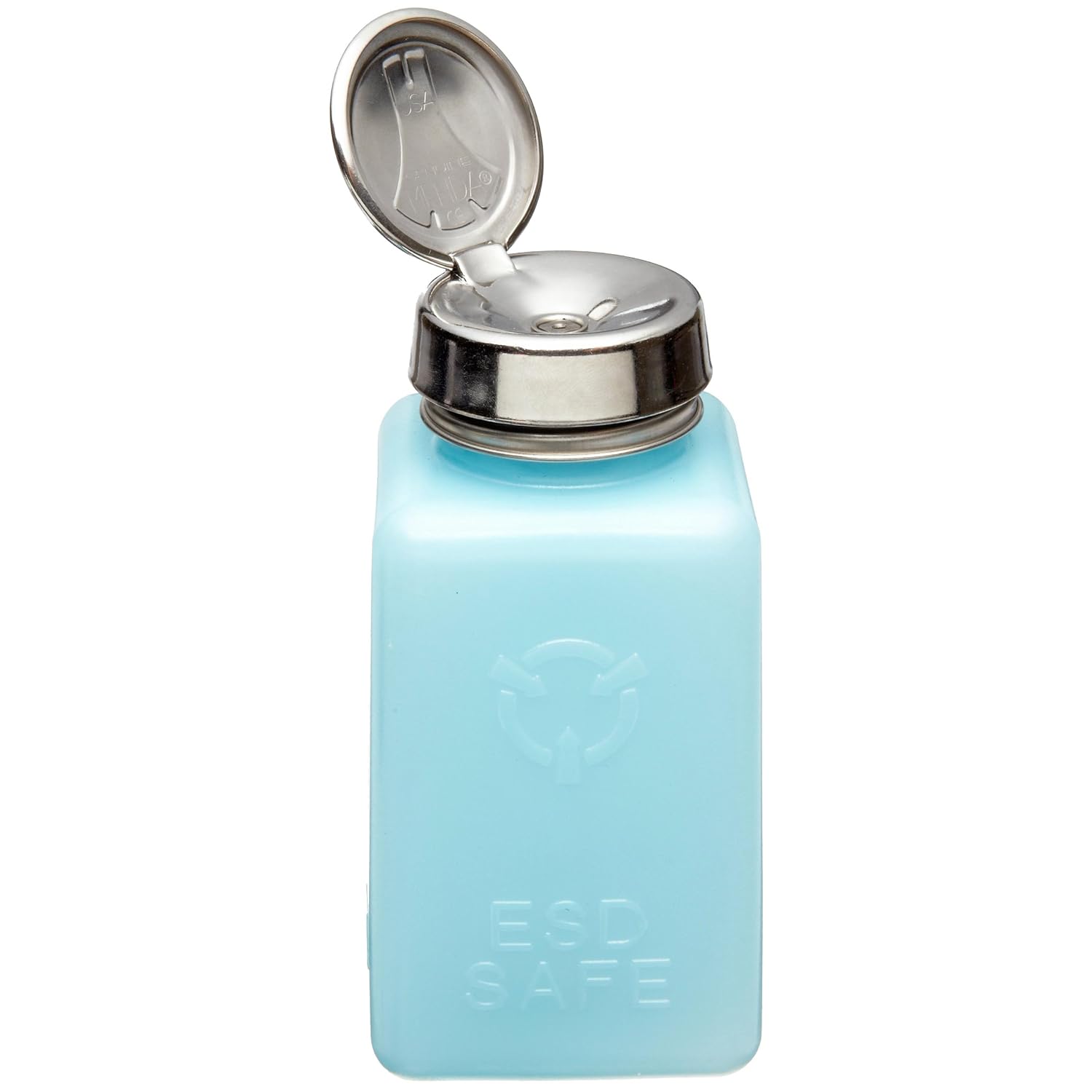

I use hardware store MEK and keep in in an industrial solvent pump bottle.
The reservoir design and flip-top help minimize evaporation while it sits on the bench between sessions. The wide base and valve top design minimizes spillage. Pump the top and get some solvent in the top reservoir. Touch a fine point brush to pick up the MEK and apply to the joint.
I got mine from work, where they were being discarded. The image is from Amazon - search under lab equipment

I also do like the idea of that bottle in the photo.
