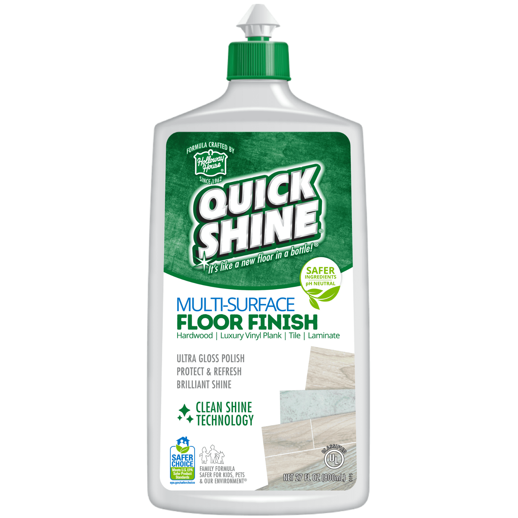

I’m almost 73.
Been modeling since I was 6-7.
This works just as good if not better than Future.
No thinning required and 27 fl. oz lasts darn near forever.
Be sure the wording is exactly as shown on the bottle.
Quick Shine at WALMART
Quick Shine Multi-Surface Floor Finish, 27 fl. oz., Cleaner & Polish
$6.87 -tax

I use Future, which is now out of production. It’s a clear acrylic floor coating. It’s much like Disastermaster describes Quick Shine. It could be applied by hand or by airbrushing, with no thinning, though it could be thinned, too. It’s self-leveling, and if you make a mistake, you could clean it with a weak ammonia solution. It was used as you use your gloss medium, as a base for decaling (smooth surface reduces the chance of silvering). It was used to dip clear parts, like canopies, to fill the tiny scratches and other imperfections in the surface that reduce the parts’ clarity. I use it on my toy soldiers, too, which I paint with matte colors, for a traditional gloss finish.
But since it’s out of production, you’re better off trying Quick Shine, like DM suggests.
Here is a YouTube video from modeler Jon Bius, describing switching from Future to QuickShine. It sounds like it produces the same or very similar results:
https://youtu.be/PVA_E1vd_Yo?si=CxKWvIBkX9Tk2yTE
When my bottle of Future finally runs out, I’m going to try QuickShine and see. And if it’s not that great for use with models, I can still use it on the floor.
