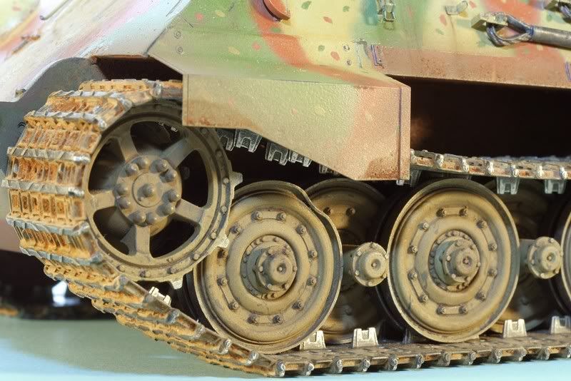

I actually use the metalizer method.
I paint my tracks with Model Master matalizer #1405 gunmetal, then i apply various kinds of pigments and then drybrush with chrome silver on points of cantact like the tread surface and the guide horns.
Here are some examples from a King tiger i built some time ago and a Tiger I that is in progress but where i have finished the tracks.
Although these are a bit dusty and crusty from sitting around for 60 years, they will give some idea of what they look like on the real thing. The manganese steel used for making tracks weathers to a characteristic dark brown-black color;
