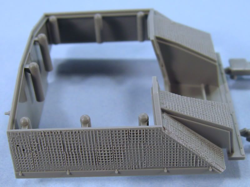

I generally apply it myself. I have used the cavalier, but I think it’s just about as much effort without the satisfaction. I recently purchased the new C-H Stug III with the waffle pattern zim. I’ve read somewhere there were issues on some items being covered or something like that, I’m not a rivet counter. It looked pretty good to me but I haven’t started the kit. I’ve never tried the waffle pattern, looked pretty tuff to do and get it right. Anyway I figure I’ll still be slinging putty at the sides of my panzers for some time to come.[:)]
I’ve used the Cavalier zimmerit on my Elefant, which I really liked. And I have all three of the latest releases from Dragon/Cyber-Hobby that feature pre-molded zimmerit. One of these days I’d like to try making my own zimmerit. I’ll probably try it for the first time on my Dragon JagdPanther Ausf. G1 Early since it is basically a slab sided vehicle and wouldn’t be too hard to practice on.
By the way, there were two issues with the Dragon/Cyber-Hobby StuH 42 Ausf. G which are documented in my review of the kit, just click the link below. [:)]

Dragon did a really good job replicating the waffle zimmerit on their StuH 42 Ausf. G.
This is not your father’s zimmerit. [(-D]

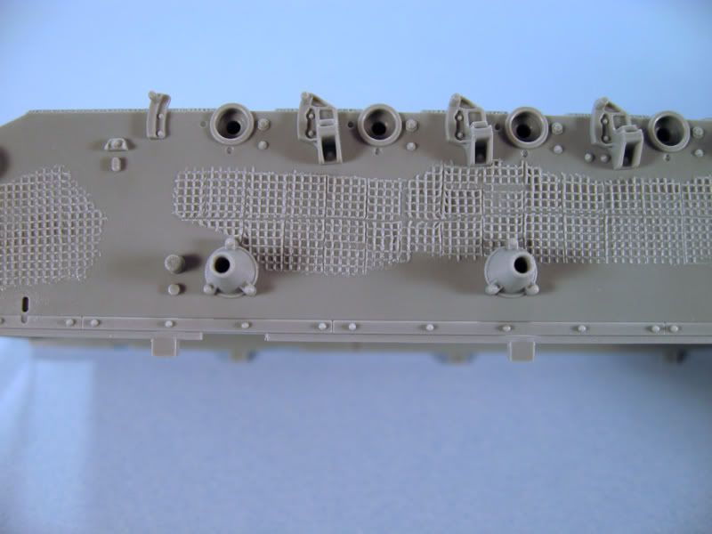

Wow Johan…that is quite a list of experiments there. I too traveled the full gamut, I had some success with putty, but as you know, settled on the hot knife.
Good luck with those ‘pre zimmed’ releases, sounds like you’ve earned it my friend!

I make my own. I’ve tried using Apoxie, Liquitex Acryl Gel, and Games-workshop Green Stuff by far. Didn’t like apoxie at all since it somehow ended up in a mess in my hand and it stinks like dirty damp drains. The acryl gel medium was a little soft on the detail but really easy to do and redo. I just wish it were a little thicker but then when I drag the Tamiya Zimm tool over the surface it tears up. The best detail I got so far is from Green Stuff but it’s just expensive in the long run. I bought the tamiya epoxy putty and polyester putty a while back and plan to try them for my next attempt together with this ProCreate sculpter putty suggested by the hobbyshop owner when I was trying to get milliput.
