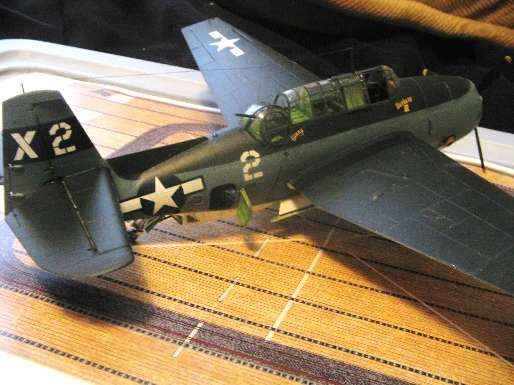

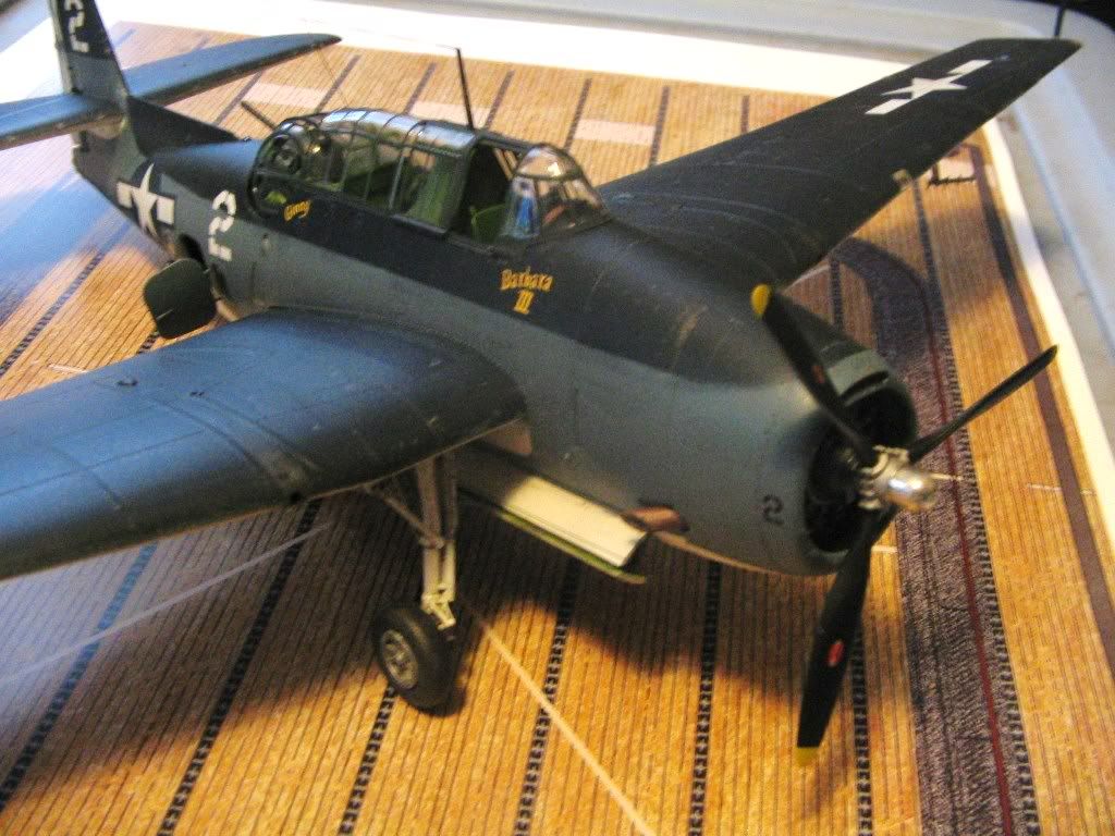

I finished my Accurate Miniatures build of the TBM-1C Avenger flown by bush in 1944 off of the USS San Jacinto. It is basically out of the box although I had to modify the tail decals to match photos of the actual plane. I will be doing a more accurate deck once I find out the correct color for the deck of San Jacinto. I will also add the Tamiya Tow Tug and some figures to complete it.

Excellent Avenger!! Looks amazing! What color did you use for the top?

Great job there! Really nice work on the double colour demarcation lines.

Paints for the 3 color Navy camouflage are simple, all Testors Model Master enamels, Dark sea blue upper surfaces, Intermediate blue sides and white underside. I used Future before decaling and a sludge wash of medium gray Tempra paint to pop out the panel lines. The kit decals are not that good, the insignia is about 30% too big for the Avenger in this scheme. I replaced all insignia with left over P-47 decals that looked to be the correct size. And the X-2 decal in the kit did not match the only photo i have found of this aircraft.

Really nice work on the model. I’m not sure who’s right, but the TBM at the Bush museum shows slightly different markings. The X2 on the tail is different, the colors are softer edged, and the name “Barbara II” is on the left side only. Here’s a picture:
http://bushlibrary.tamu.edu/image.php?id=
That is a restored TBM and it is not in the correct color shade. They also had a sharper edge rather than a soft edge. So far from what I see the model is more accurate.
Also the model is of Barbara III
Sorry, let me correct that, I shouldn’t have worded it as “who’s right” because that’s not correct. The plane in the museum seems to be the one he remembers best. The actual plane he was shot down in was X3, not X2, and the X2 markings that the kit has were used after he returned to the San Jacinto, and before they rotated out (a fairly short time). Also, according to most sources, the name “Barbara” was never actually painted on any of the aircraft since the unit commander forbid that. He called them that, but it wasn’t actually on the plane.
