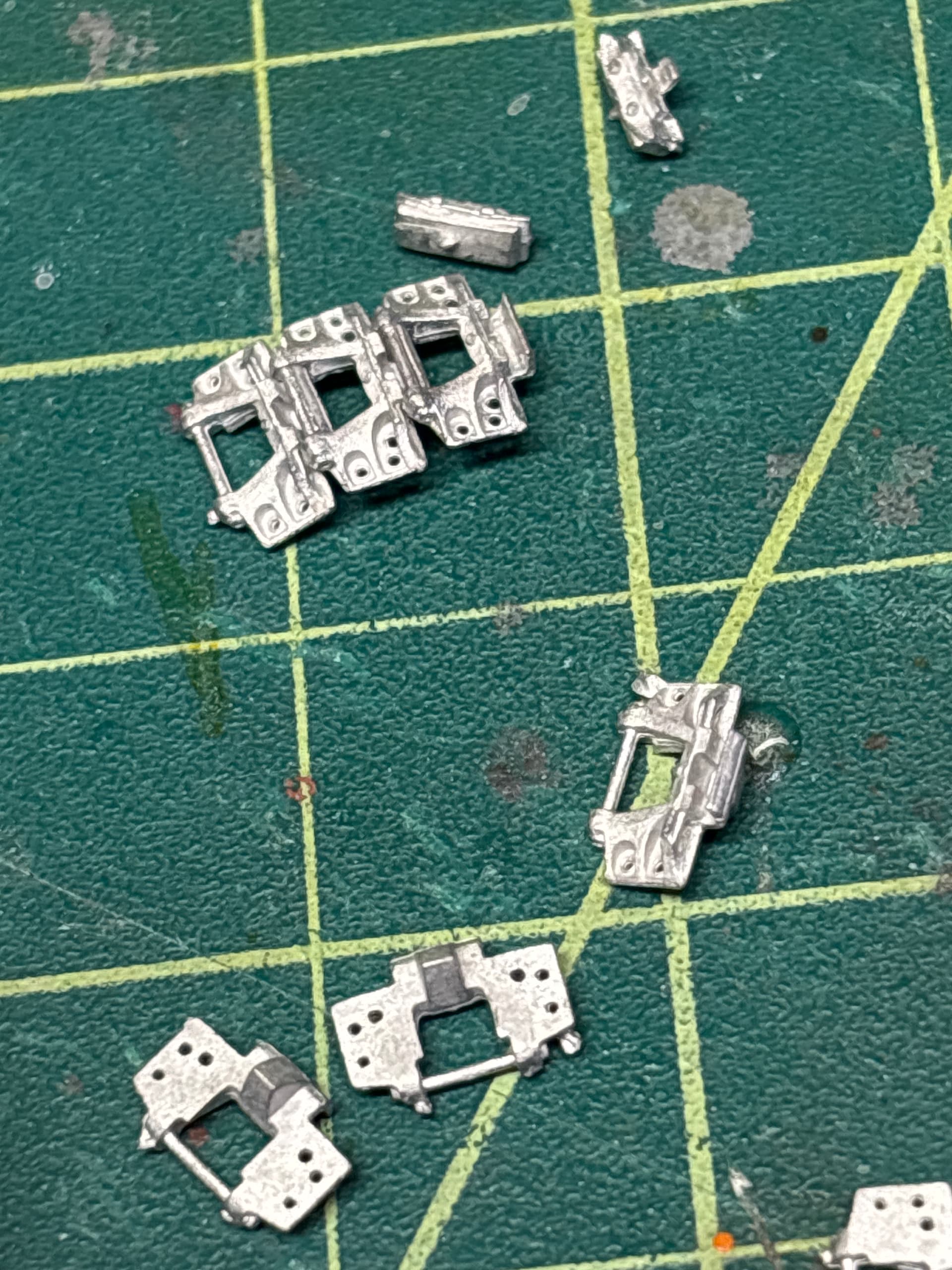

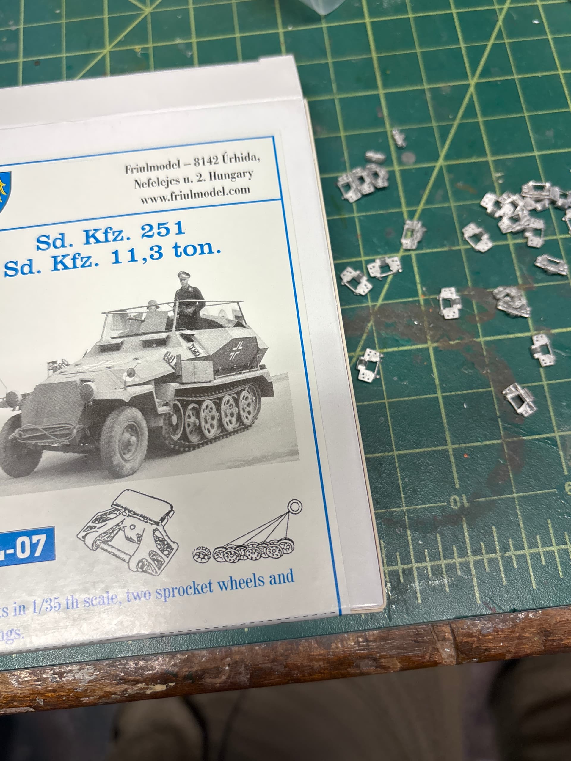

I just bought some of the friulmodel tracks for a couple 1/35 german halftracks, but they are unlike anyof their other sets I’ve used for tanks (i.e. no pins). As I have also found with their other sets, the instructions are not the greatest either. Has anyone here assembled these and can provide some tips? I tried finding something on youtube but only found videos of regular tank track…nothing halftrack related. Wish they could provide either better instructions or better drawings.

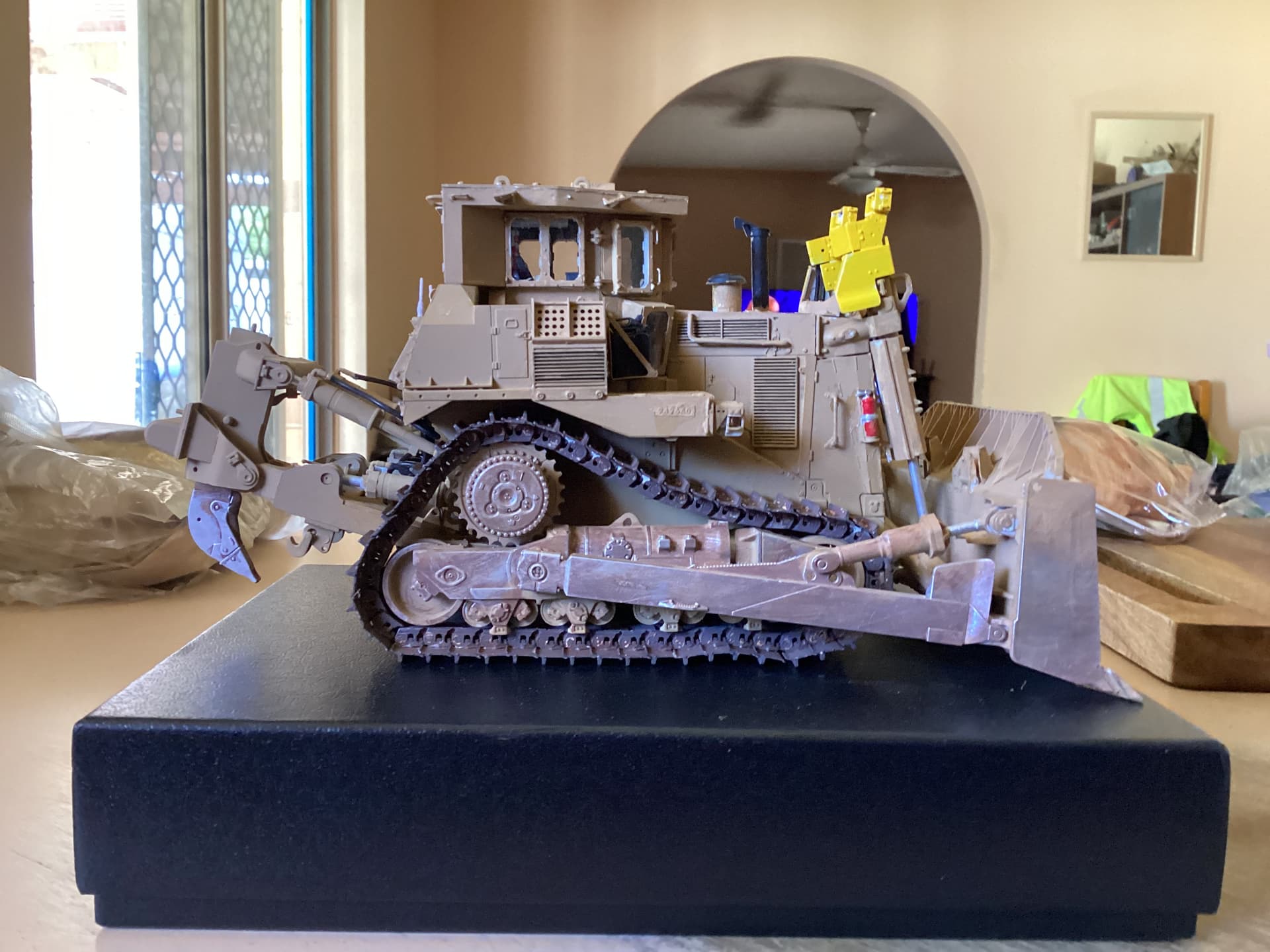

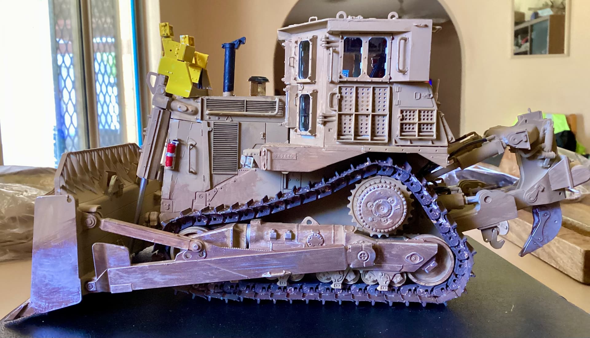

I got some for a D9R Armoured Bulldozer there was no pins had to use Super Glue to put them together I made the mistake of putting them together first then burnished them because of the super glue some small parts didn’t burnish , I was told that if I burnished them first that would not happen they still turned out but I know next time. I found that they went together the same way as the ones that came with the model you just use small amounts of CA glue.

Possibly? I don’t see where there is much to crimp. Almost looks like the pad is supposed to go over the join and hold the link in place. Just seems really fragile to me.
I’ve done resin ones that just snap together like that. The pad friction fits into the track trapping the one inside. It leaves them “workable” when done, no glue required. I haven’t done the metal ones, but they look almost identical.
Yeah,I’ve never dealt with that type either,but I have heard of them,thought it might be that type.
I found a solution I think. Same concept you mention,
but I have to superglue the pad down to hold tracks together
