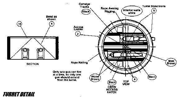

TURRET: Cast resin with white-metal cannons and lots of PE brass details. The instructions are thorough on assembly and painting. The turret has one small air bubble which will disappear when I glue the turret to its recessed hole in the hull.

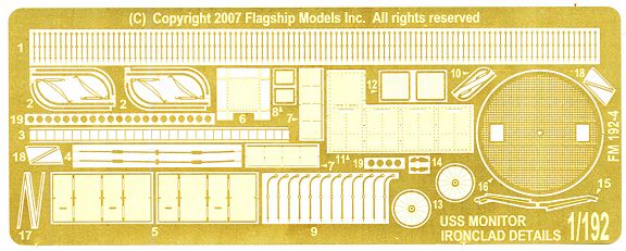

PHOTO-ETCHED PARTS: Extremely well etched with excellent surface detail (rough surface and/or rivets) where called for.

Sounds great. How does the kit represent the top of the turret? The recent recovery of the turret itself has produced some revelations about that point.
For some reason, can’t find it on their site.

Since a picture is worth a thousand words, here’s a scan of the PE fret:
http://www.mostlyclassics.net/monitor_fret.jpg
And here are the instructions for the turret:
http://www.mostlyclassics.net/monitor_turret.jpg

Here’s a link to the interesting discussion about the turret roof that we had here in the Forum last year: /forums/1/598128/ShowPost.aspx#598128
The contributions from ronmariner are particularly worthy of attention; he’s actually studied the turret firsthand. It looks to me like the new kit’s interpretation of the turret roof is defensible. It apparently doesn’t depict the individual, perforated iron plates, but does depict the grating in the form of a photo-etched brass part. In that earlier Forum thread I speculated that the perforated plates on top of the grating might have been a post-construction modification. I haven’t come across any more info about that point than I had last year, but if that supposition is correct, the representation of the turret roof in the kit is right - at least for the earlier part of the ship’s brief career.
