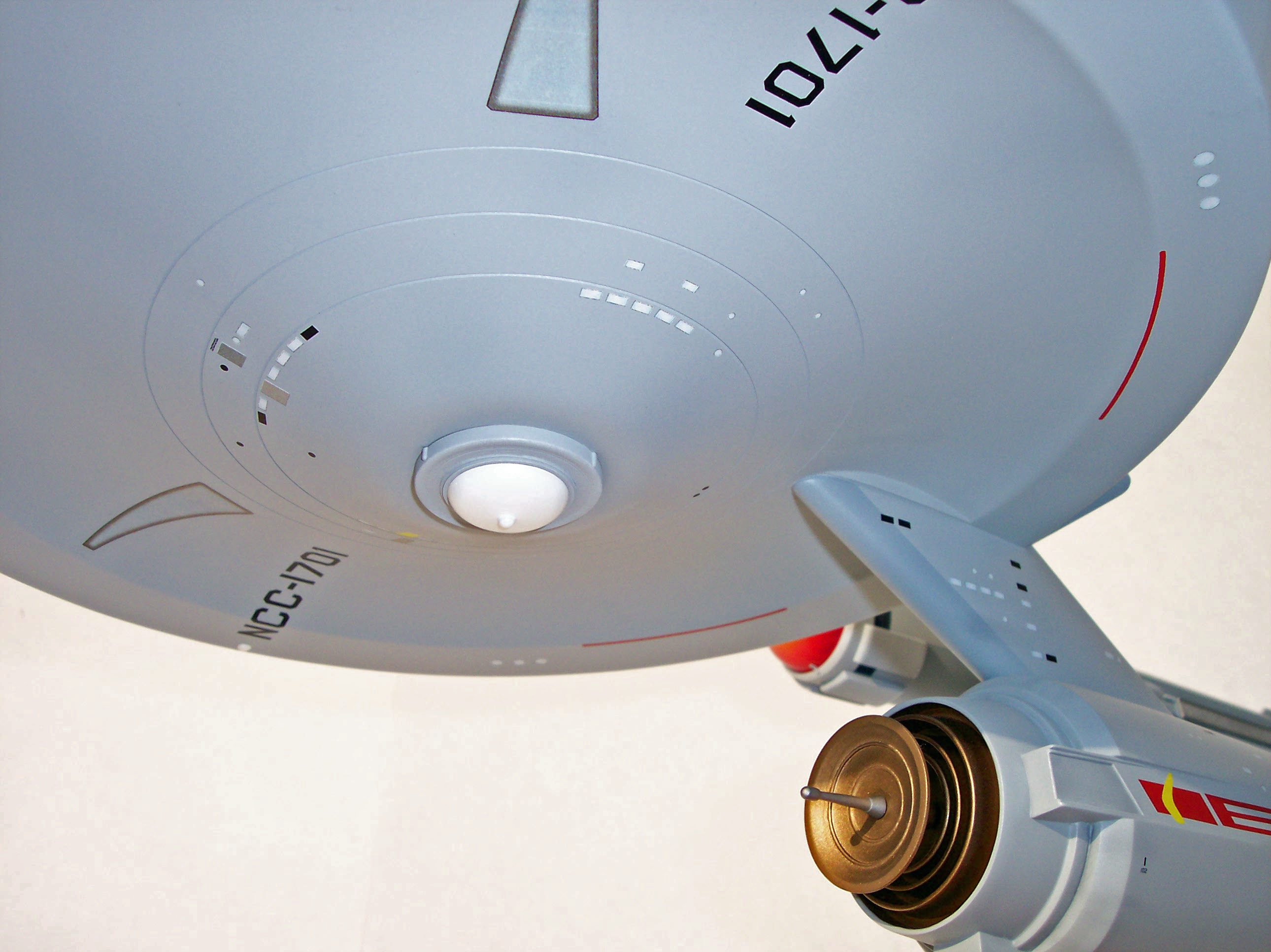

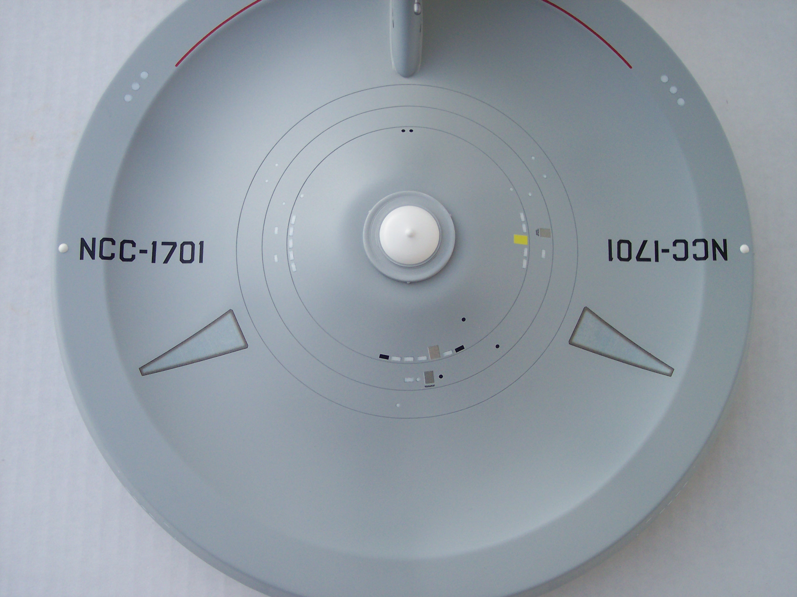

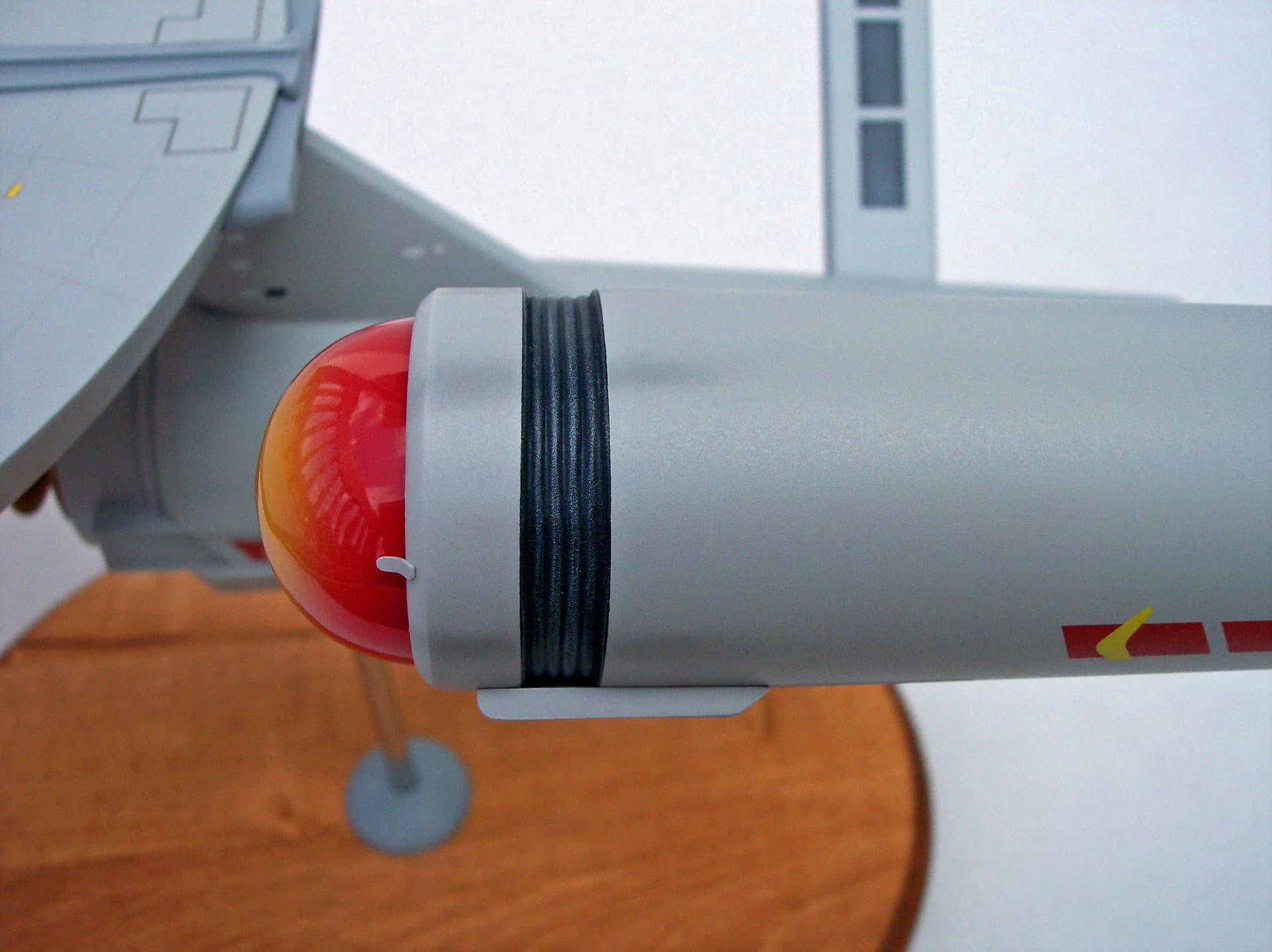

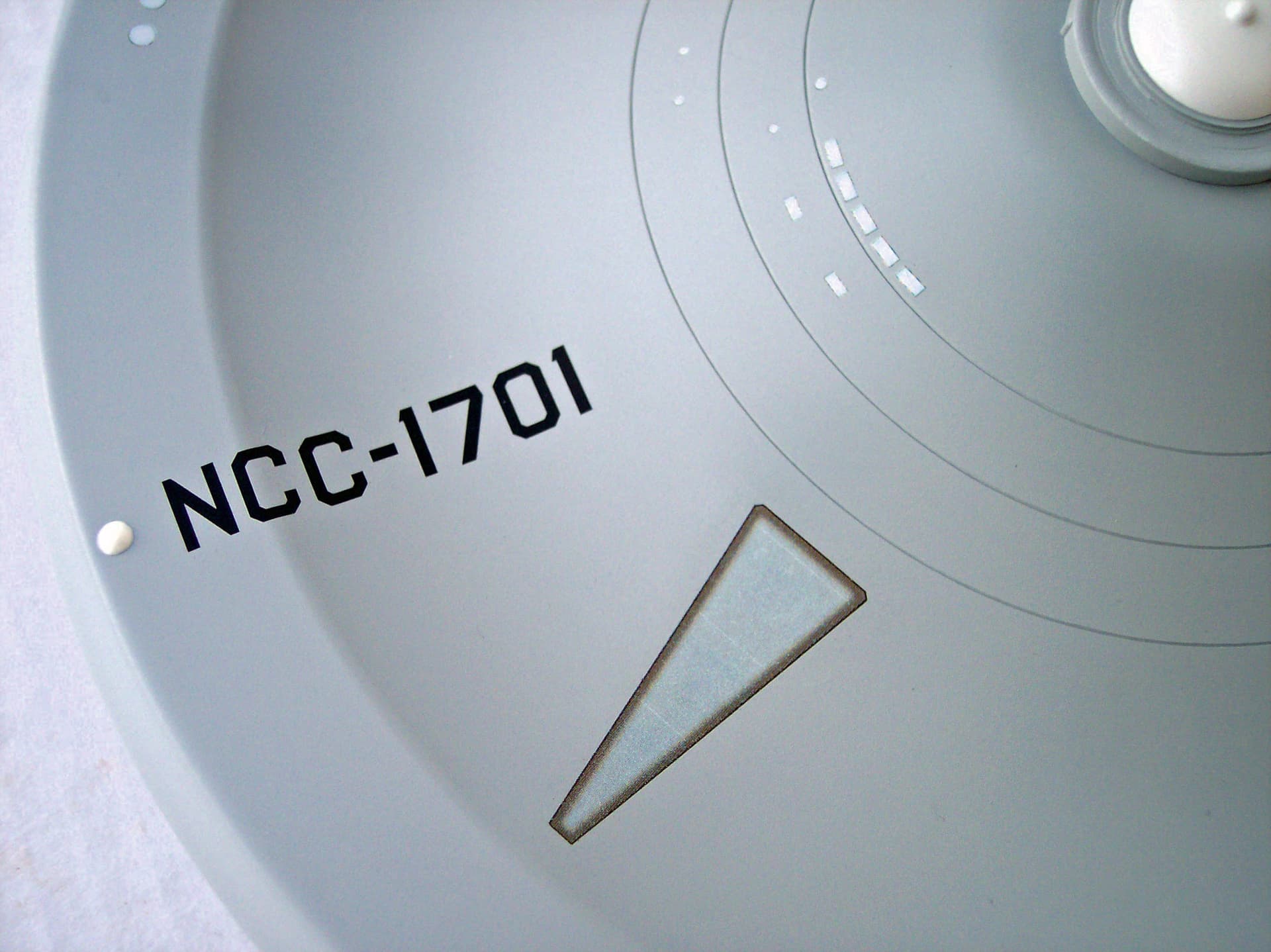

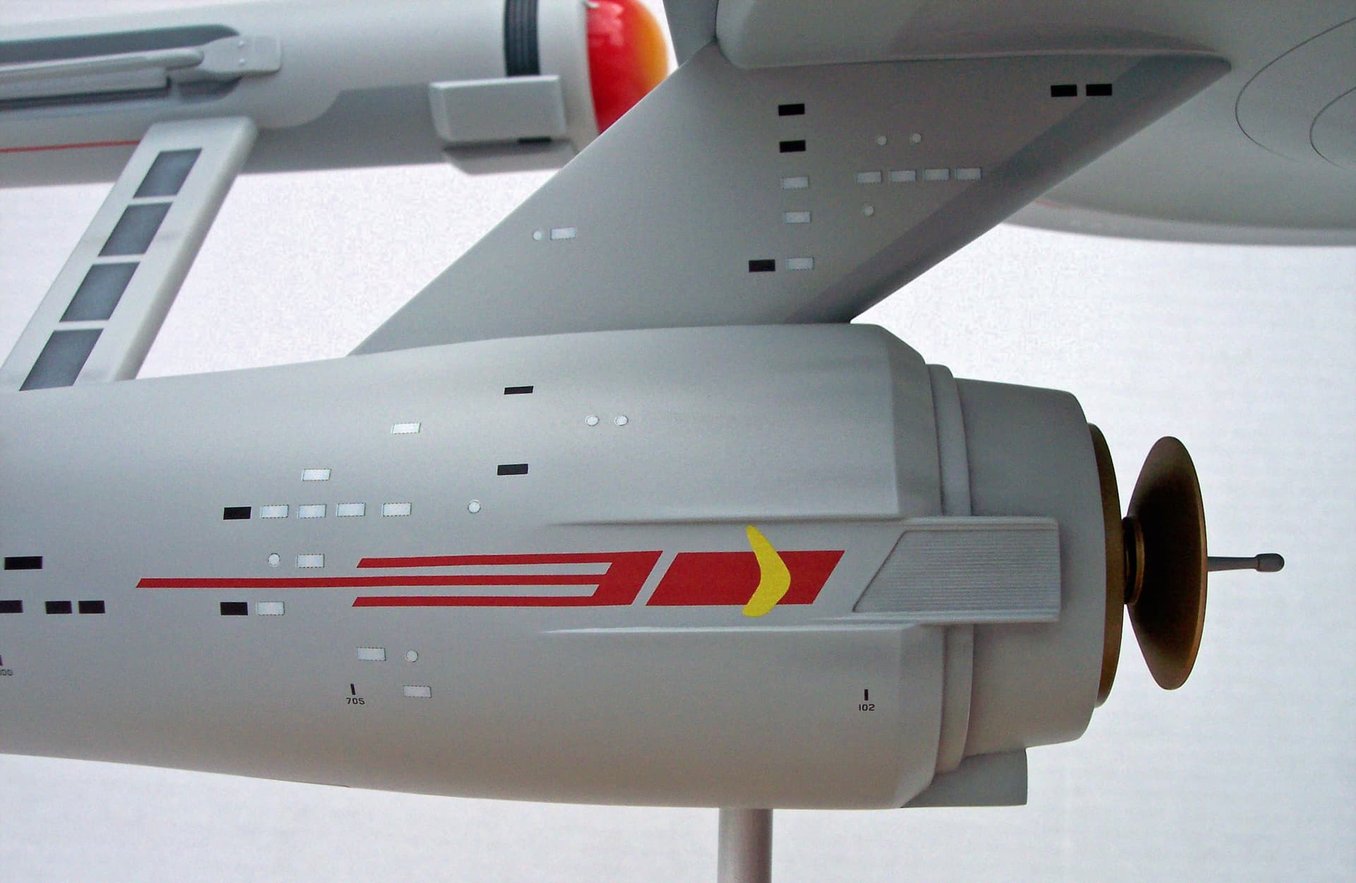

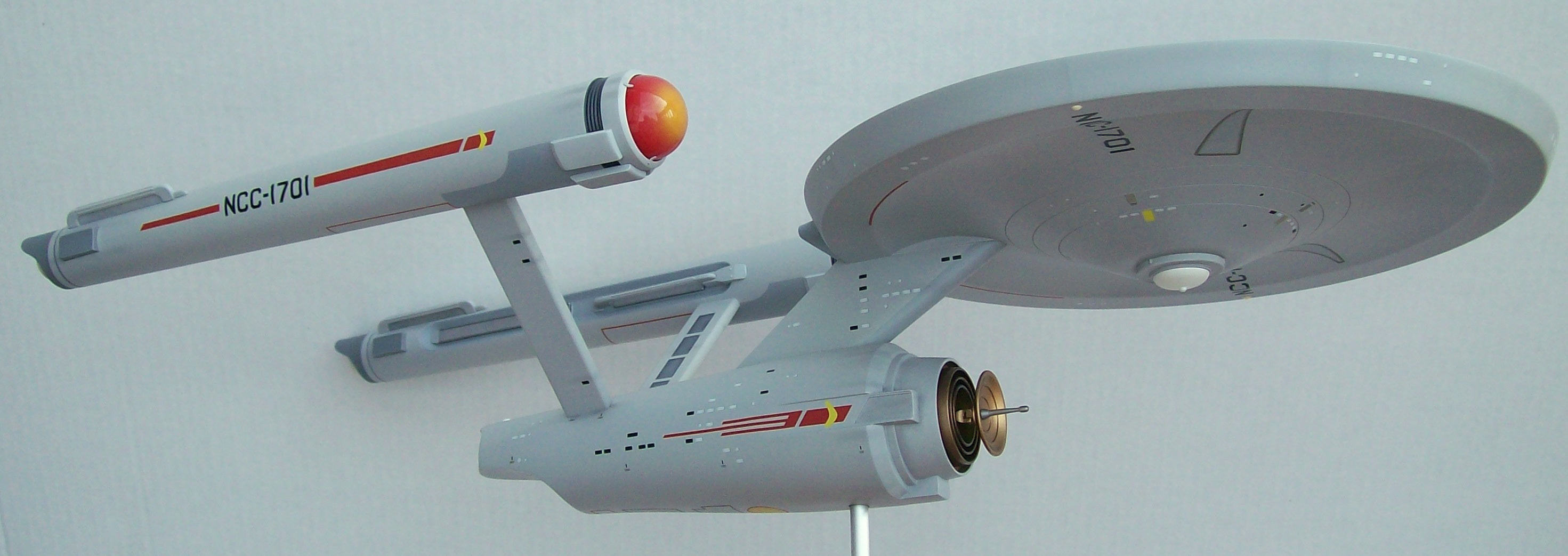

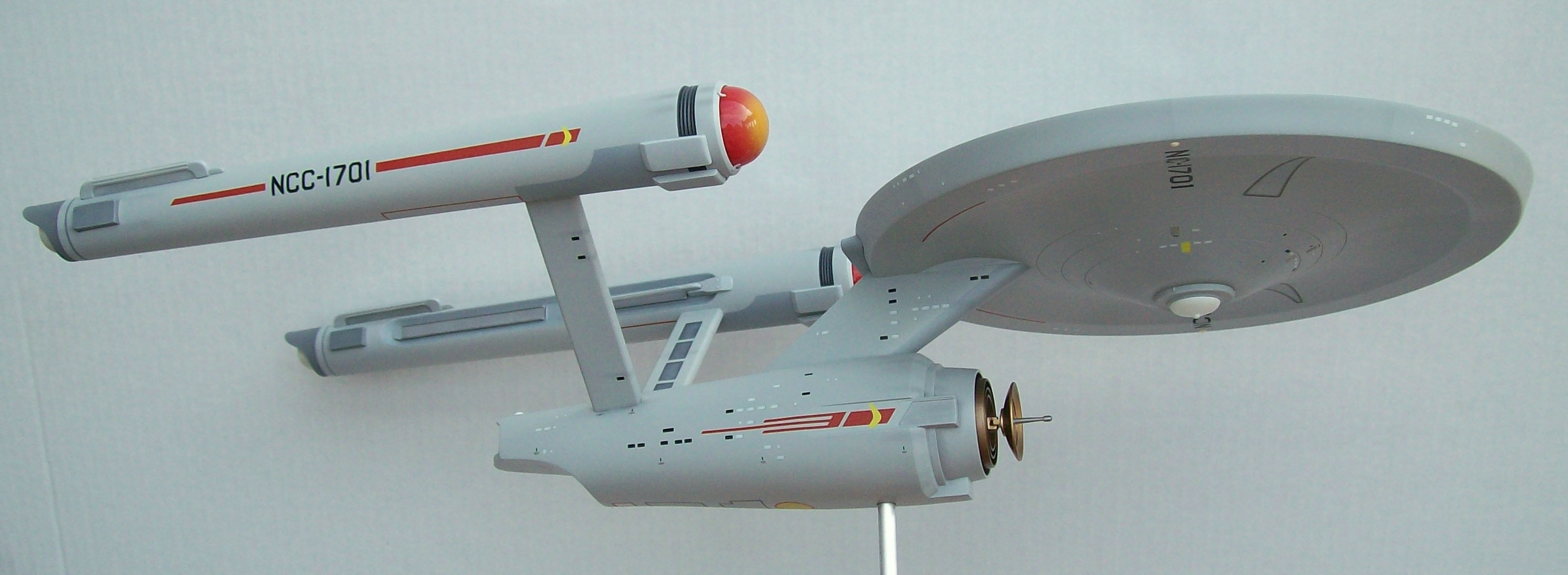

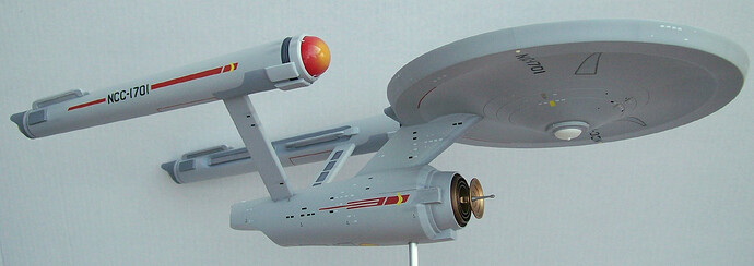

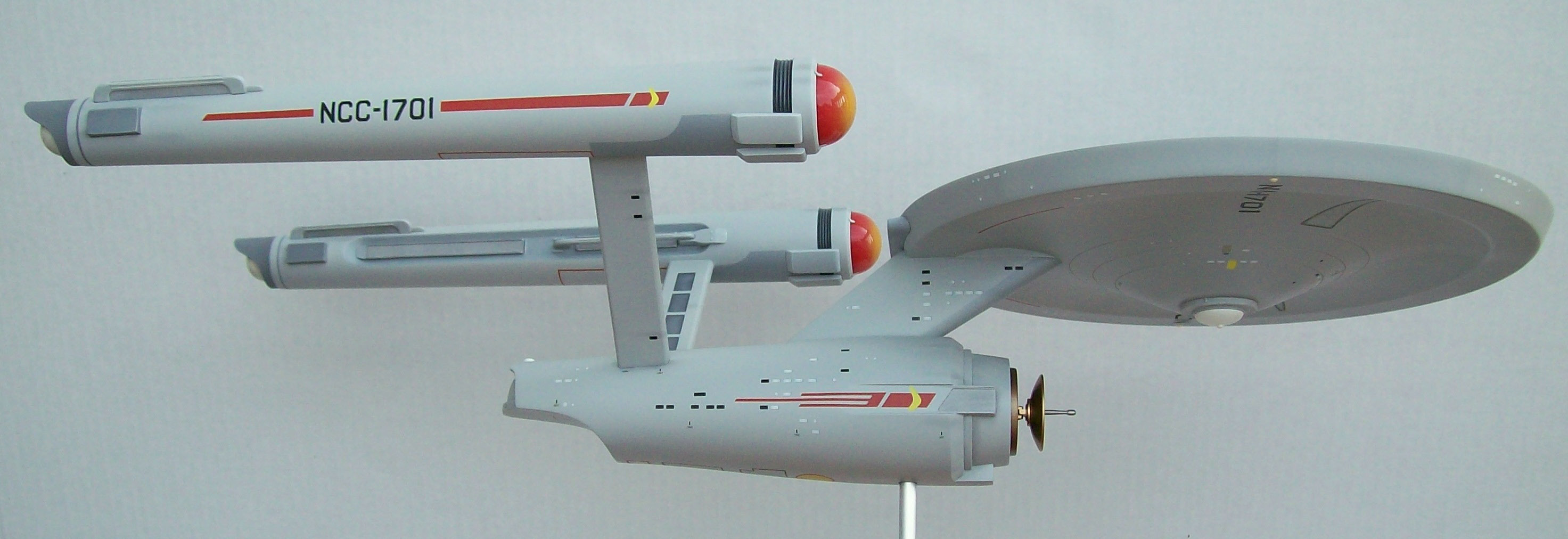

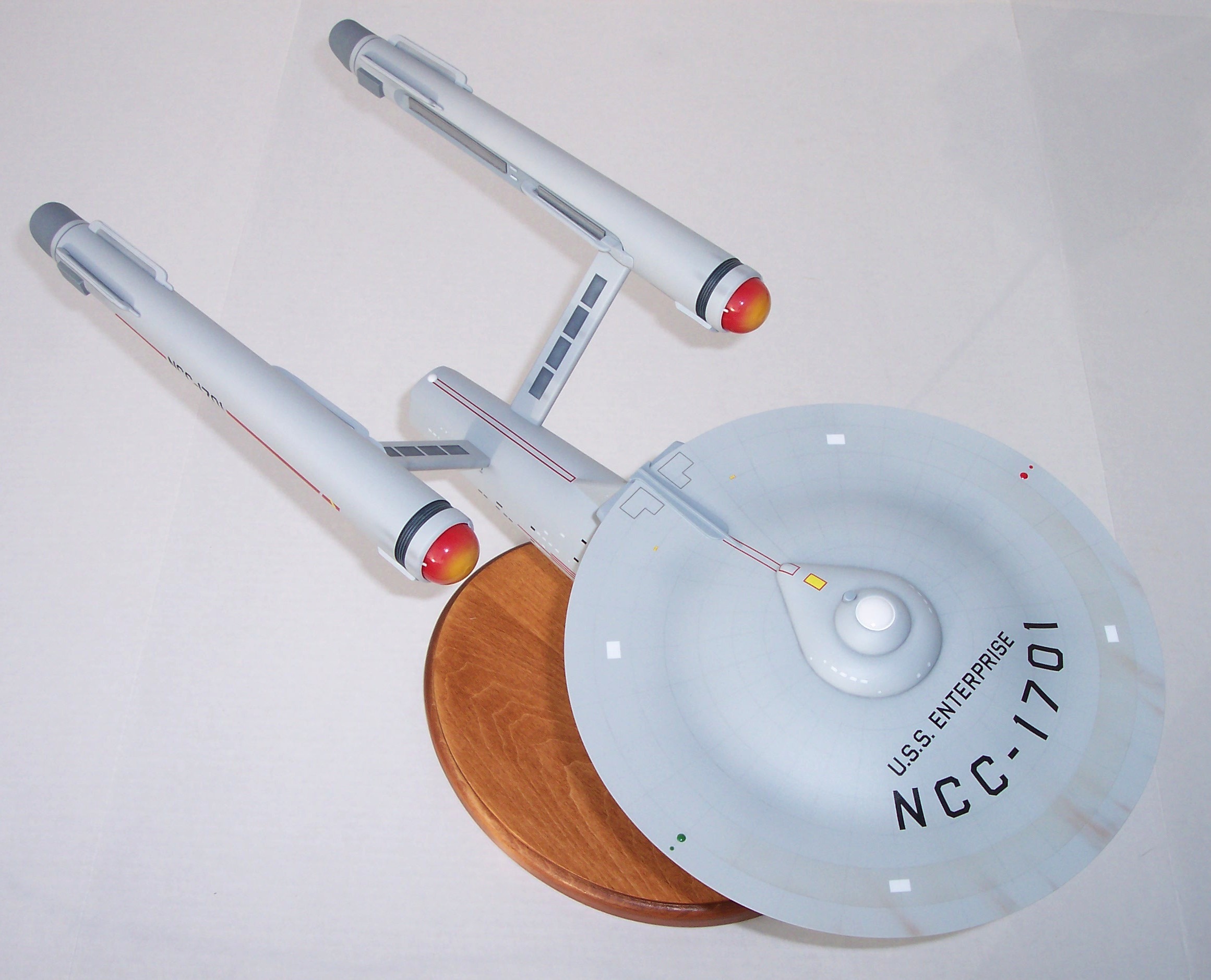

Fellow Modelers,

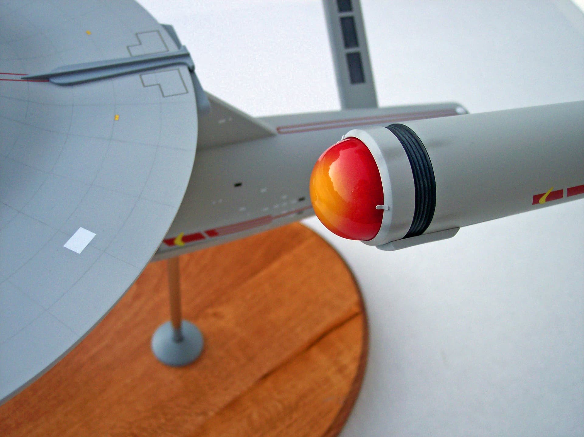

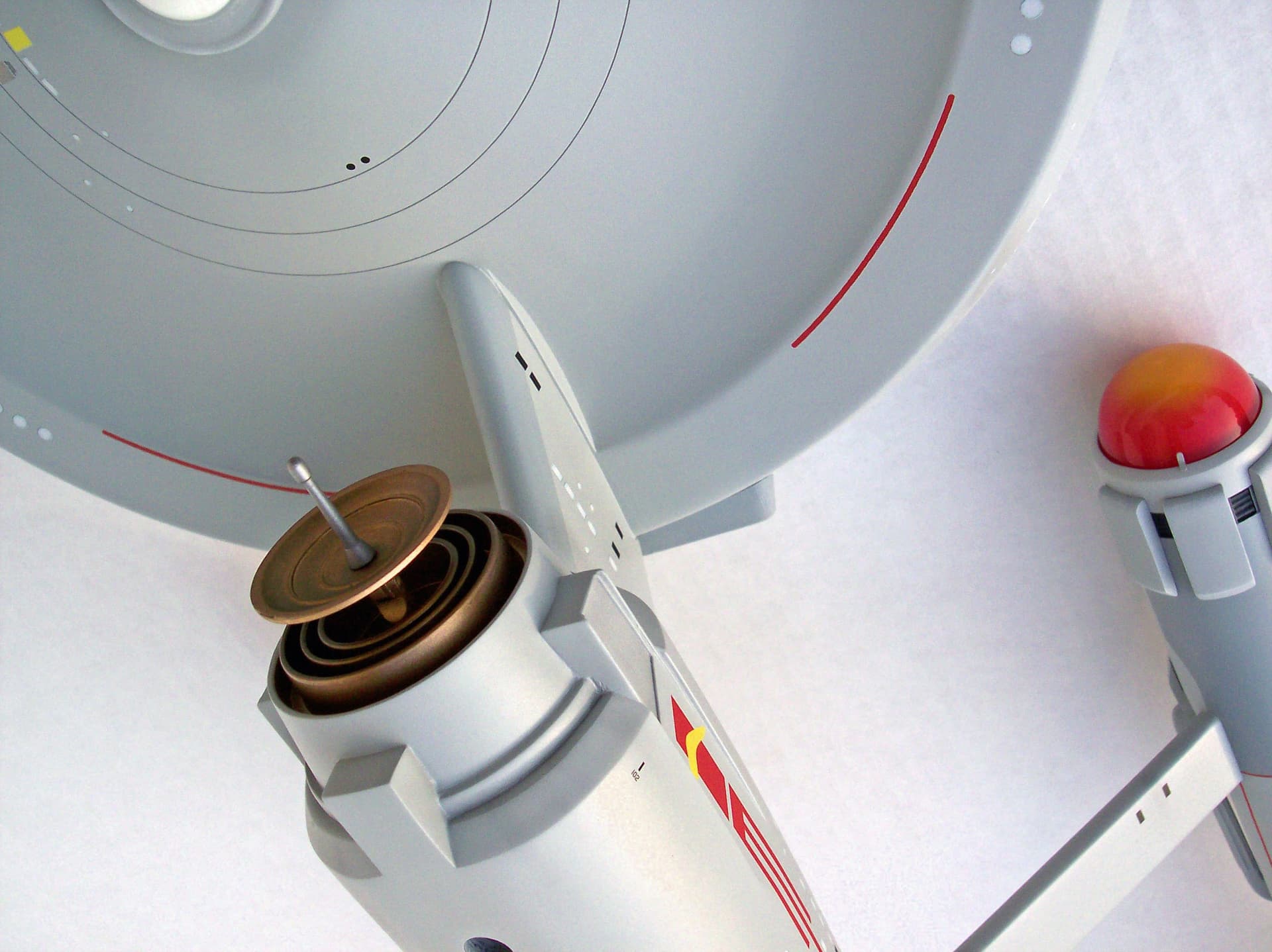

Attached are photos of ERTL’s 1/535 scale (22" length) Star Trek U.S.S. Enterprise built in 2009. To help make the model more accurate I used DML’s after-market resin set, two different decal sets from JT Graphics and Creature Art’s clear warp engine front caps. I think this kit is much more accurate than AMT’s 1966 18” offering, but still has many incorrect features that require a good bit of work to correct. Mating up the “cut-a-way” sections was also a grinding chore.
I used Model Master paints almost exclusively and they did not have an “out of the bottle” color I was happy with for the base color. Therefore, I made my own by using two Model Master Grays (Model Master Light Ghost Gray/1728-23% and Model Master Light Gray/1732-77%). Weathering was added by randomly airbrushing several different gray washes, as well as using light-brown and medium-gray pastel dust. Several light coats of Future were applied at 50psi to seal the decals and give the model an overall satin finish. I hope you enjoy the photos.

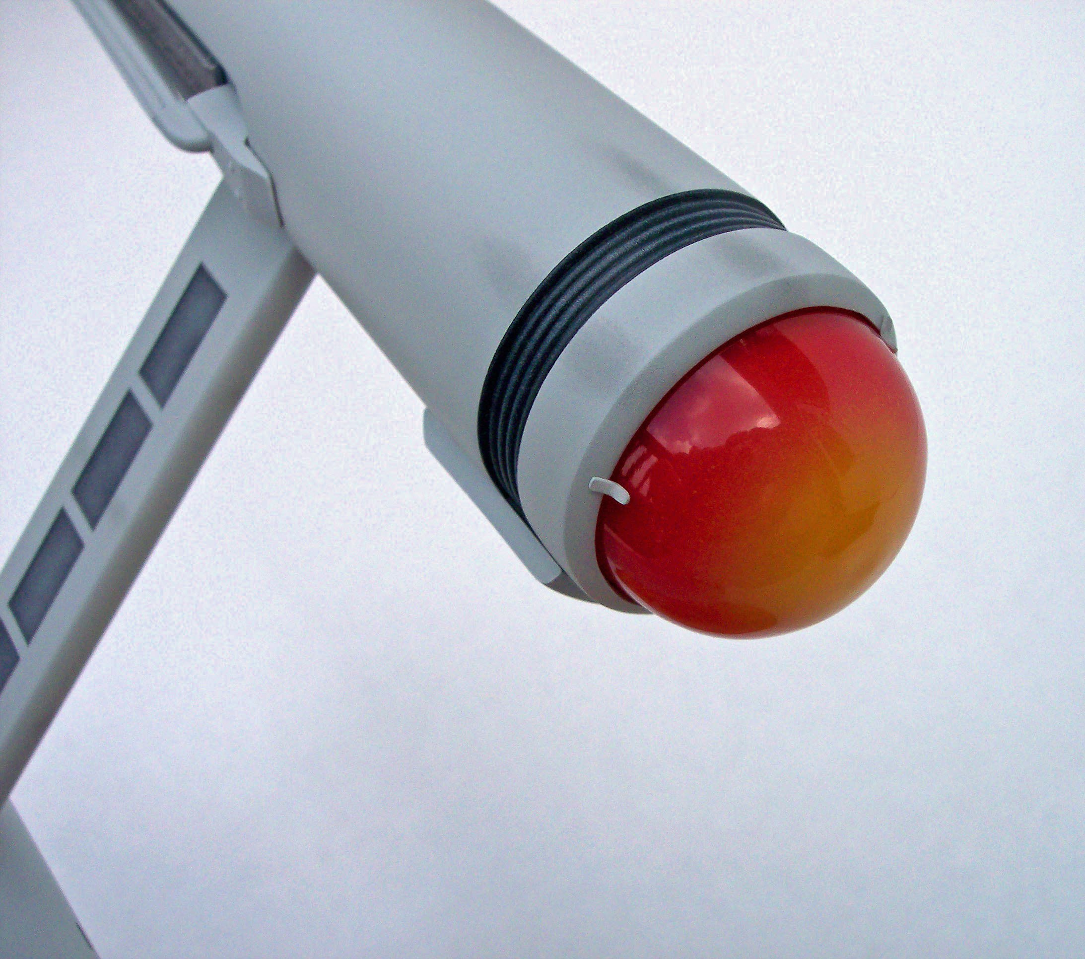

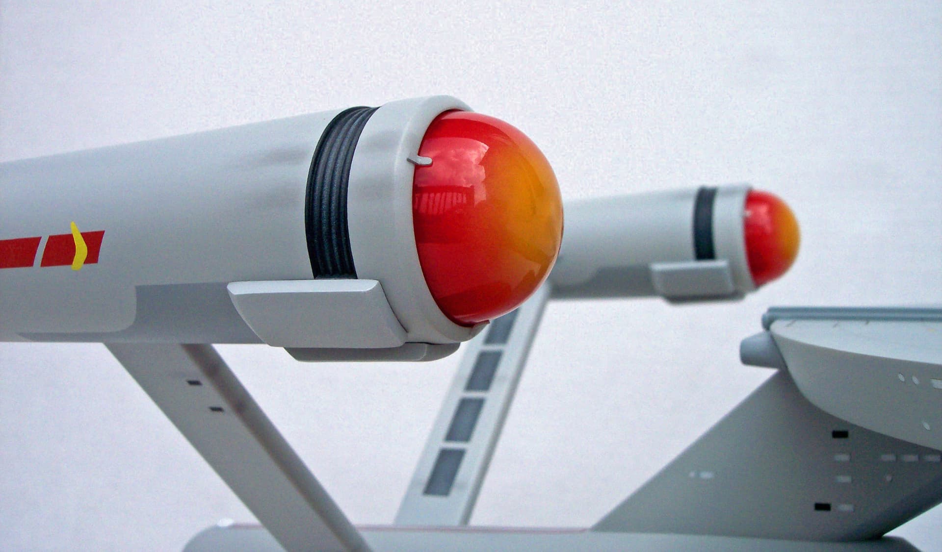

I like it. Did the engine caps come already painted, or did you do that color scheme yourself?

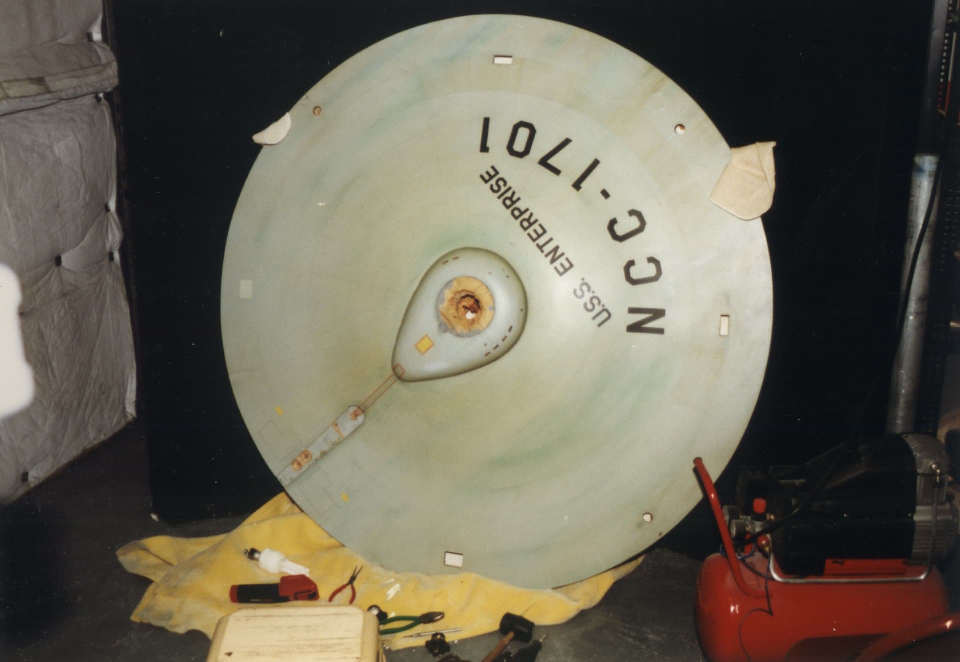

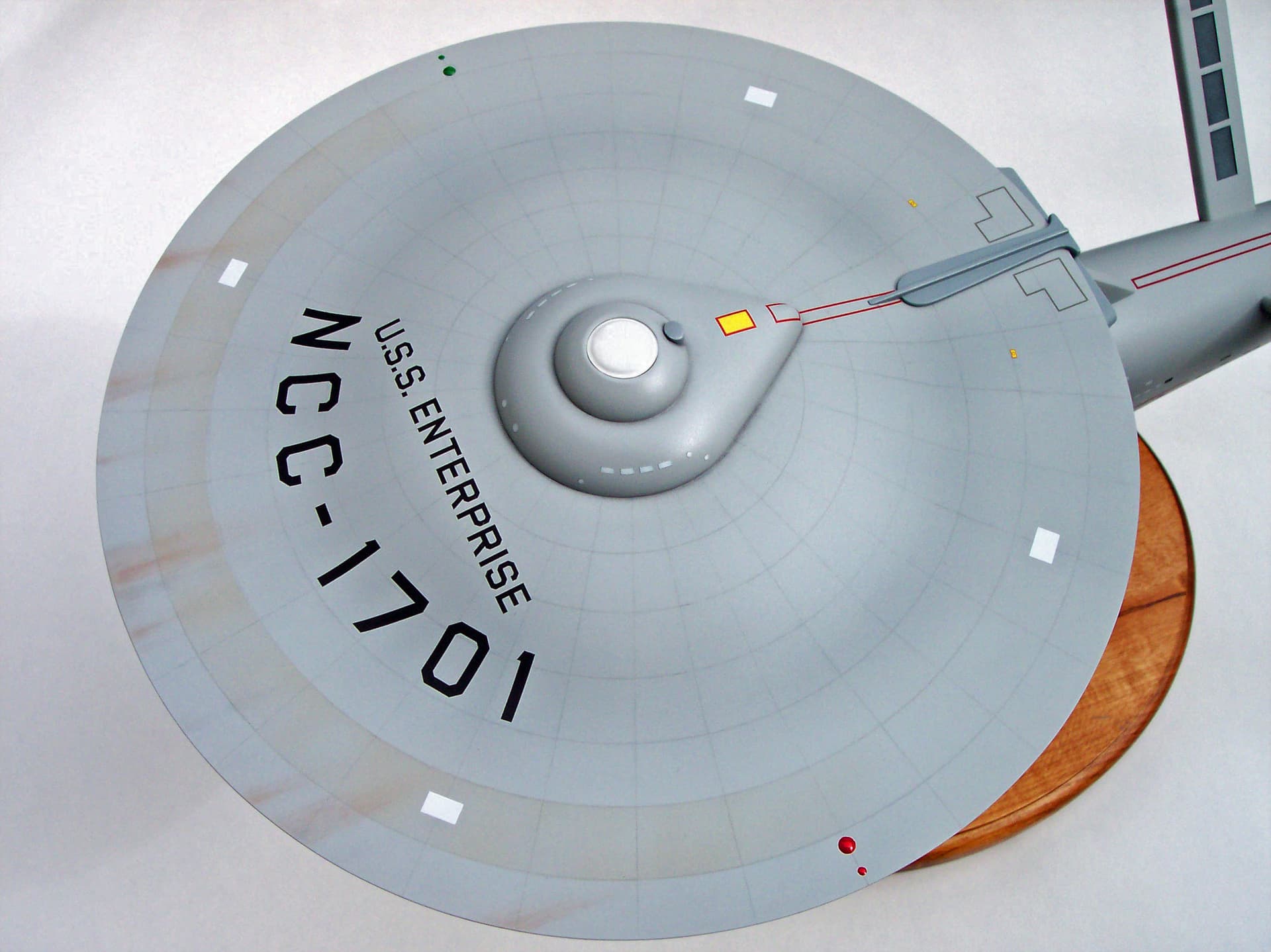

I’ve always wondered about “weathering” a starship, what was your plan of why the ship would get that dust where it did?

Oh, hellyeah. Gritty enough to look in service and give mass to the scale yet not so dirty that it crosses into the SW universe.[Y]
I consider that very nicely done.[H]
That is possibly, the best Enterprise I have ever seen.
Your detailing is perfect. If it’s not canon it should be. It all “fits” with what the ship should be.

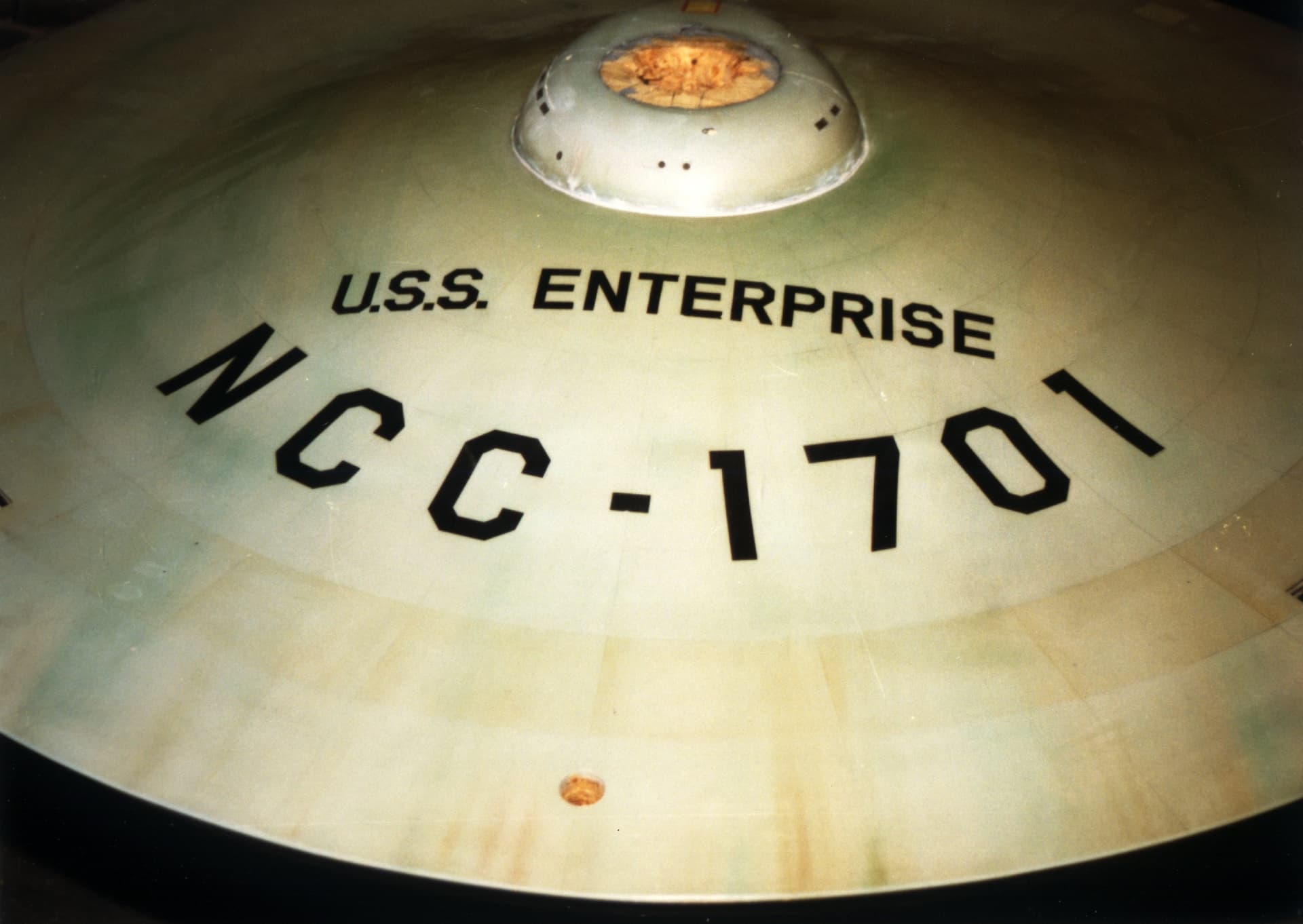

Paul-Concerning the weathering, I was just trying to duplicate what I had seen in photos of the 11ft. miniature. My understanding is that for the 1st and 2nd Pilot the ship’s finish was “clean”, but it was weathered before regular season shooting began. This weathering included the “brownish rust ring” along the front of the saucer section. You might not be able to see it on film, but it was there. Below are two photos taken of the Enterprise in December 1991 after Ed Miarecki received it from the Smithsonian Institute to be refurbished. When he was given the contract he was given severals rules to follow. One of the rules was that under no circumstances was anyone allowed to mess with the top of the saucer section, as it was the only part of the model that was still in original condition when the series ended in 1969. In additon to the weathering, it is interesting to note that the pencil grid lines are also very noticable. That is just what I have read, but I know there are other people that are alot more knowledgeable than me about this subject. To be honest I probably used less weathering on my model than was on the 11ft. miniature. The Creature Arts nacelle caps came crystal clear and were really nice. I sprayed flat yellow in the inside middle area, and then flat red around the edges. I know it is not what the lighting effect looks like, but it addes dramatic color and was easy to do.

Really sharp work! Love the subtle pre-shading [ht]

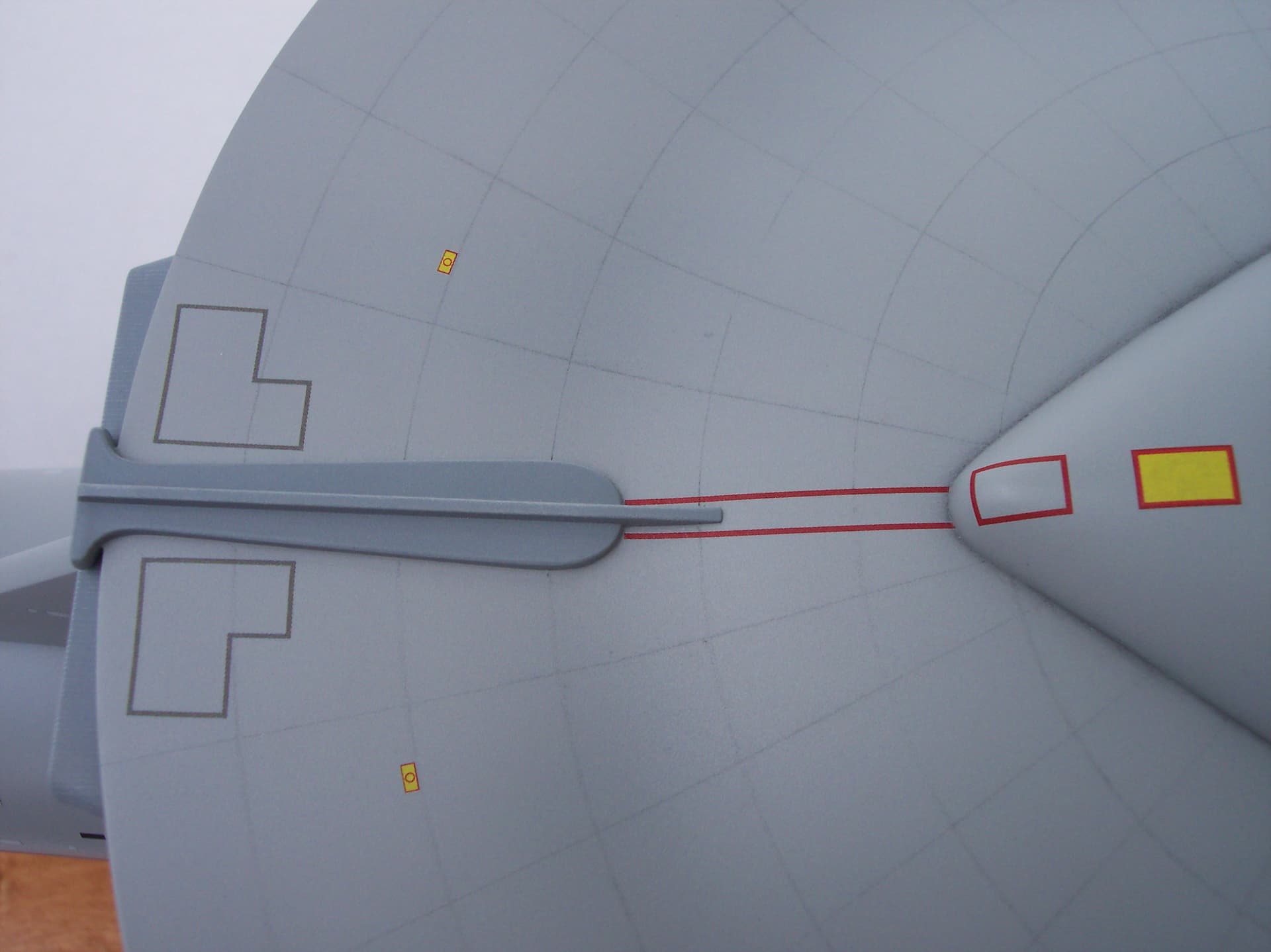

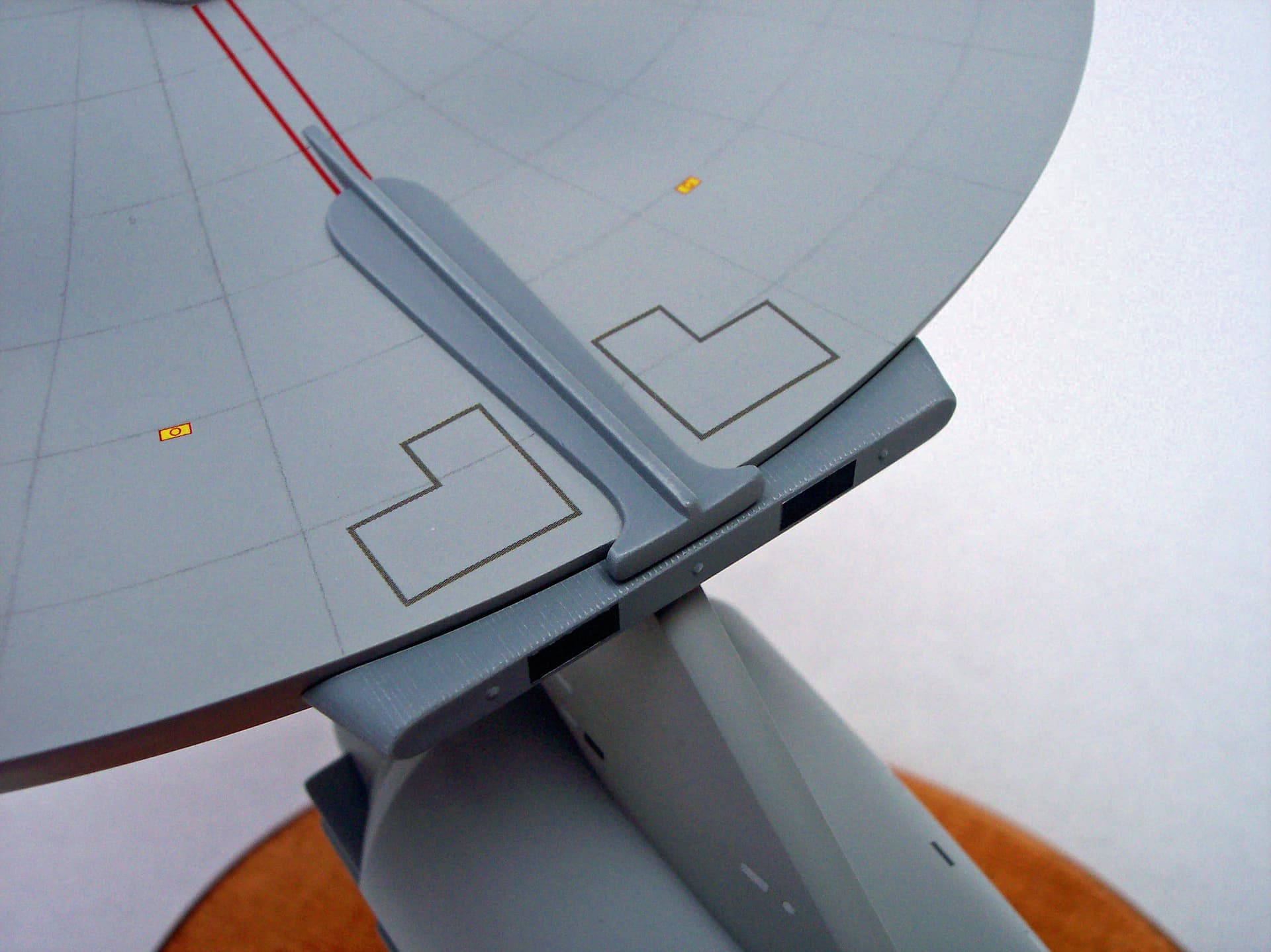

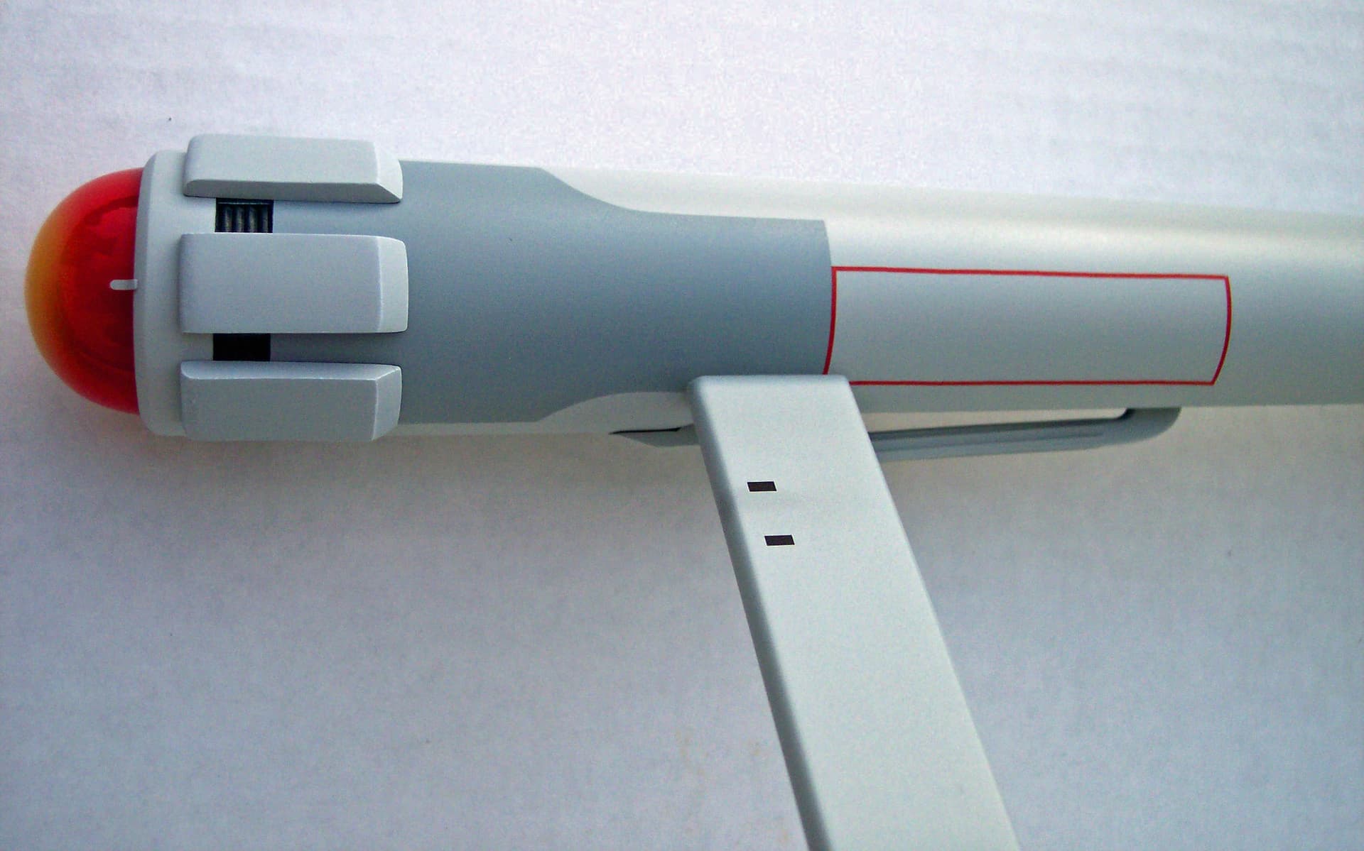

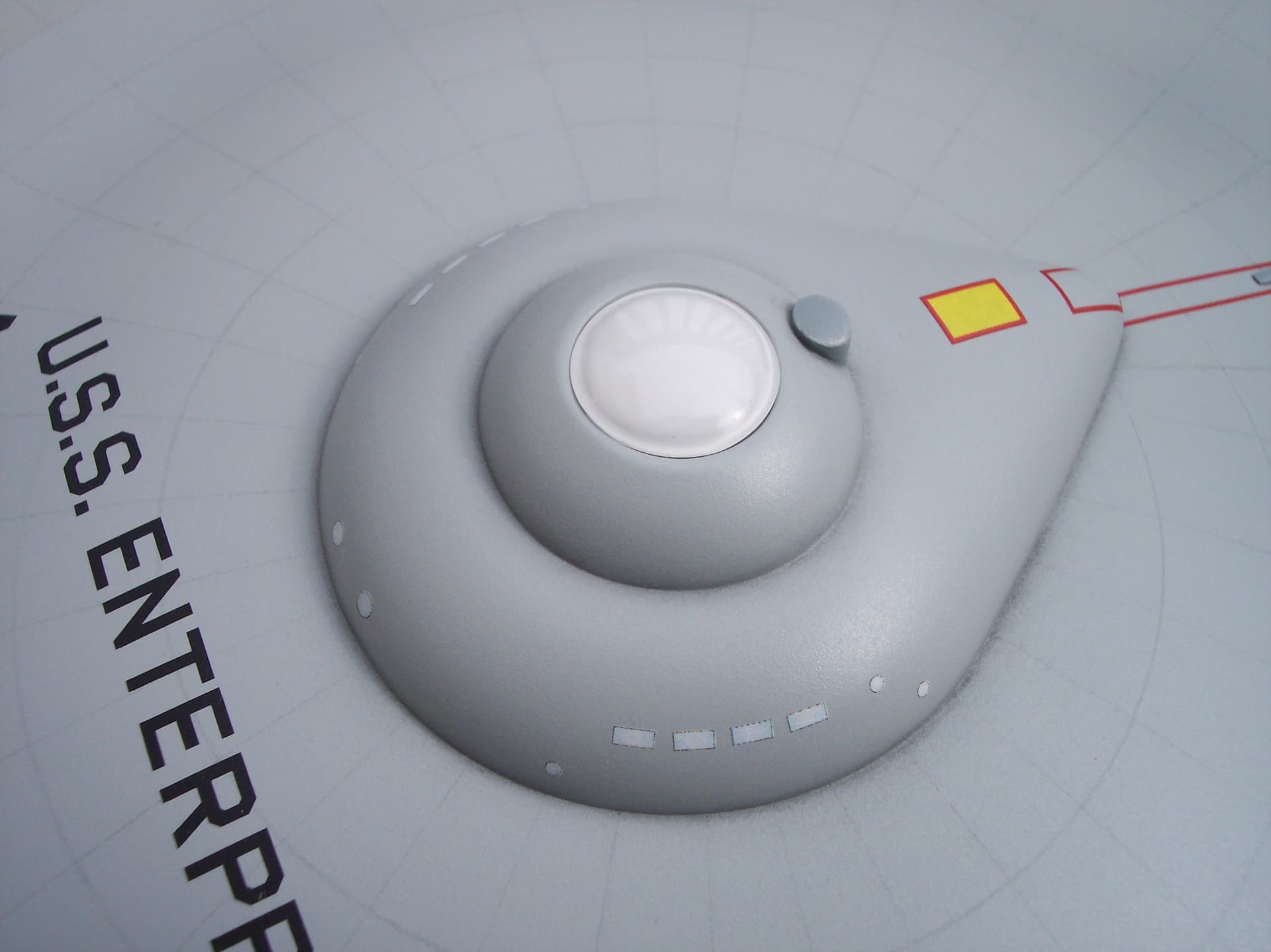

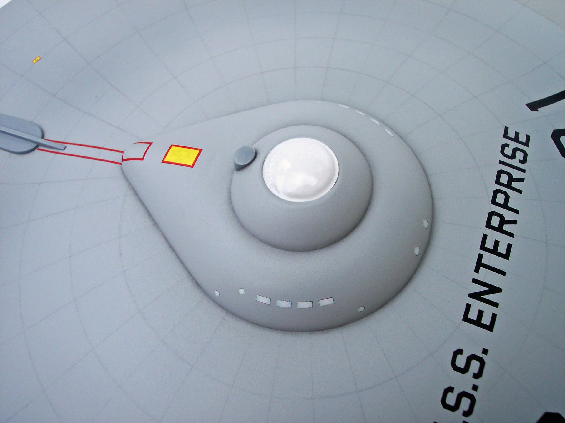

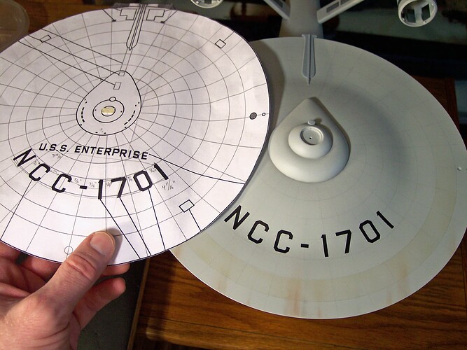

Fabulous Work! How did you do the grid lines?
Again great job!

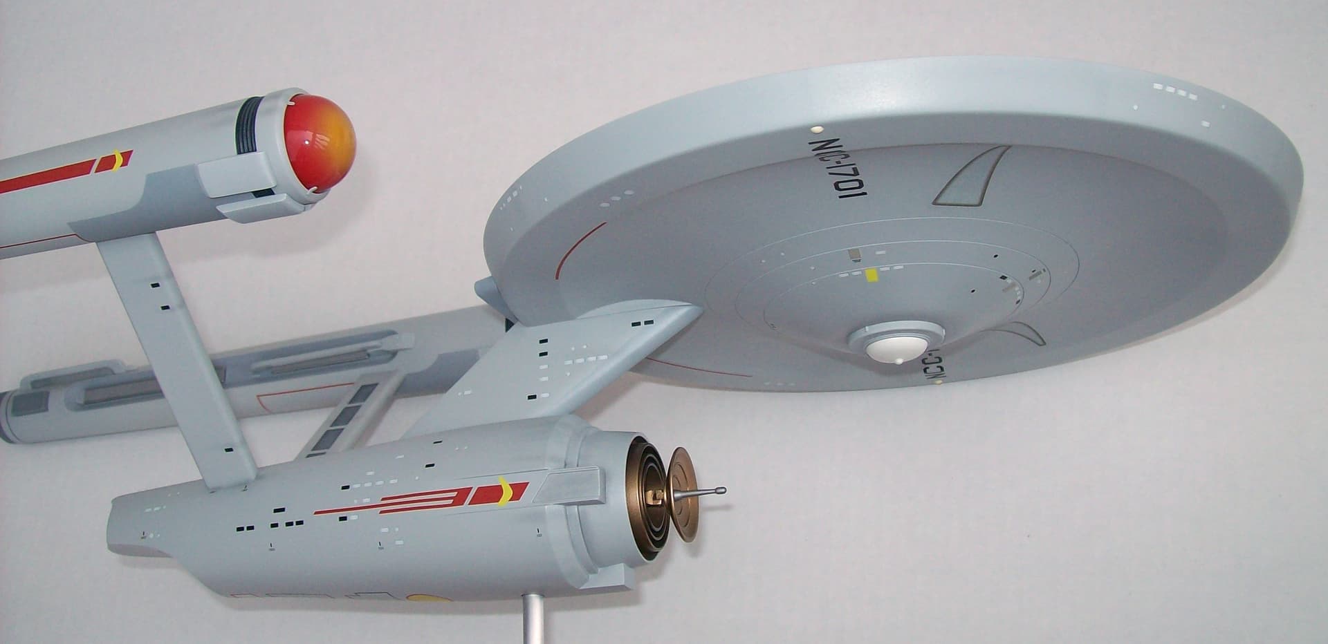

In the new pics your grid lines have gone, angle and light I guess.
And I love the ambre effect on your nacelle caps. Very effective!
Gerry-The panel lines are still there, but they are harder to see from a distance and at the angles the pictures were taken.
justimagine-Concerning adding the panel lines, first a paper gridline template was sized up on a copier to match the model’s saucer diameter (see photo below). The spacing between each vertical line was determined by dividing the saucer diameter by the number of vertical grid lines, then using a pencil to mark each location. The same steps were done around the bridge section. Then a 1/4" wide strip of masking tape was laid between the two pencil marks. Lines were then drawn on with a mechanical pencil. A school compass was used to draw the circular lines. The key for doing this was making sure the anchor hole was located in the exact center of the upper saucer section. After this was done I thought the lines were too dark, so I pressed masking tape on the lines. Doing this made the grid lines very faint and finally achieved the effect I wanted. These steps may sound difficult, but they were really more tedious than hard. Also using a pencil gave the flexibility of being able to erase minor mistakes.
