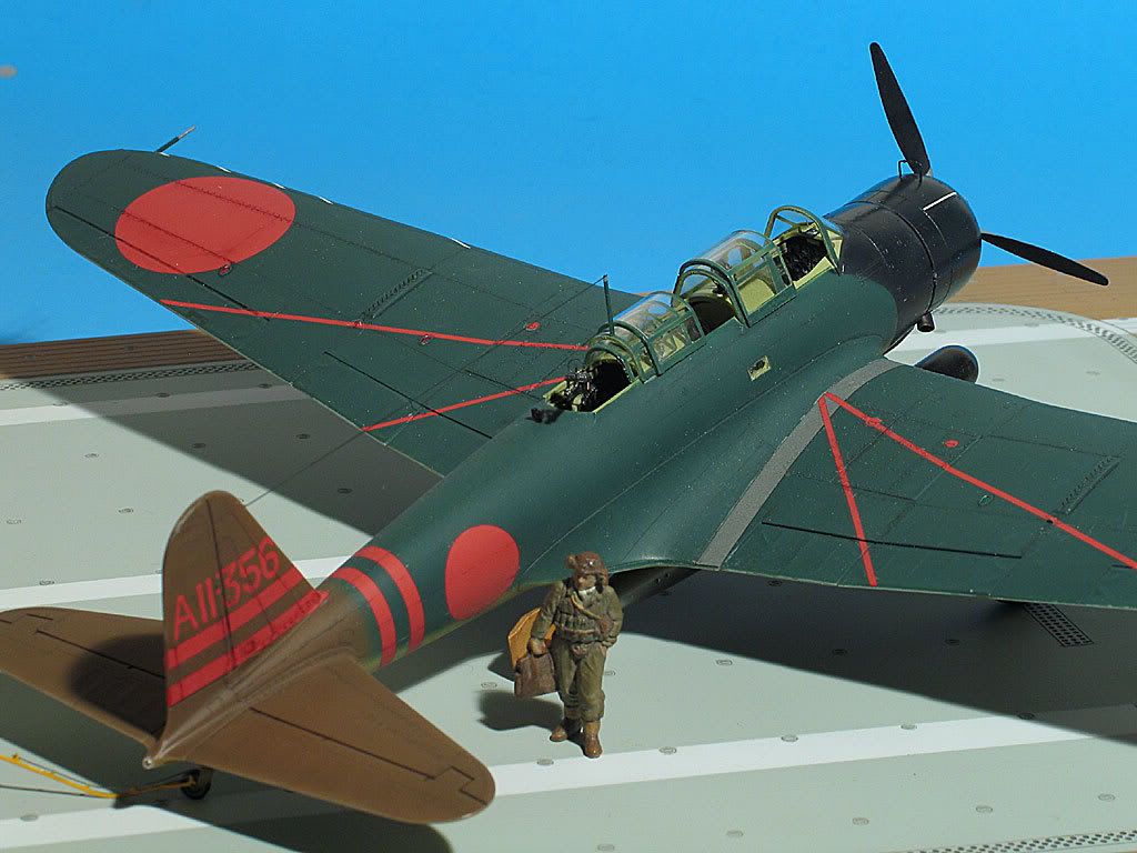

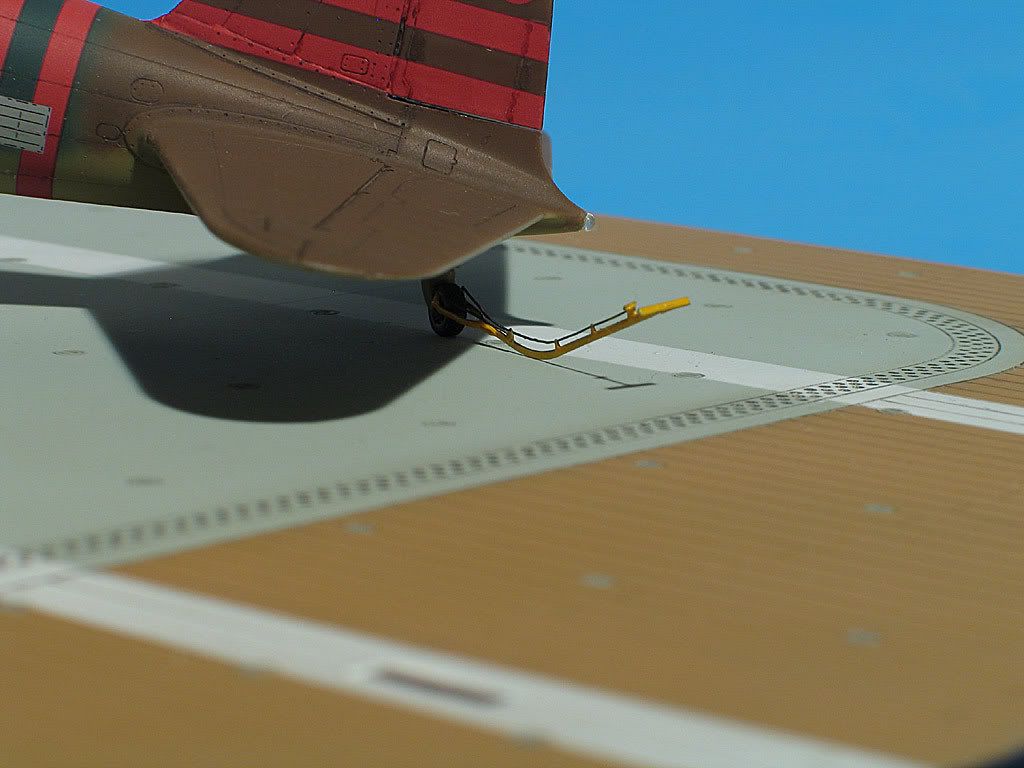

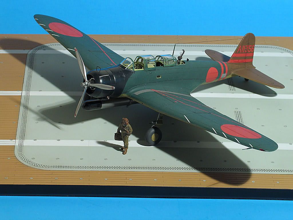

This is my 1/48 Hasegawa B5N2 Type 3 “Kate.” I built it using Eduard’s PE detail set, and painted it with WEM (White Ensign Models) Colourcoats enamels and Alcad metallics. The flight deck is injection molded, and from Eduard. I scratched the wooden fins on the torpedo from sheet styrene. The pilot is from a Fine Molds D4Y “Judy,” and appears to be a little underscals (or VERY short - oops . . . vertically challenged). I used the kit decals for the “Torpedo Command” issue of this nice kit. It was flown by Lt. Mitsumori Suzuki from the carrier Kaga during the first wave of the attack on Pearl Harbor. Eduard’s PE set included the tailwheel trolly, which is what prompted me to get the flight deck. I think it’s a nice little touch on Eduard’s part !
Please excuse the dust. My apartment seems to be situated over the center of dust production for all of New England !

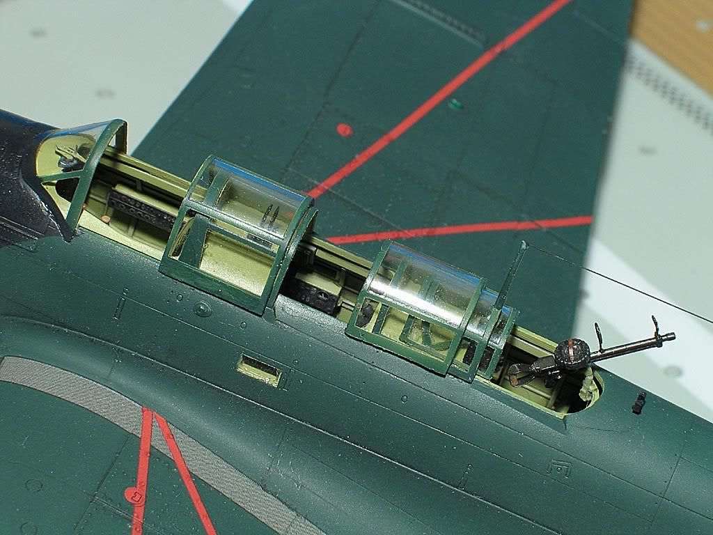

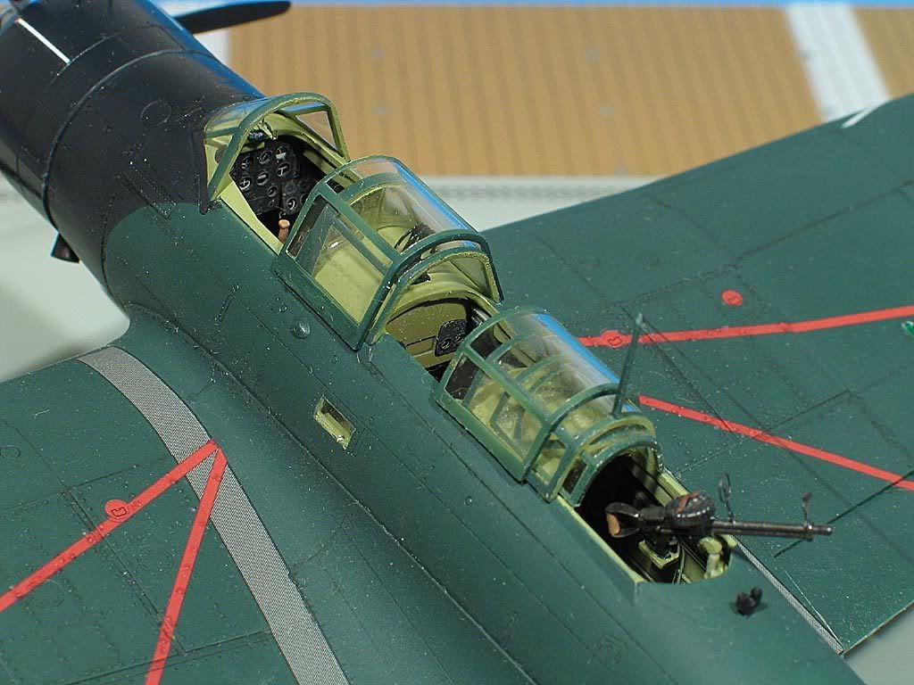

Very nice work. Your sectioned canopy turned out well. I know it was a pain in the a$%! I did the same kit and had fits with the canopy. Great job

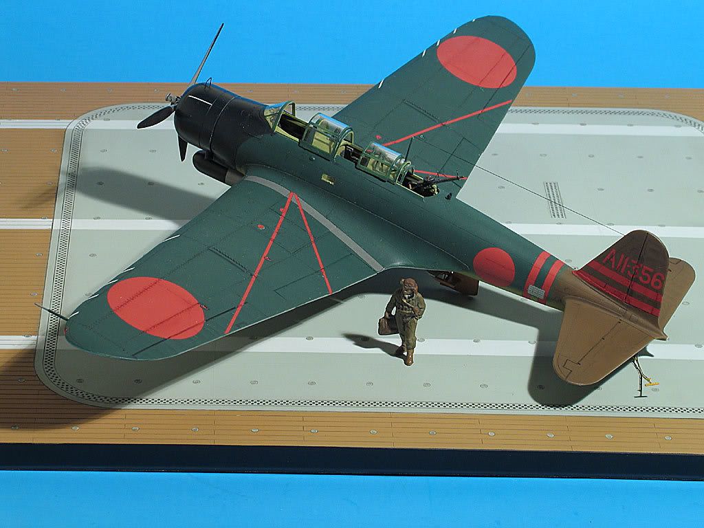

Another fabulous model. The diorama is simple, but very good and certainly enhances the basic model.

Wulf - the canopy fit very well, with the exception of the rearmost section (which is underneath the rear fixed portion). Dryfitting showed that the bottom of these sections needed to be sanded first. Everything else fit like a glove.
Marc - Eduard’s bases have excellent surface detail, and they can be found for under $10 each. I also got their USN carrier deck and PSP airfield surface. They’re molded in black plastic, which needs primer or a lot of paint to get good coverage. I primed this one with Alcad’s gray primer.

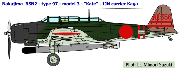

NICE JOB. I purchased this same kit just several weekes ago and am looking forward to building it. I am curious about one thing though, why did you choose brown for the tail? In pretty much all photos I have seen the tail is red on the Kates.

modelbuilder - Kate torpedo aircraft (and perhaps Val dive bombers) from this period from the Akagi (coded AI, single red stripe) and Kaga (coded AII, double red stripe) had their tails painted “China Brown.” Here’s a profile of this aircraft. The artist depicted the lower surfaces in Nakajima Navy Gray, but my research (at j-aircraft) suggests that it was Ame-iro instead:

I have figured out most of the colors in the White Ensign line but cannot find “China Brown”. What color did you use for that?
