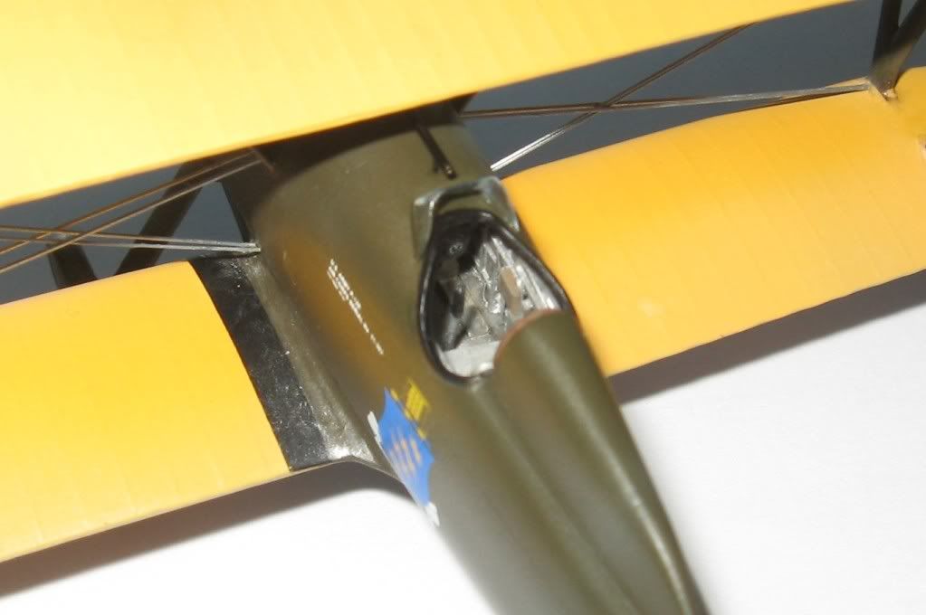

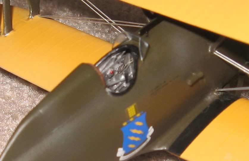

The kit was somewhat challenging, as the fit was not the greatest, a “tooling” error that had the interplane struts about 7mm too long had to be cut down! [8o|] and the trailing edge of the upper wing was very thick. I added Brass tubing for blast tubes and for the gunsight. The rigging wires were 0.3mm styrene rod.

Great work on the P-12 Mike! Did you assemble the whole model and mask it or did you add the struts and wires later? Seems like they’d be an incredible pain in the butt to mask around.

Added struts first, then painted wings USAAC Yellow, then masked the wings, then painted Olive Drab with a touch of brown. The maskings was pretty easy, except for the lower wing roots.
Fantastic work especially on the yellow. Looks like you got great coverage without it gettting too thick. Getting Yellow right is always hard for me and it looks like you nailed it! [Y]

I used Polly Scale Orange Yellow FS505220. Sprayed light coats, then gloss,decals, then a coat of satin for the top wing surfaces, gloss for the lower. Also, added some white to the tops to simulate sun fade.
