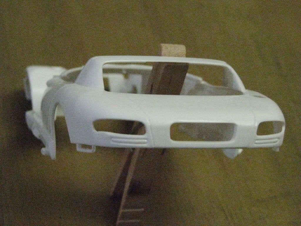

What is the general concensus on here on what to use to fill sink marks? For instance on the Viper I am doing, one of the rear tail lights is slightly deformed, as in its too big of a hole. What can I use to fill the hole in a bit so that I may sand it down or reform it later? Thanks!

How well would regular Bondo, like from WalMart, work? If you look at the picture, you can see that the drivers side tail light looks pretty bad. Its supposed to come to more of a point as it goes towards the front of the car. I’ve read that the Testors and Tamiya puttys can both make the plastic soft because of the solvents in the putty. And I’ve read the Squadron putty isnt the greatest either. I’m kind of stuck at this point in the model because I’m ready to start on the body paint!
