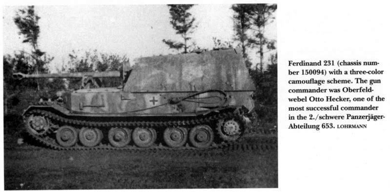

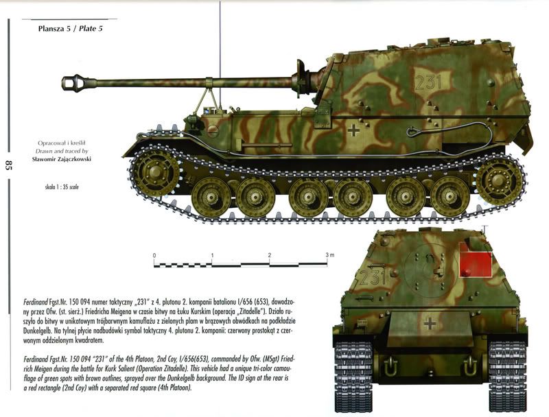

I’m also wondering if anyone has pictures of vehicle #231 of 2 kp/sPzJgAbt 653. It’s my other possible marking option for my Ferdinand, but I’d like to see what the camo scheme looks like. I know it’s green blotches but a good picture would still be very nice, if anyone has one.

…the rear of 231 shows a large rectangle in red w/ a smal box on the upper right and 231 duplicated on the left side…my refs say it was Meigen’s vehicle…
Yuppers! Manstein is correct! [:D]
Scott, thanks for that color plate! That (almost) hard edged camo is too cool, I think I’ll be doing this vehicle.
Does anybody have photos of the other side of 231? I’d rather not invent the pattern if I don’t have to.
…note that two different refs portray this vehicle’s scheme slightly different…
Yeah, but photos of Ferdinands at Kursk show very crisp and opaque camo patterns, much different from the usual misty patterns seen on German armor. While I appreciate the color plate Kykeon provided, I tend to think the one espins posted is more accurate, from the one photo I have of 231 (although maybe the edges of the camo are not quite that sharp)
I agree Hermisminiatures. The profile I scanned seems pretty accurate, although I would soften up the lines just a tad when it comes to applying it.
This is the only picture I could find of #231, hope it helps.
There is only one photo of 231 on page 157 of Combat History of sPzJgAbt. 653. I would also agree that the color plate Espins posted appears to be more accurate than the one I have. I’d post the photo, but it is probably the same one you already have.
D’oh…it’s the same one Scott just put up. [:P]
heh heh heh
