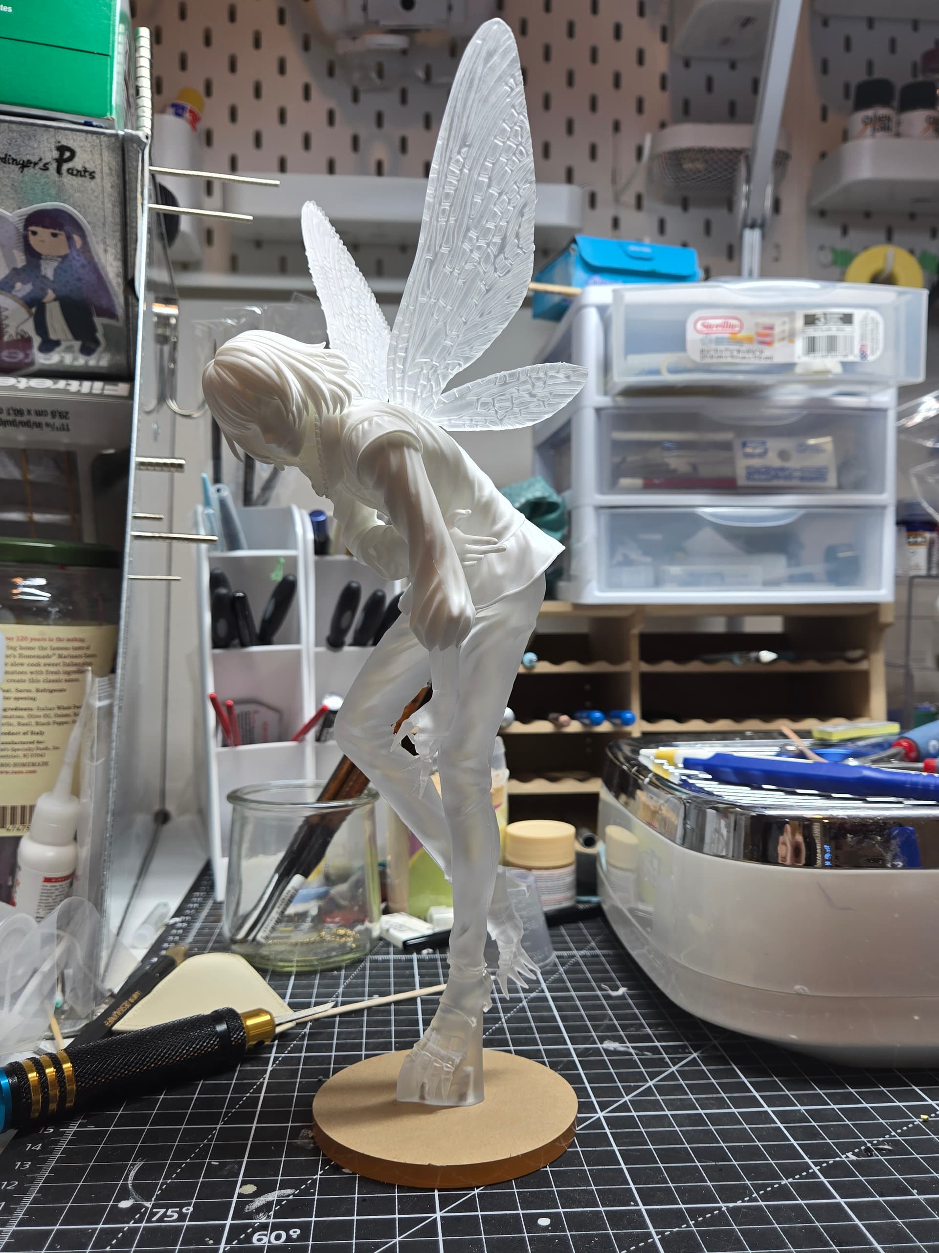

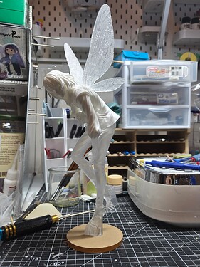

Temporary assembly. Pinning was pretty easy, and the collar was stuck on using 1mm magnets. The casting was pretty good, so surface prep didn’t take very long. I polished the clear parts using 400, 600, 800, 1000, and 2000 grit sanding sponges. Afterwards, I primed all the pieces with Finisher’s multiprimer. For the clothes, I also sprayed with Mr Hobby Surfacer 1500 White.

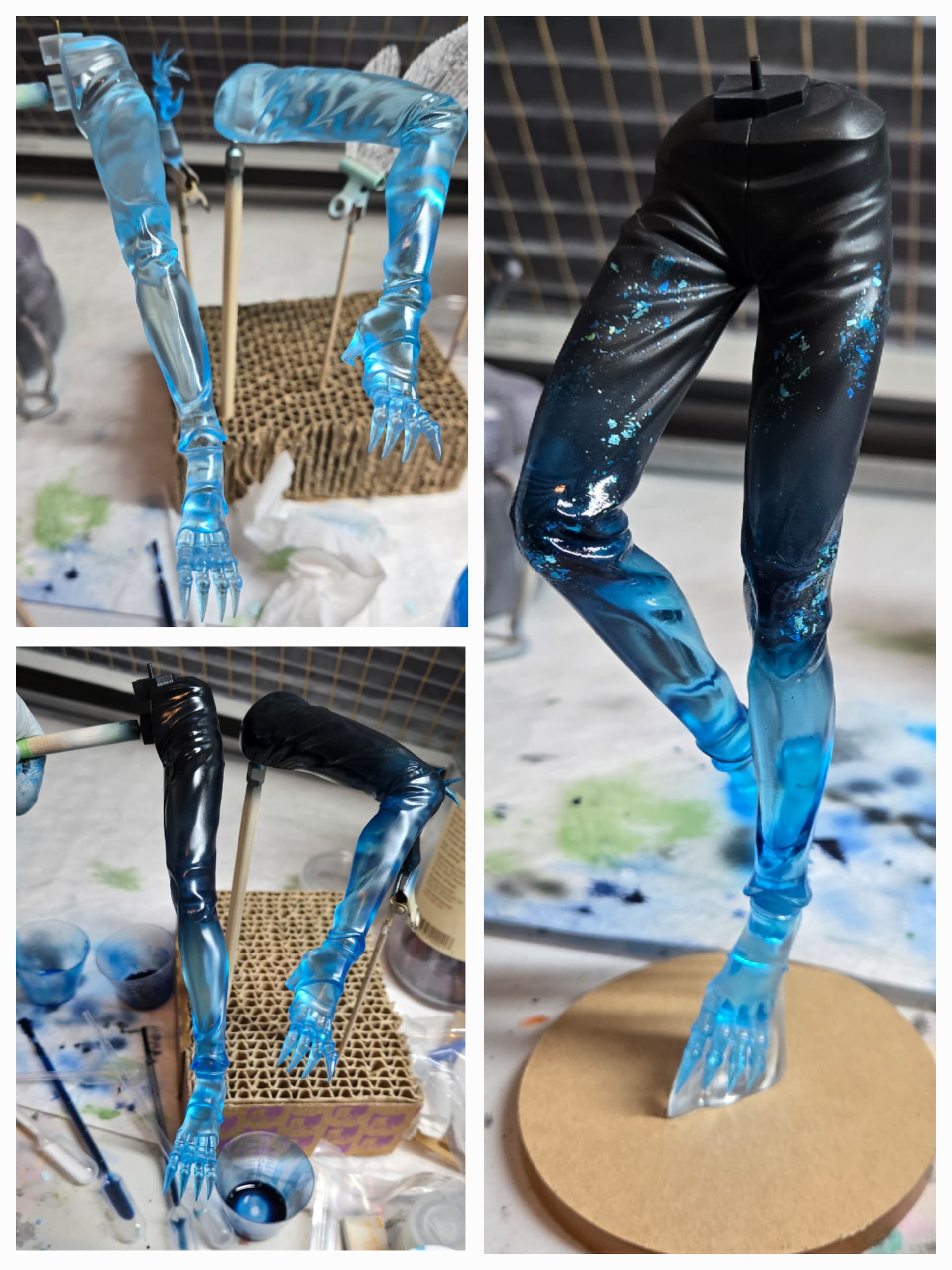

For the legs, I started painting using clear mixed with cyan. Gradually, I started using cyan+black to create a bluish black tone, with the very top the pants with just black. In the painted sample, they had a glitter effect, which was shared to be nail foils. To attach them, I used a brush with nail foils and stuck them onto the surfaces where I freshly sprayed clear lacquer. After all of it was done, I sprayed a thick coat of clear for the final coat and finished with Mr Color GX114 super smooth matte on the top portion.

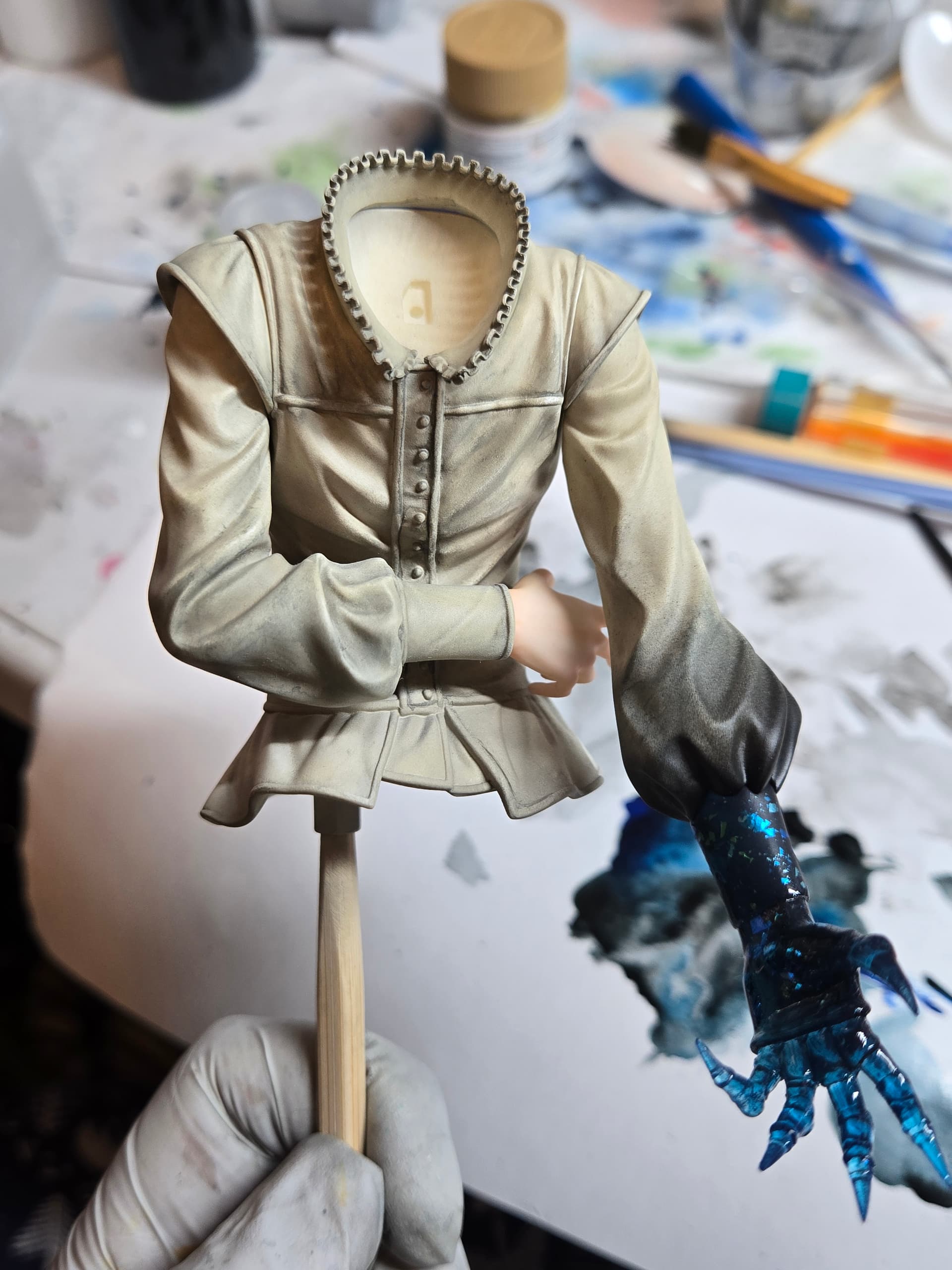

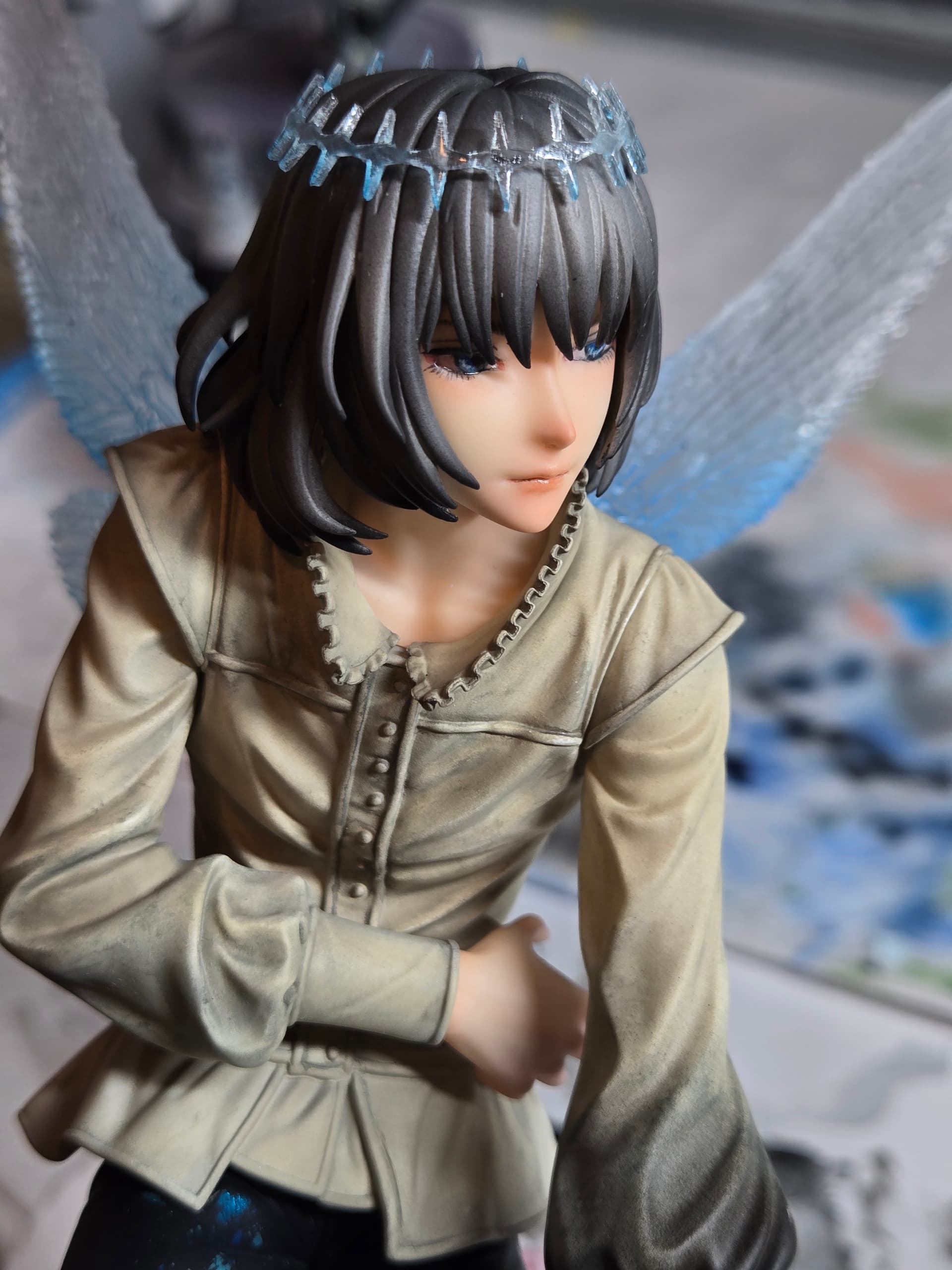

For his shirt, I started with a beige base mix consisting of sandy brown, white, and black. I later used enamel black and blue washes to weather. For Oberon’s left arm sleeve, I airbrushed a little bit of black on the very edges for a stronger gradient.

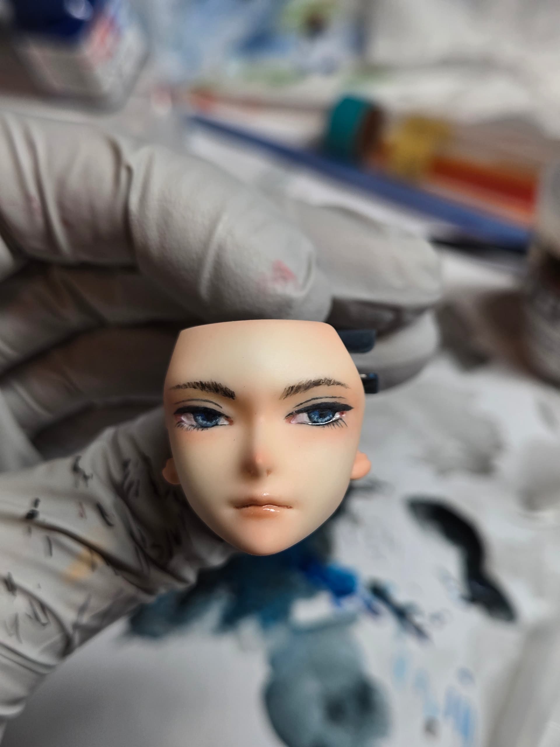

His face! I used ModelKasten C-12 Mucosal Clear for the skin and Tamiya enamels for the eyes. Pastels were also used for finishing touches and gloss was added to the lips and eye area.

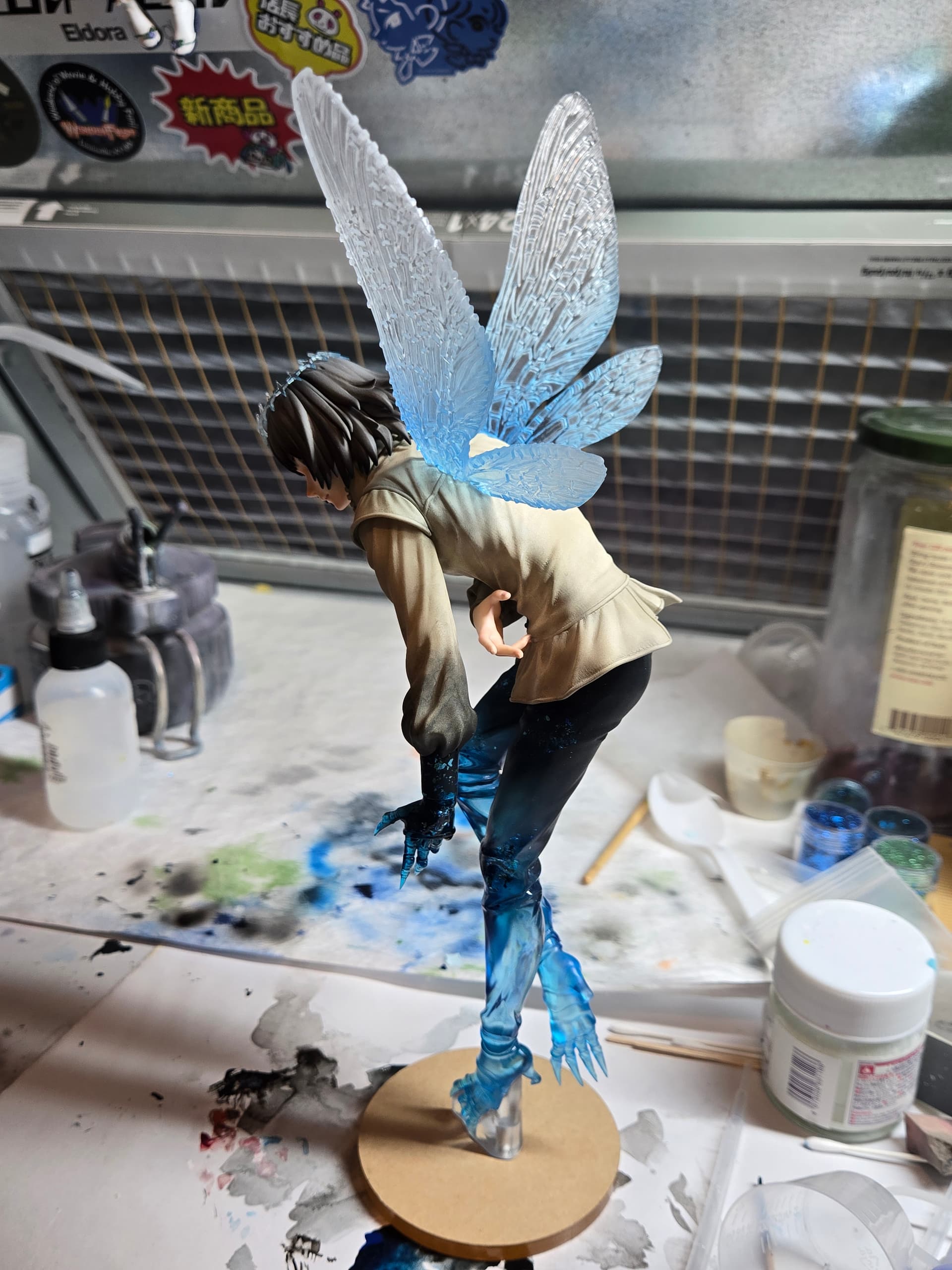

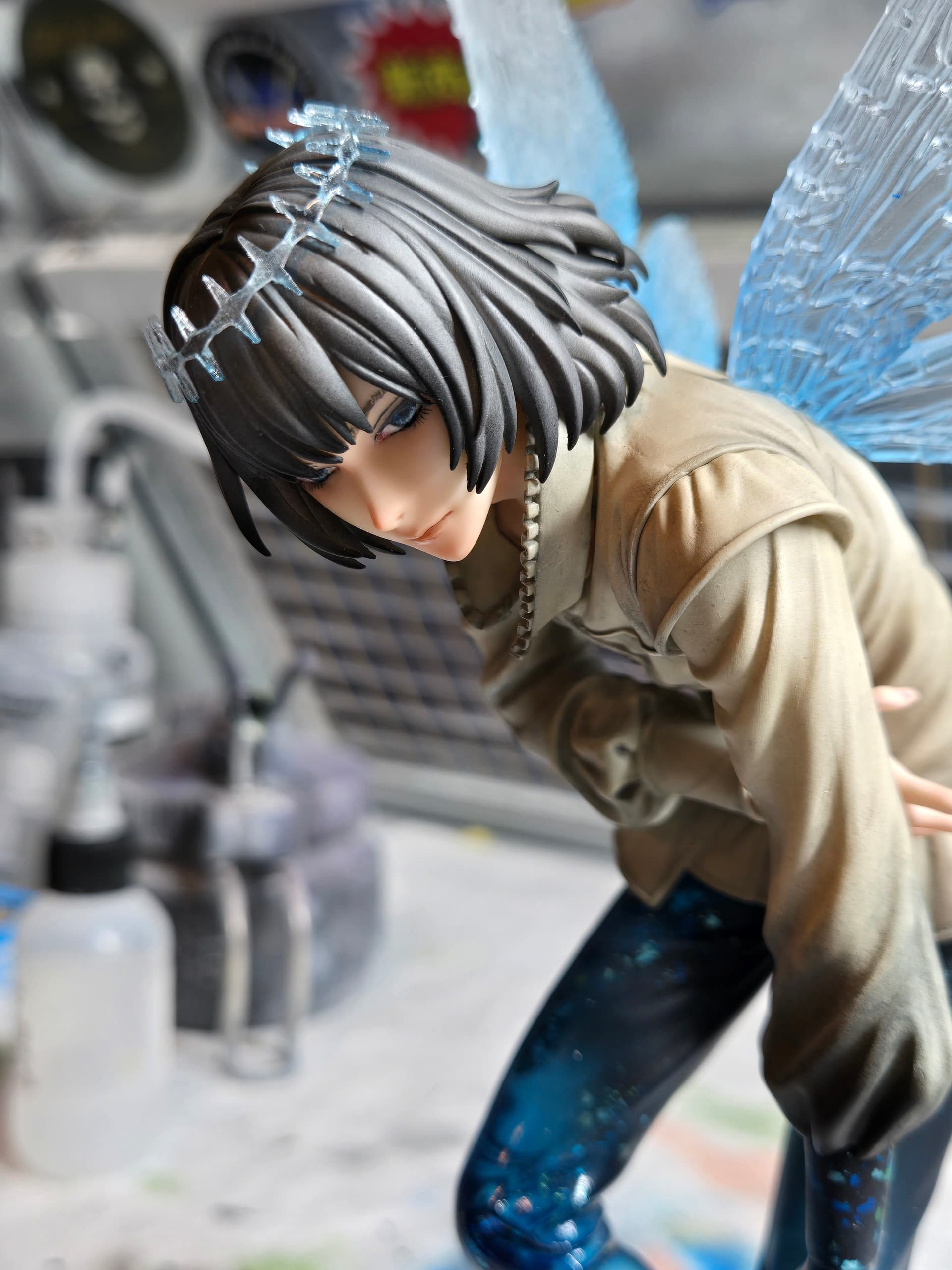

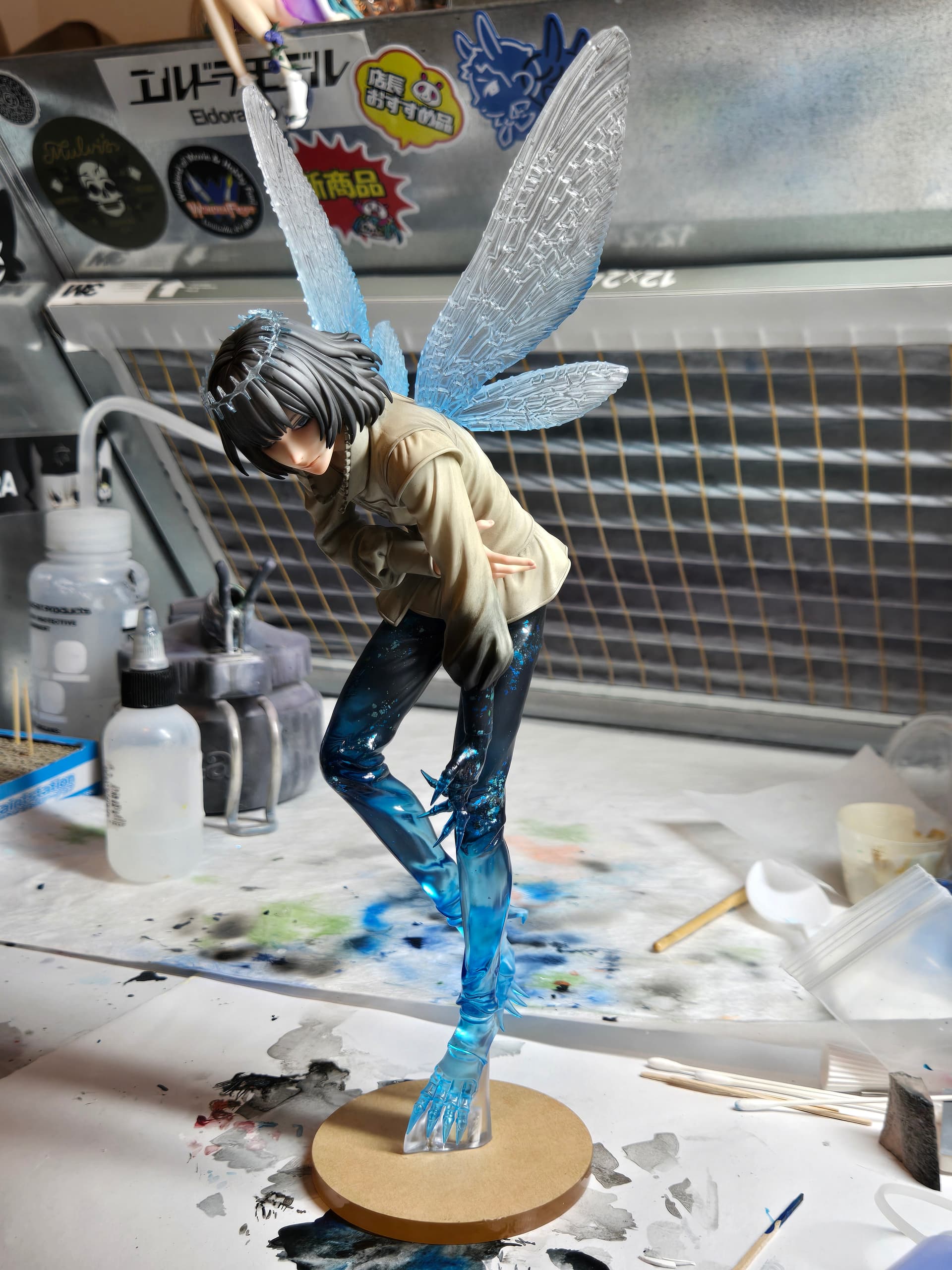

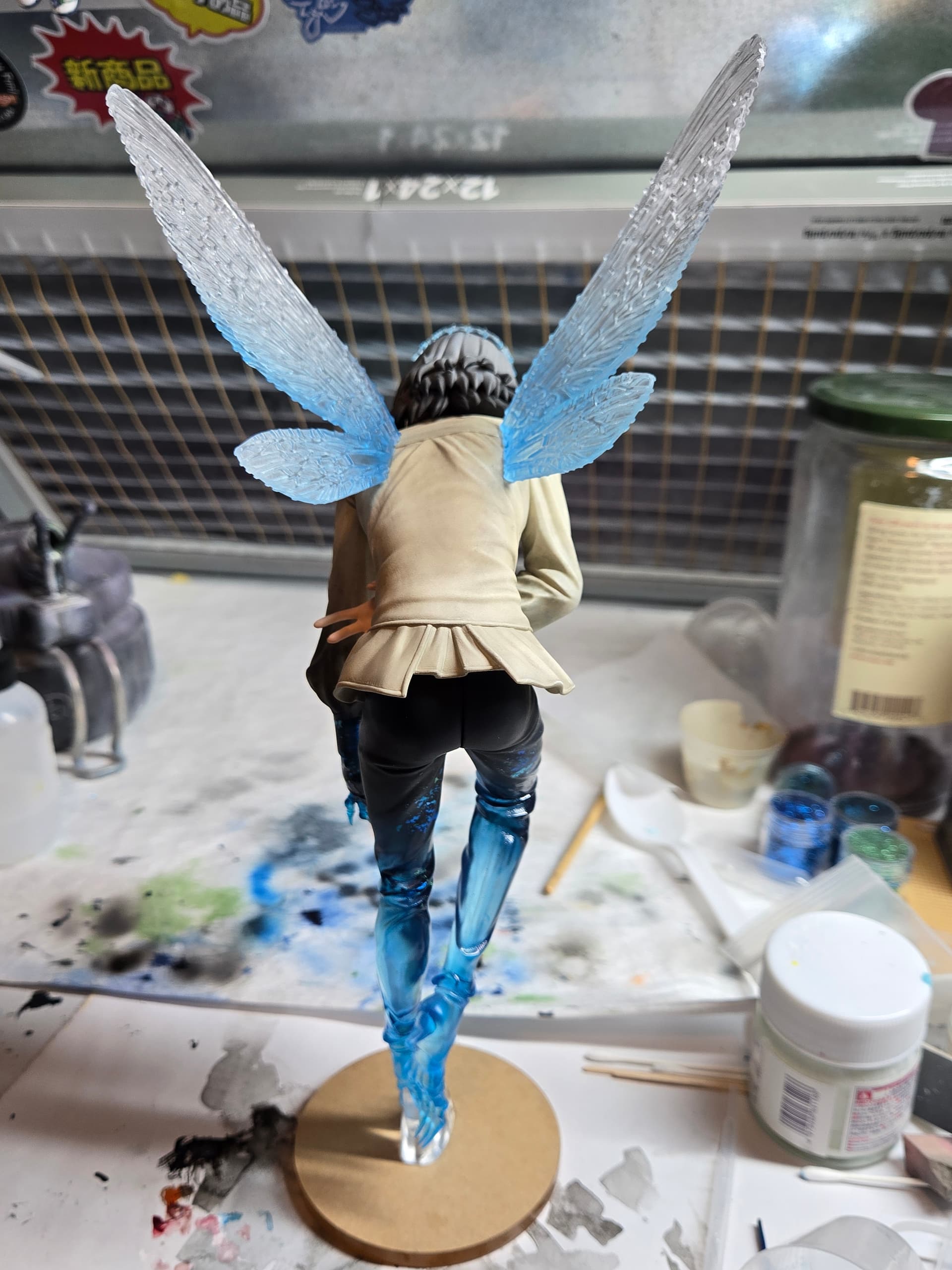

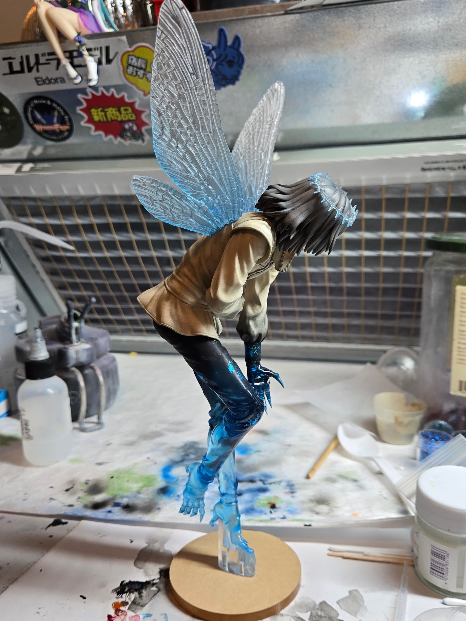

Finished Photos:
Overall, he was fun to build and I have another Oberon kit in my backlog which has his full insect-like coat. I don’t play or watch the Fate series, but he’s very popular among the female fanbase as the Fairy King :sparkles: Thanks for reading.
