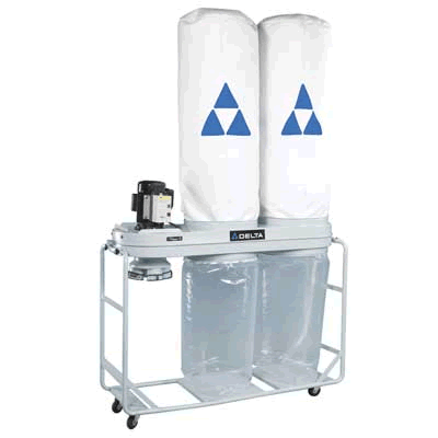

Because fans do a better job of sucking air, placing the fan as close to the exhaust end of the system the better. Fans loose their effeciency pushing air down/through a long tube. Hence the reason dust collection systems have the fan and motor as close to the collection resevoirs.
Like this industrial application:
Or this workshop one:
The added benefit is you can locate the fan away from your work area which means its quieter.
