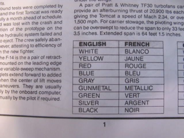

This is the colour key for my 1:72 Academy F-14A:
As you can see, it’s not very precise. For instance, the ejection seats are supposed to be “grey-green”
What are some colours and approximate locations for them on an F-14A? More or less I need a basic palette.
Any help you can give me would be greatly appreciated.
I know that the grey should be light gull grey.
