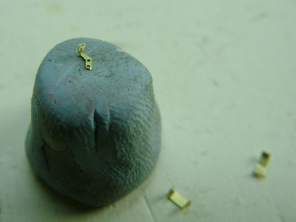

Hi all, ive meant to post this idea of mine for a while now. Having spoken too or corresponded with several modellers, who all say that they struggle with these things. Nows the time to make them easy for you.
Firstly, Get yourself a smallish lump of ‘Blutack’ im sure modelling clay would doo but Blutack is stickier. Make a small pedastal with it.
Collect your 3 parts to make the clamp. The back bit, (Thats glued to body) the clasp (The bit that goes round the tool) and the handle (errr…the handly bit?)
  1. Fold all the parts to there correct shape.

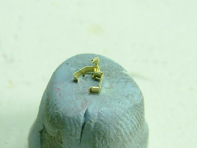

  2. Place the ‘Handle’ on its side on your Blutack pedastal, making sure that it is opened up wide enough to take the clasp and the Back bit.

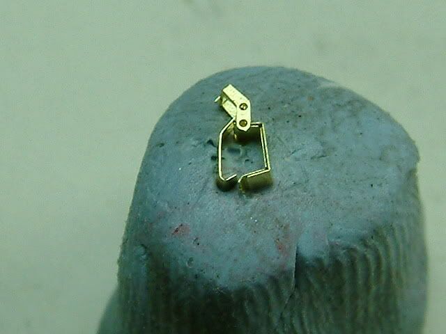

  1. Ensuring that you put it in the hole square to the handle, place both the Back bit and the clasp in the handle. Press down ever so slightly to make sure the blutack holds them in place.
  1. Next, using your optivisor if you need it. Push the end of the ‘Handle’ down in place. Even if it doesnt connect with both pieces 1st try everything should be held well enough to retry again and again.

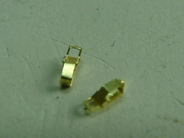

Voila! Simple. Heres a couple i made this lunchtime for my Famo in the Supply and support GB.

Ernest (Buffle) They take as long as it does to mold the Blutack, and fold the parts. The 1st one, i needed to adjust the clasp slightly but got it 2nd try. And the 2nd one went straight together. 5mins for the pair, Honestly.
