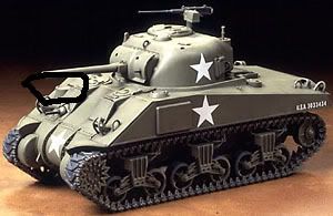

the area circled on the right front {co-driver gunner area} has a casting that looks like something should be there be is not. anybody have an Idea what that is for???
It’s the original spot for the wireless radio antenna. The tank was designed with the radio in the co-driver’s area and that was where the antenna mount was supposed to be located. The radio was eventually moved to the turret.
thanks, I thought it looked like an antenna location, so this is a REALLY early model[swg]
Actually, even the later hulls had a patch on the hull roof near the assistant gunner’s hatch for the option of mounting a 2nd antenna. It’s just that the original M4 Medium series had the 57 degree hulls which featured the antenna pot you’ve cited and two protruding hoods where the driver and asst driver had a pericope in front of them. Later, a 47 degree hull was produced which eliminated the antenna pot and the protruding hoods which were shot traps, after all. The 47 degree hull was one flat plate. Like I said earlier, the auxilliary location for the 2nd antenna was moved to the roof near the asst driver’s hatch.

Here’s an indispensible tweaks list for the 1/35 kit (isn’t the OP pictured one the 1/48 kit?)

the picture I posted is the 1/48
