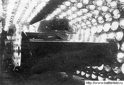

Most tanks were factory spray painted and baked (check out the freshly-painted Soviet T-60s being baked) and the process resulted in finish that had a bit of gloss to it. It was somewhere between semi-gloss and flat. You can imitate that by mixing one part semi-gloss varnish and one part flat varnish.
Many fine-pigment modern flat enamels and acrylics are just about right, but Humbrol matt enamels which have very coarse pigment are way too flat . Don’t use them unless the paint is supposed to represent heavy dust or sand weathering-see the SU-85 below.
