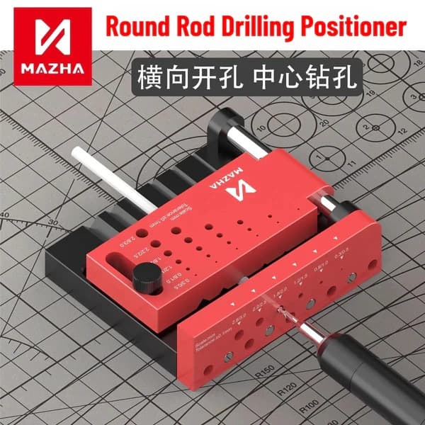

I did see a device that someone invented just for this purpose.

One of the problems with the Mazha jig is the Micro Drill bits that are advertised to be used with it, are simply too short.
The smallest opening is roughly 0.017" or a No. 78 Gage drill bit.
