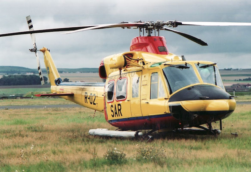

To carry this conversation one step further, I recently purchased one of the UH-1N Kits for eventual conversion into a Bell 412. I know that the 412 has a 4 blade main rotor vs. the two blade Huey. I have also heard discussion that the nose of the fuselage is incorrect, and needs fixing. Other than that, any other major differences? I am trying to decide whether to go with an additional kit for the two blades needed, as well as modified rotor system parts, etc., or the Cobra Company set. I haven’t compared the kit yet to the drawings that I got from the Bell site… Any ideas or suggestions would be appreciated. This will probably be a civilian fire service/ medical unit, or one recentlydelivered to the Delaware State Police. Thanks in advance.
David
David,
You have your work cut out for you making a 412 from a 212. The biggest problem is the rotors. It isn’t just two 212 rotors attached to the rotorhead, but 4 smaller blades with a totally different shape. Also, the transmission fairing is totally different. You are talking a pretty significant mod there. Check em out.
Ray

UH-1N (212)
Photobucket[/img][/img]
The 412 would be a major conversion. Aside from what Ray already said, the rotor head is totally different as well. There was a guy at Heli-Kit News, Michael Kren, who has done it many times with the Panda/Dragon 1/35 UH-1N though. He apparently made a resin copy of his conversion parts. Unfortunately, he is no longer active there and isn’t getting or answering emails. I have tried to contact him a few times to see if he wanted to sell a conversion kit, but have had no response.

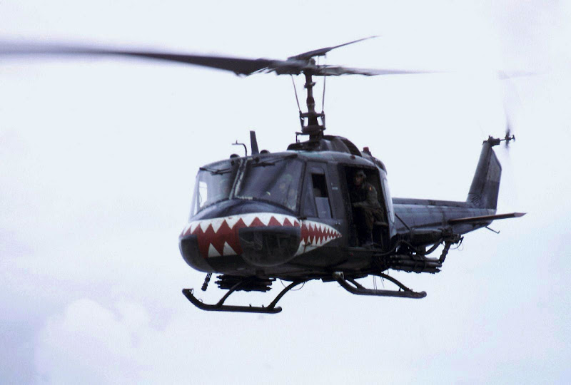

Well if you want to get technical, I’d opt for the UH-1C with an M-21 system (M134 minigun/M158 rocket pods) and a couple of free 60’s in the doors. Something like this baby right here:
[img]http://
From Drop Box
[/img]
I think Mel will back me up on my choice here. But I am a wee bit biased!
Ray
