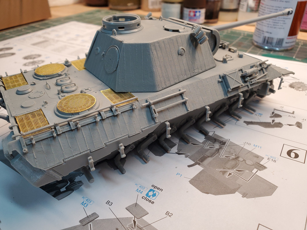

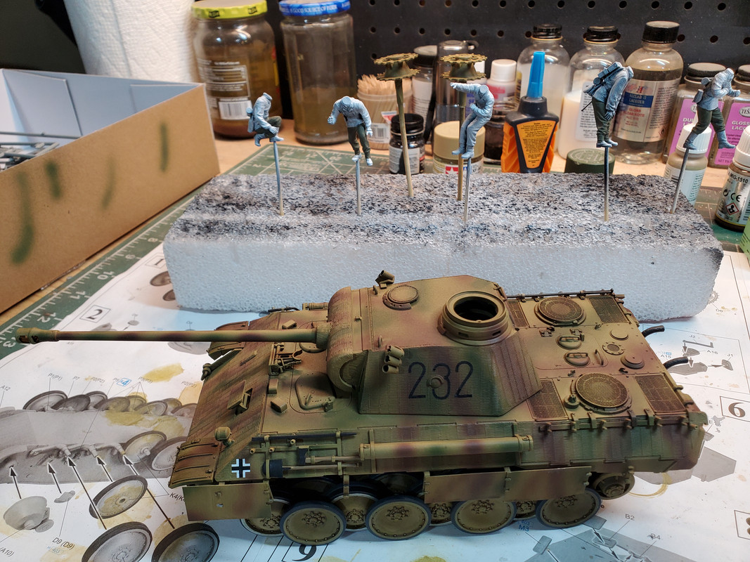

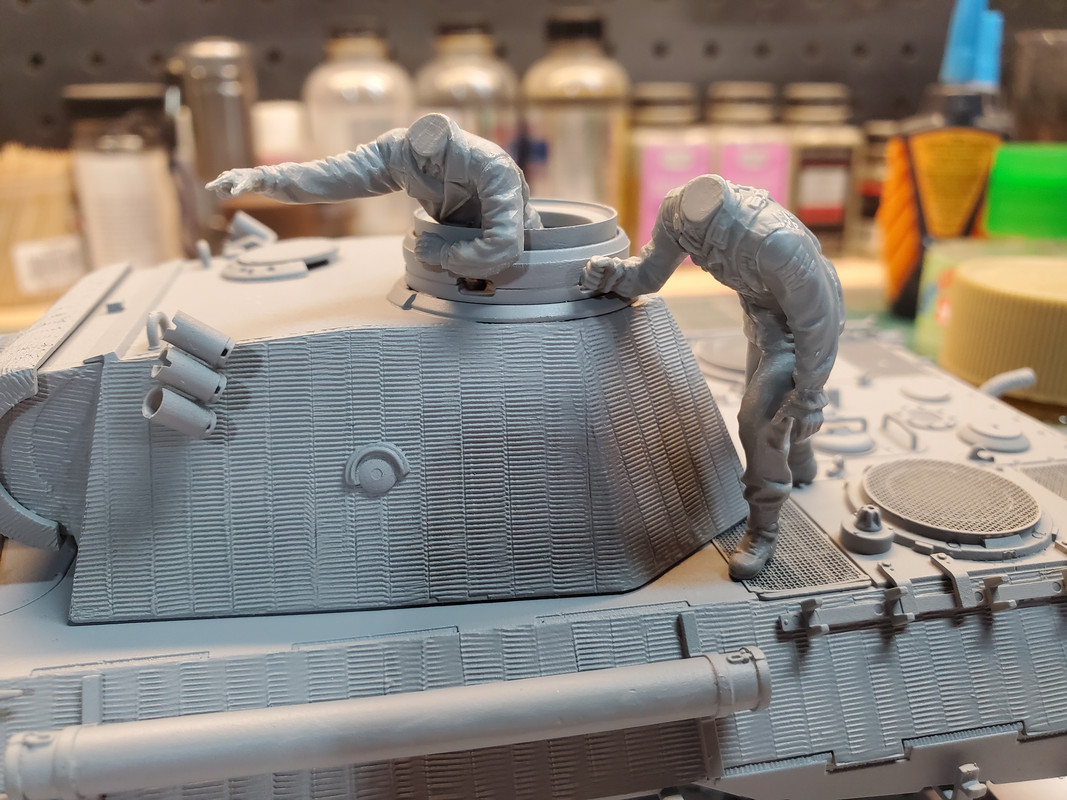

Last night I jumped ahead to the figures wanted to see how they fit on the tank I like it so far !!
Man, that looks super good. I really like those figures too. I have been eyeing them for awhile now and may have to pick them up.
BK
Yeah nice!!! Love the Panther and the figures!
Yes, I have to concur, those figures look good. They’re going to make an excellent addition to this model.

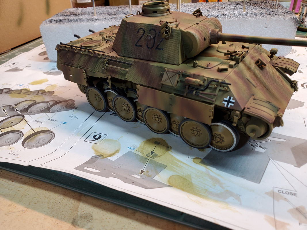

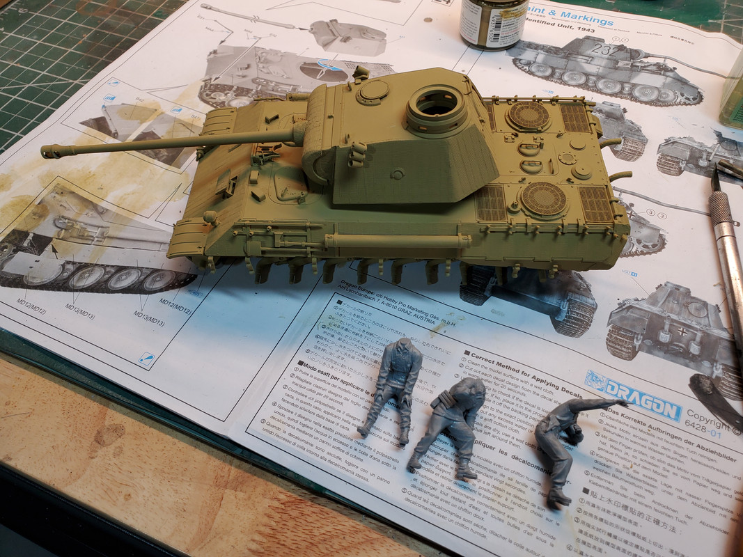

Thank all for following along and commenting.I didn’t do a lot this week,but I did lay down a basecoat of good old Tamiya XF-60, I also started on a 3rd figure.

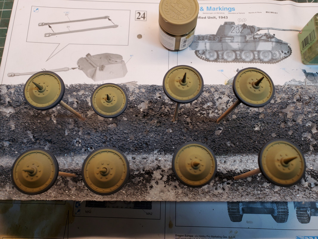

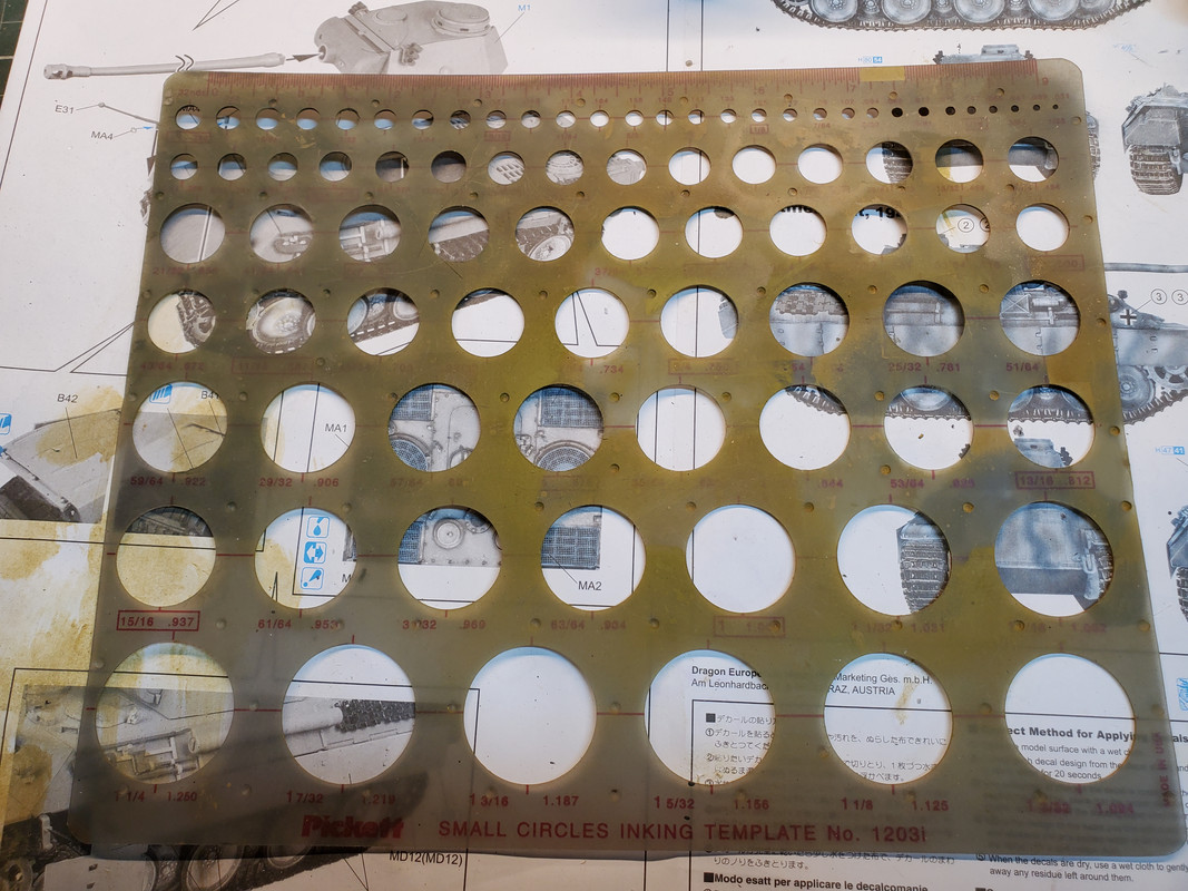

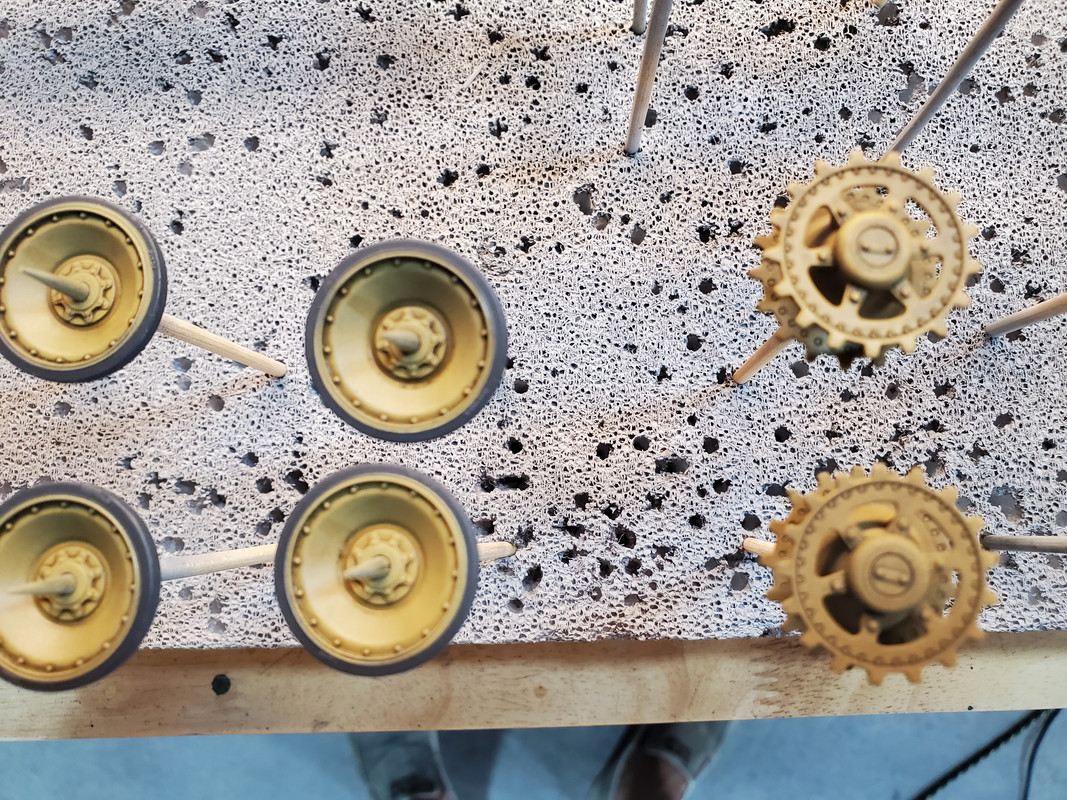

I also started on the inner set of roadwheels,it’s less daunting to do a set at a time,instead of all at once.I used my circle template to set the rubber edges.
Looks good!
Templates seem to be the easiest way to paint the road wheels I’ve found. Good idea!

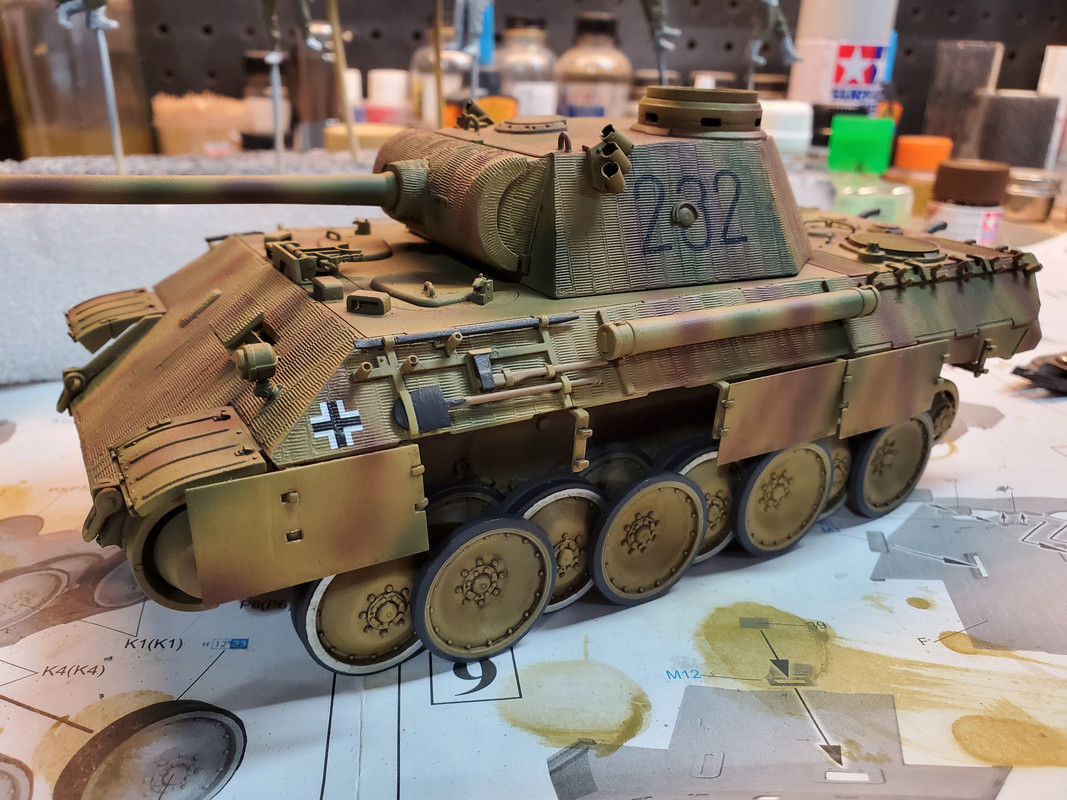

Small update,I got my roadwheels painted,filtered,and washed all 36 pieces, I’m pretty happy with the look,maybe some dried mud,I’m definitely keeping the overslept weathering light on this one.Well I can’t put it off anymore,gotta paint the dreaded camo pattern this week,for me always a little dicey trying to get the right look.

She’s coming along great there Tojo, nice to see the whole ‘road wheel garden’ as someone here once called it!
Well, very little masking unless you’re building something with a camo scheme, no (or few) clear parts, and you can just assemble the whole darn thing except the wheels and tracks and spray… I’d consider them easy or just low stress compared to other modeling…

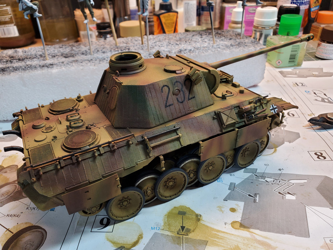

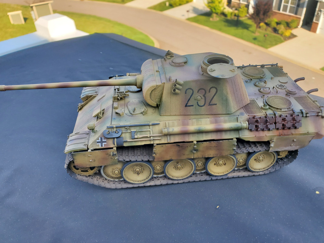

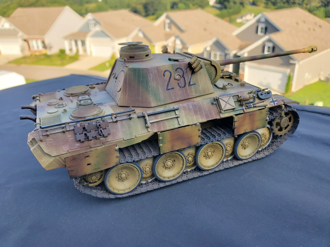

I got the camo done I filtered it and gave it a pin wash with Mig products,I intend to add some chipping and pigments.I ended up being happy with the camo although not my best.I also did a little painting on the figures

That looks really good, Tojo!
If you thats not your best camo, it’s still really well done!
The camo looks good to me! She’s coming along nicely! [Y]
Thank you Mike and Gamera for the comments.
Very sharp Tony. Great details and the camo looks fantastic. Always love your armor builds with the figures

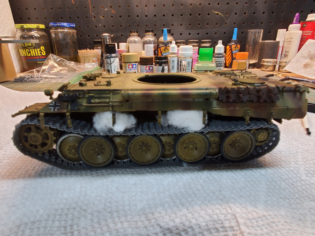

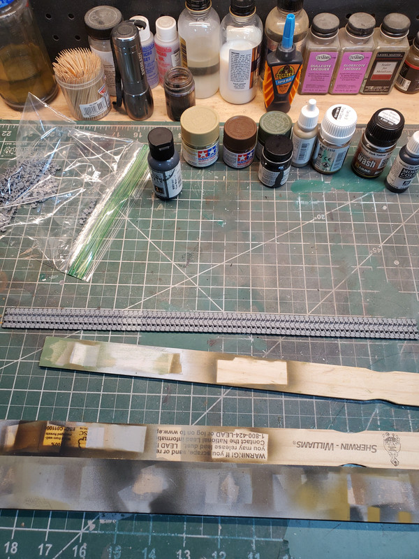

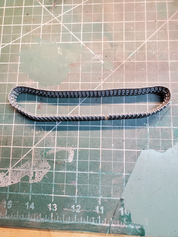

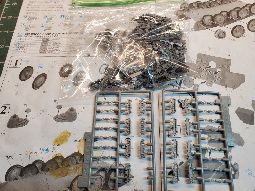

Here is my process for handling Dragon’s Magic Tracks,first I assemble the whole run at one time minus 1 or 2 links to allow some room,in this case the 87 links answer was spot on,then I apply Tamiya Extra Thin to the entire length and wait 25 minutes for it to partially dry.

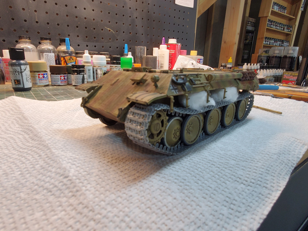

Then I flex the entire run around the road wheels and sprockets and mold in the appropriate sag and hold it in place with the cotton balls.
Once dry overnight I remove the entire run and paint it with my go to track base coat,Tamiya XF-84 Dark Iron,I will wash it and weather with pigments and return it to the tank for permanent installation.
The Panther is probably one of the easiest tanks to do this because of all the room,but the shurzen holders made it a little tight.

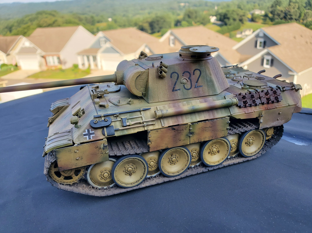

I attached the tracks and shurzen to the vehicle and added some chipping.Its just about done,just need to paint up and add my figures.Thanks for following along and the comments.
