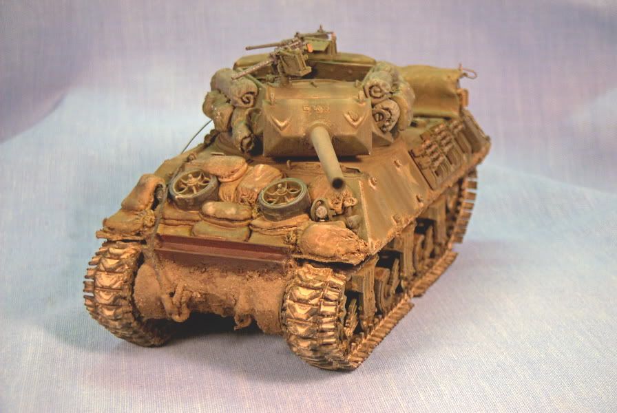

I also used the duckbill end connectors in my build. When dealing with these 3-part indies…patience is the key.
Here are the pics of my build just in case you want to check it out.
Nice dio Dwight. Those extensions really do add something to the tank.
