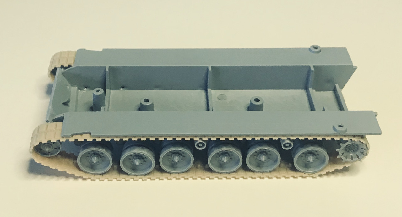

So basically this thing has about the same parts count as an early 70s 1/35 Tamiya kit like their M41 or T-34/76. But these parts are sure molded to modern detail standards. I see that 1/72 has come a long way since I last built one. But in typical Dragon fashion, the fit has some issues. I needed a few swipes on some of the road wheel holes with a needle file to make sure they would go on. These things fit tight! Anyways, in abou 20-25 minutes of snipping, sanding stick swipes, and gluing, I got the running gear on and Step 1 completed…
Step 2 tomorrow…

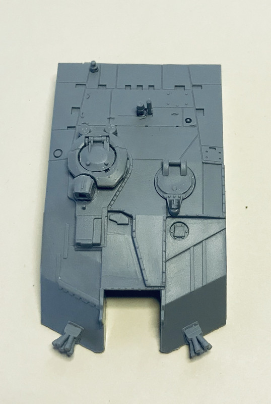

So today’s update was step 2, adding detail parts to the turret top and front. Test fitting, needle file swipes, fit and glue… lots of little things that I thankfully did not lose…

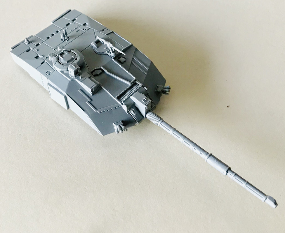

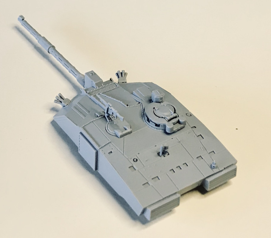

This afternoon, I finished up the turret. The fit of the turret floor to the top was not the best, and of course there was a major mold seam line on the main gun tube needing clean up… plus a few holes to be drilled for the CIP panels… this was a bit longer of a bench session.
Step 3 complete… next session, the upper hull.

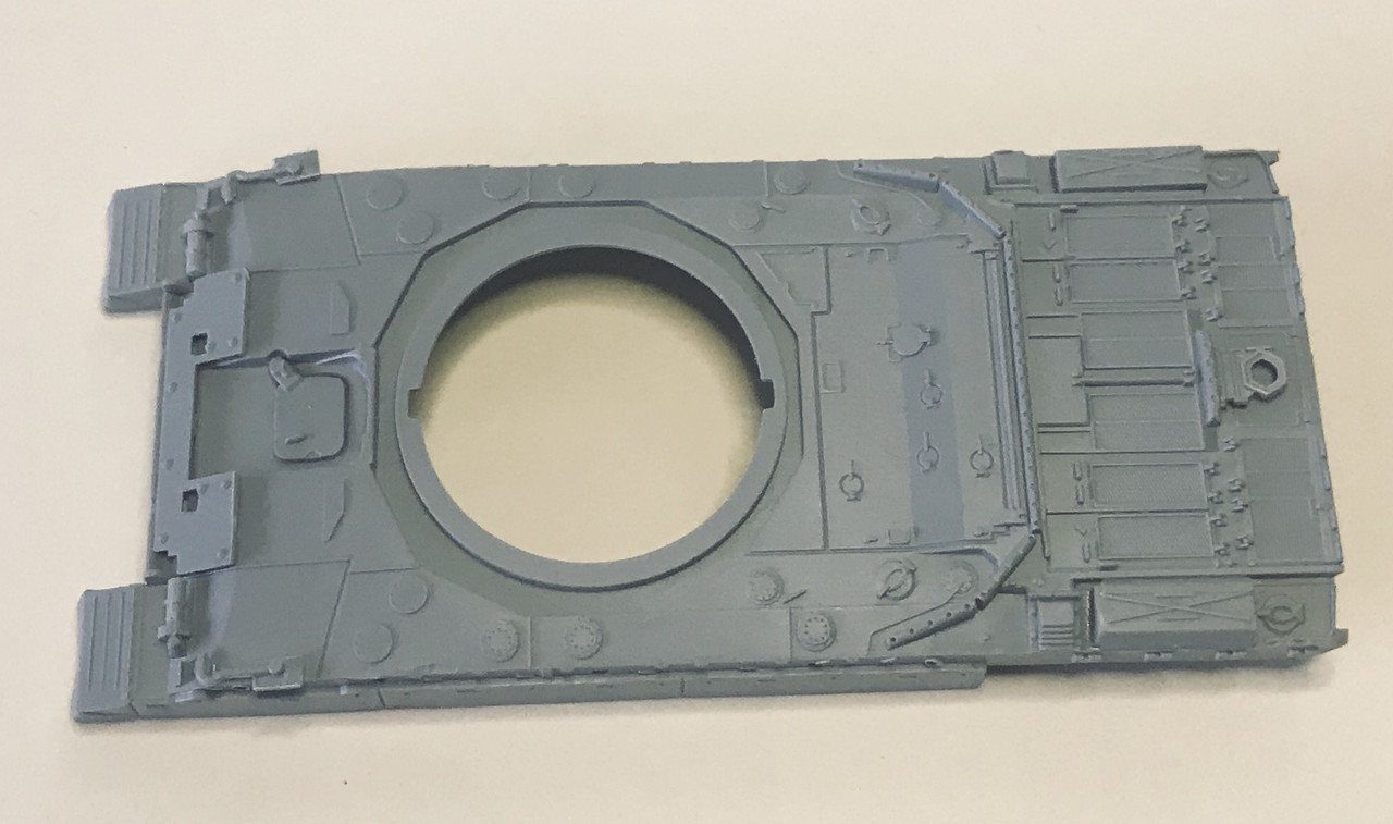

Today was a bit more progress. First up, Step 4, the upper hull detail parts. That went quick. The biggest speed bump was cleaning up the mold seam lines on rounded bits. They are more prominent than on any flat surfaces…
Then I deviated from the instructions. In the advice of Rob Gronovious, who has built this kit, I added the front plate and idler wheels so that I could add the tracks. The instructions have you add the tracks as one of the last steps. No thanks Dragon…
And tracks on! The DS plastic stretched a bit at the glue joint…
