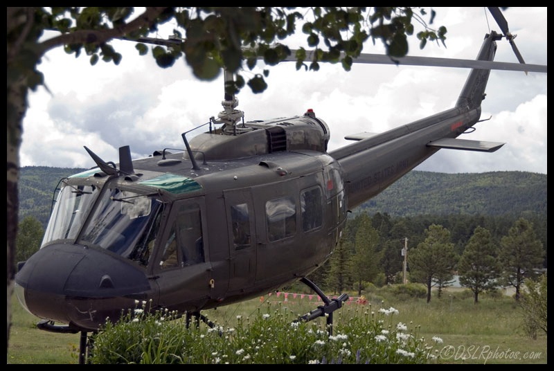

The outside pics look much better, good job. One other thing you might want to correct is the maintenance walkway area on the roof. Usually, there is a rectangle of anti-slip coated area in black on the roof. You can see it on the model as a cross-hatched area and on the below Hueys.
