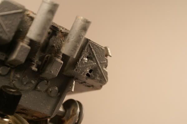

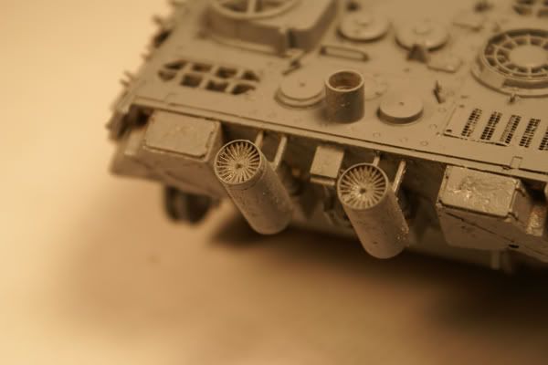

I used small drill, use sand paper just too hard for me, after that I used liquid cement to soften the thin part, and you can do what ever you want.
IMG]http://i134.photobucket.com/albums/q113/frengkly22/3.jpg[/IMG]
IMG]http://i134.photobucket.com/albums/q113/frengkly22/2.jpg[/IMG]
I used small drill, use sand paper just too hard for me, after that I used liquid cement to soften the thin part, and you can do what ever you want. Sorry about the panther’s gun, it is not the right one, since I broke it, so I change with Jagpanther one…
