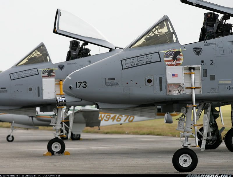

discolor a windshield. Basicly im trying to find an easy way to tint the windshield of the RM A-10 kit.
