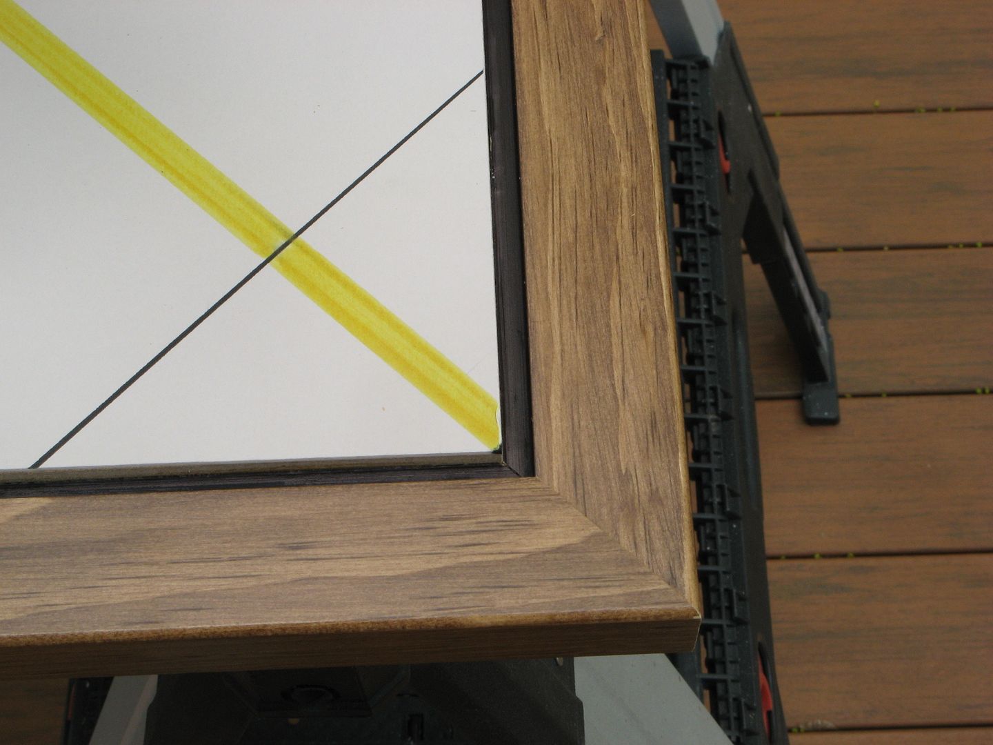

So I went out today and got a wood plank to use as a display base for my 1/350 carrier model. In the first picture below, does it matter whether the acrylic display case walls are on the inside or the outside? And how thick should the acrylic case walls be? 1/4" inch? 3/16" inch? More or less? I’ll be saving up money to get the acrylic case made by a plastics company near me.
Looks like it will be an impressive display when finished. I can’t really answer your questions, but I might be able to give you a couple things that may help your decision.
-As for the thickness, you might want to consider flex of the acrylic. The top being 16”x48” could create some sag with thinner material. The long sides may be affected to some degree as well, most likely by bowing or bulging outward at the bottom. There may also be an issue with bonding surface area using thinner sheets, the place where you get it built should be able to provide guidance on these issues.
-For the base design, in my opinion it would be an aesthetic choice, what looks better. However, if you go with option 2 that would prevent outward bowing of the longer sides. It would also leave a cleaner appearance inside the case, especially considering how you want to display the aircraft examples near the front of the base.
This is what I do for my builds that get an acrylic cover. I’ll add a molding to the base edges with a dado that’s @ 1/32" wider than the thickness of the acrylic I’m using x 1/4" deep. The molding is glued and clamped so no fasteners interfere with my dado. The molding also hides the edge of your base and gives things a finished look.
As for the acrylic cover, your pieces are fairly big so, like Frozin said, the sides should be 3/16" thick with the top being 1/4" so you don’t have any sag in the top.
