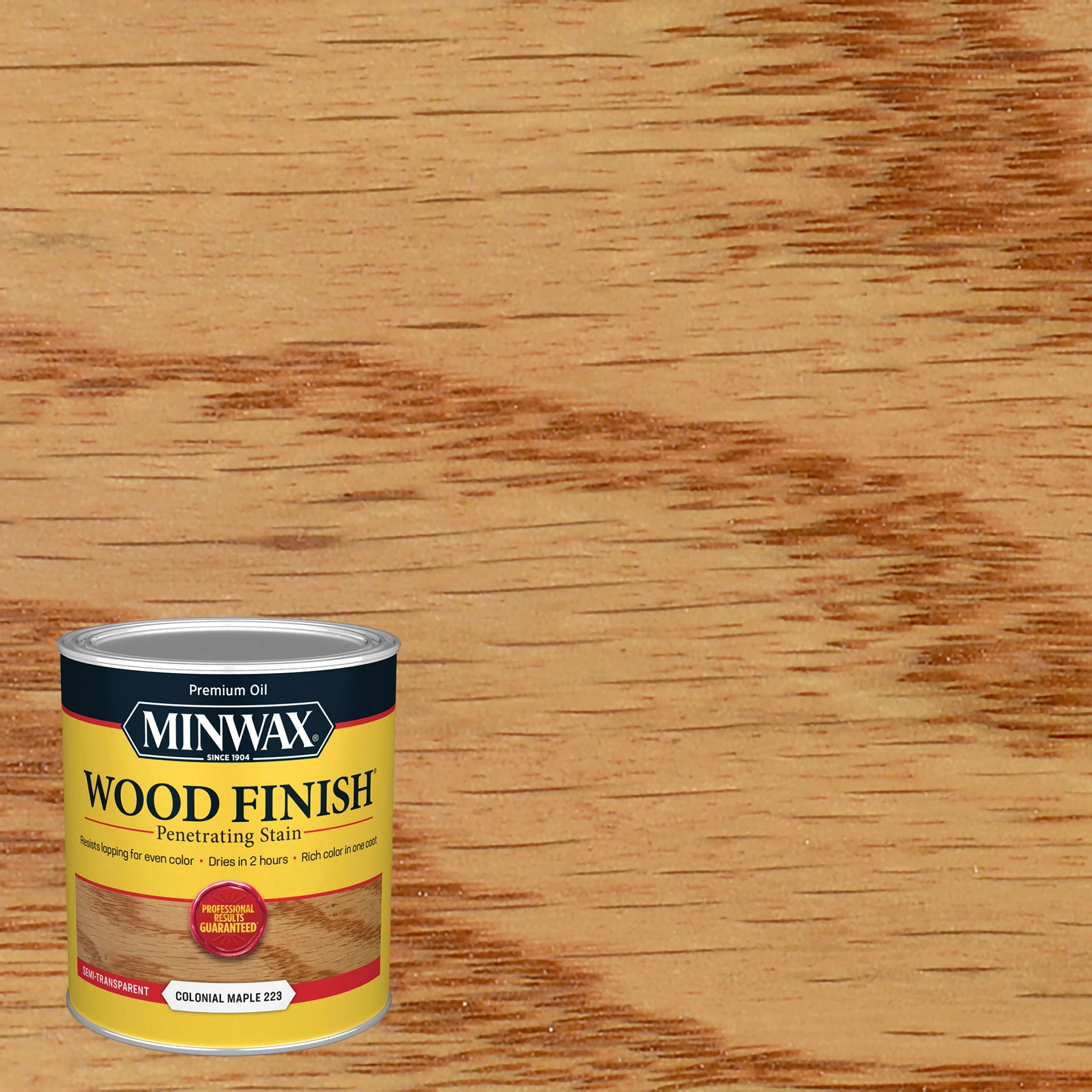

I looked at Minwax’s website to see what they say it should look like.
It tends toward a yellow orange hue. If you don’t want to sand it down and start over, you’ll need to get something much darker and stain over the top. I’d recommend getting a piece of scrap material that is the same wood you’re using for the base. You can then stain it with the colonial maple and test other colors over it until you find the color you like. I’m not sure if you can get these for minwax but some brands have sample sized containers for a buck or two.
