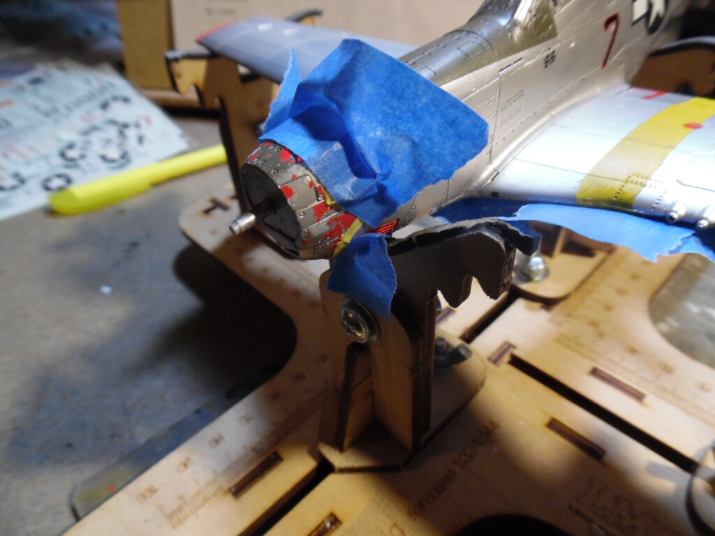

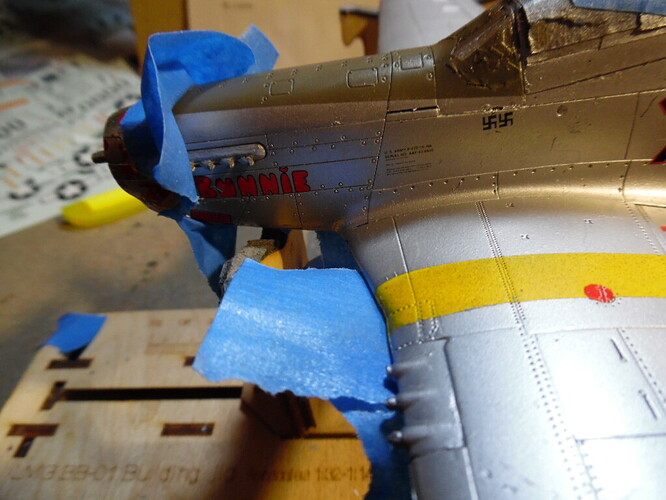

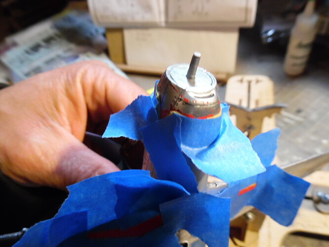

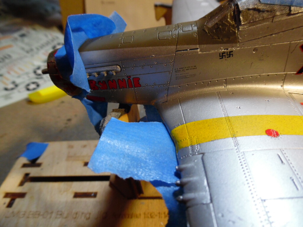

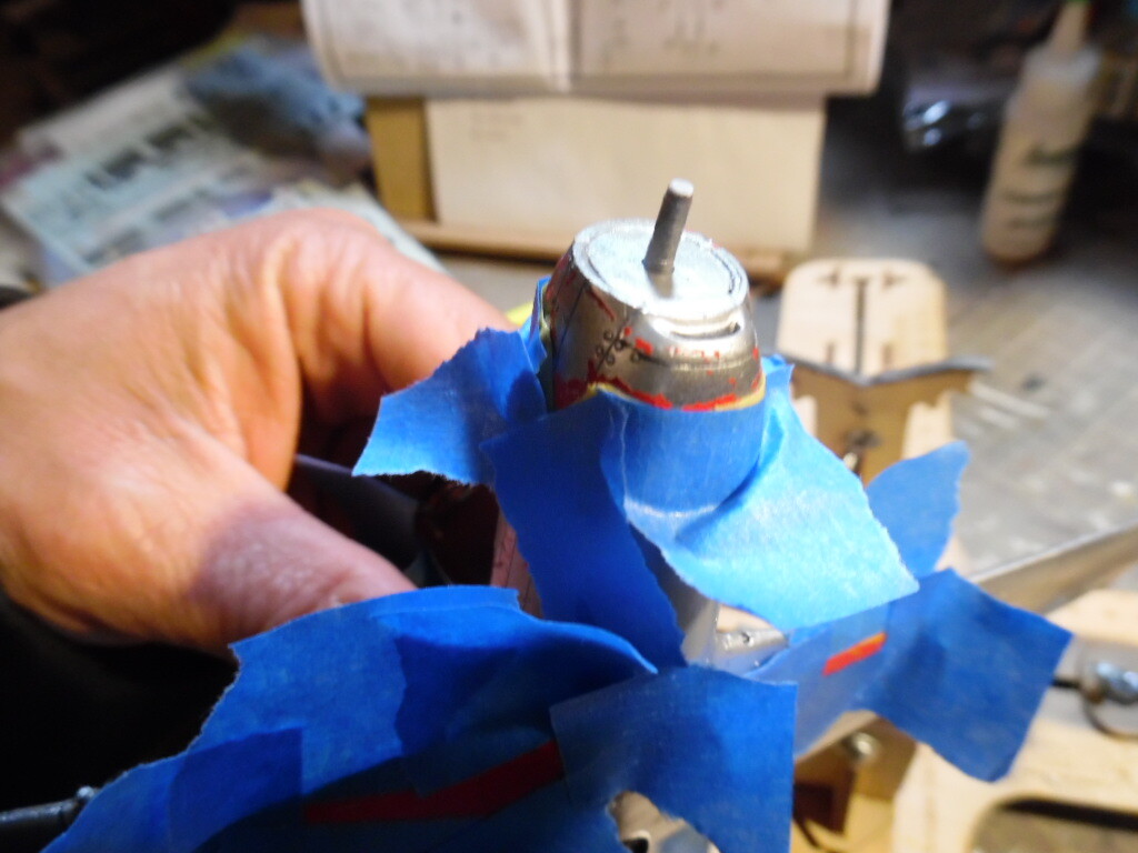

Quick update, I was able to use tape to pull most of the old decal off rom the nose after I taped out the shape in preparation for painting. As always, a small section pulled from the BUNNIE name section, but that was too be expected. :roll_eyes:
Here is the prep for area for where I removed the decals (with blue painters tape). Thanks everyone for the help. The area is masked so I will be painting and hoping for the best.
This is the current state of the build after fixing the location where the decals were an issue. Thank you all for the help and suggestions.
