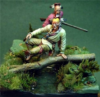

Avoid the problem to begin with. If there’s going to be stress on the joint, drill a hole in the torso and in the arm and use a matching piece of wire to lock it in place. I’m doing some preliminary work on the front figure in the Michale Roberts picture below and did just that. There’s also a brass rod running thriugh his hand/wrist and up his tibia/fibia abouuuuut half way to the elbow, since this is where all the weight will be on this arm.
