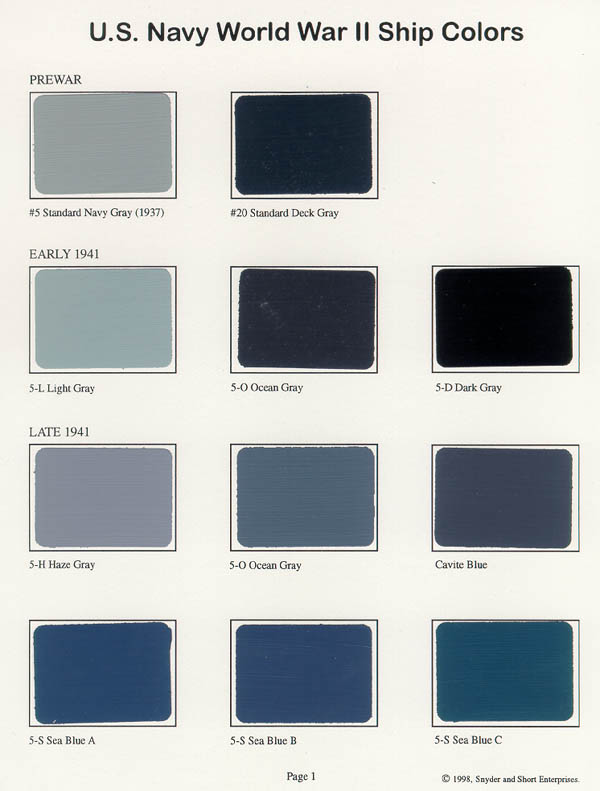

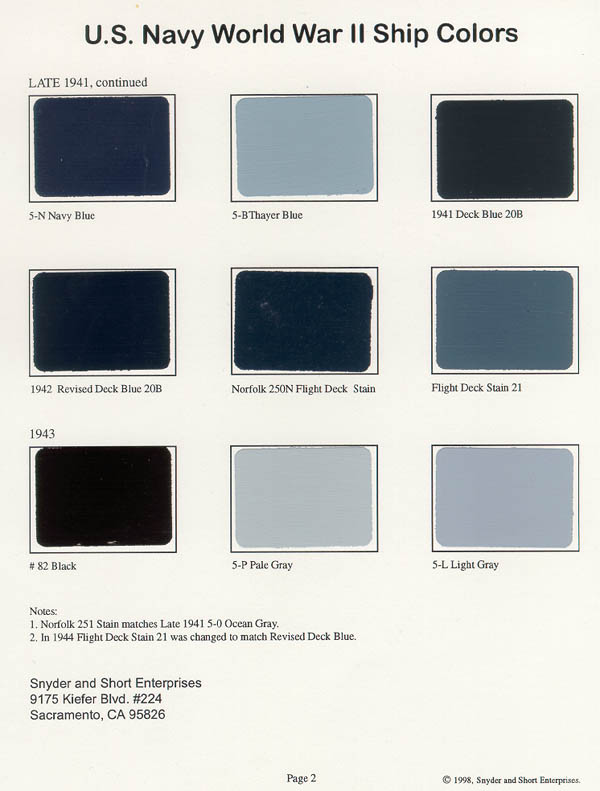

I saved these two pics (below) from the Shipcamouflage.com website long ago.

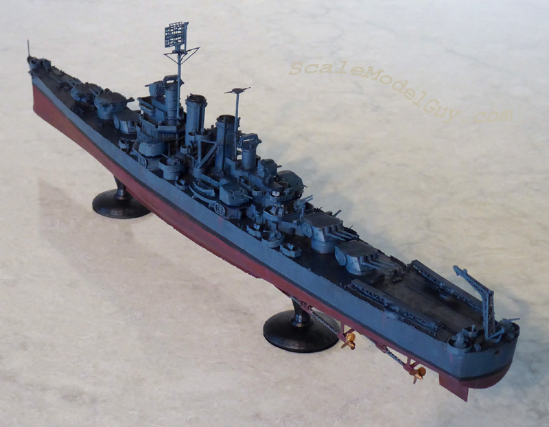

On my USS Helena CL-50, I used the following colors from @WhatIfRebel’s charts:

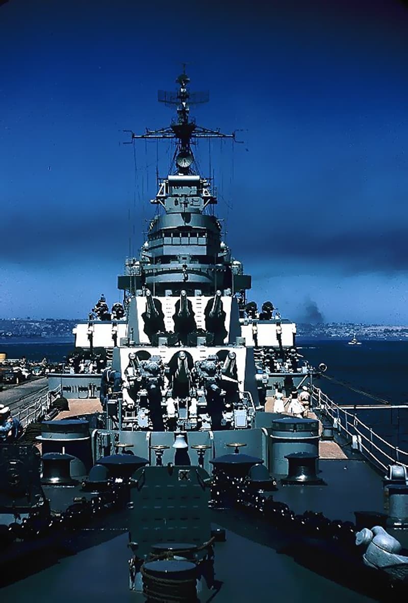

I was basing the choice on what I had read and primarily this picture:
(which, I believe is of the heavy cruiser.)
I liked the dark look in that photo.
My Helena ended up looking like:
I tried to do a light dry brushing/weathering but thought it lightened things up too much. There is just a hint of it remaining above the waterline but by in large I chickened out.
I do like the combo in hand but it is very dark and doesn’t photo very well.

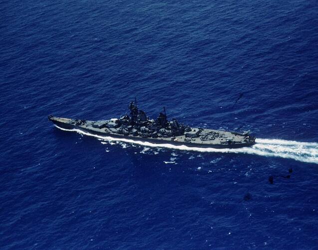

USS England was is Measure 21, as was USS New Jersey in this photo. The Deck Blue looks to weather to a more grayed out darker shade here
