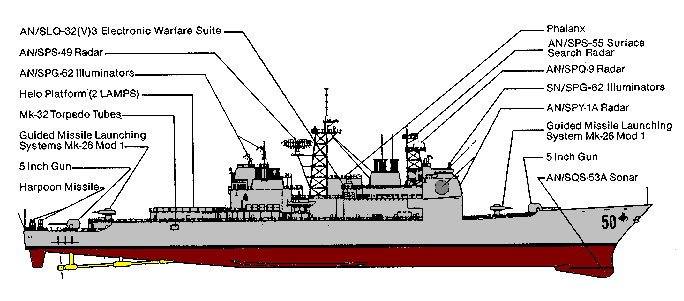

The problem is the twin missile launchers fore and aft. The Ticonderoga,and the other first 5 ships of the class had MK26 twin launchers in these positions
Globalsecurity.org
The remaining ships in the class have Vertical Launch System (VLS)cells fore and aft. There are also some antenna and mast differnces.
Globalsecurity.org
The early ships in the class are being retired early due to maintenance issues with the MK26 and commonality with other VLS platforms (i.e. the Burkes).
To convert a Ticonderoga kit to a model of Gettysburg will require that a suitable donor for the VLS cells be obtained (i.e. a later flight Ticonderoga). You can finesse the mast & antennas.
