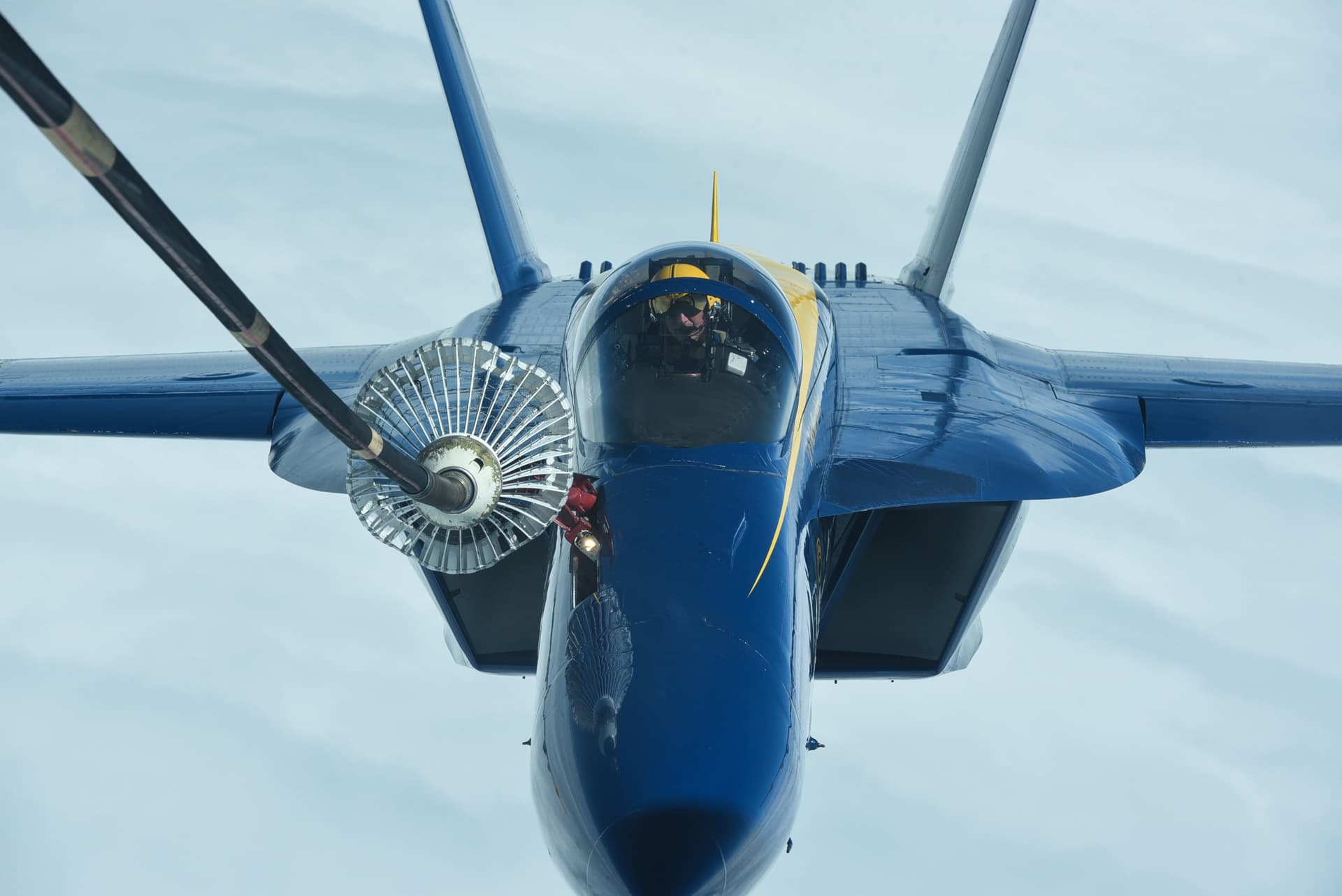

The only modification that the Blues do to their Super Hornets are to put in a plug on the gun port and adjacent gas vents. Otherwise the aircraft are the same. The airframes are supposed to be able to be reconfigured into fully combat capable mode within a 24 hour timespan if needed.

It looks smooth and shiny where the gun and gas ports are sealed up
Appreciate that photo so much. I was wondering how that looked!!
